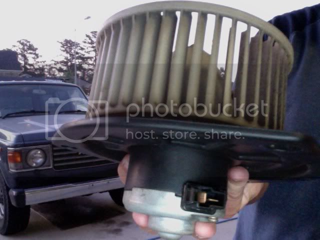

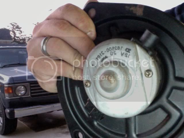

Is this right? No blower power on any of the ac speeds.
Also what are the "brushings," and the resistors your talking about. Sorry for dumb questions. I know I now need to test to make sure electrical is running to the blower (need to get buy a tester tomorrow). If electricity is running to the unit can I safely assume that I just need to replace the blower, also assuming this is the right part I just pulled out :)

Yep - you've got it. Get a test light or VOM meter and see if you get power to the female plug. If you have voltage the problem is the motor. If you look into the plenum that the blower came out of you'll see three wound wires that are the the resistors that vary the voltage to the blower providing the 3 speeds.
To disassemble the motor start with the screws on the black and go from there - you might have to remove the plastic impeller to break the motor down fully. just be careful. Taking photo after every step will help with the re-assembly
