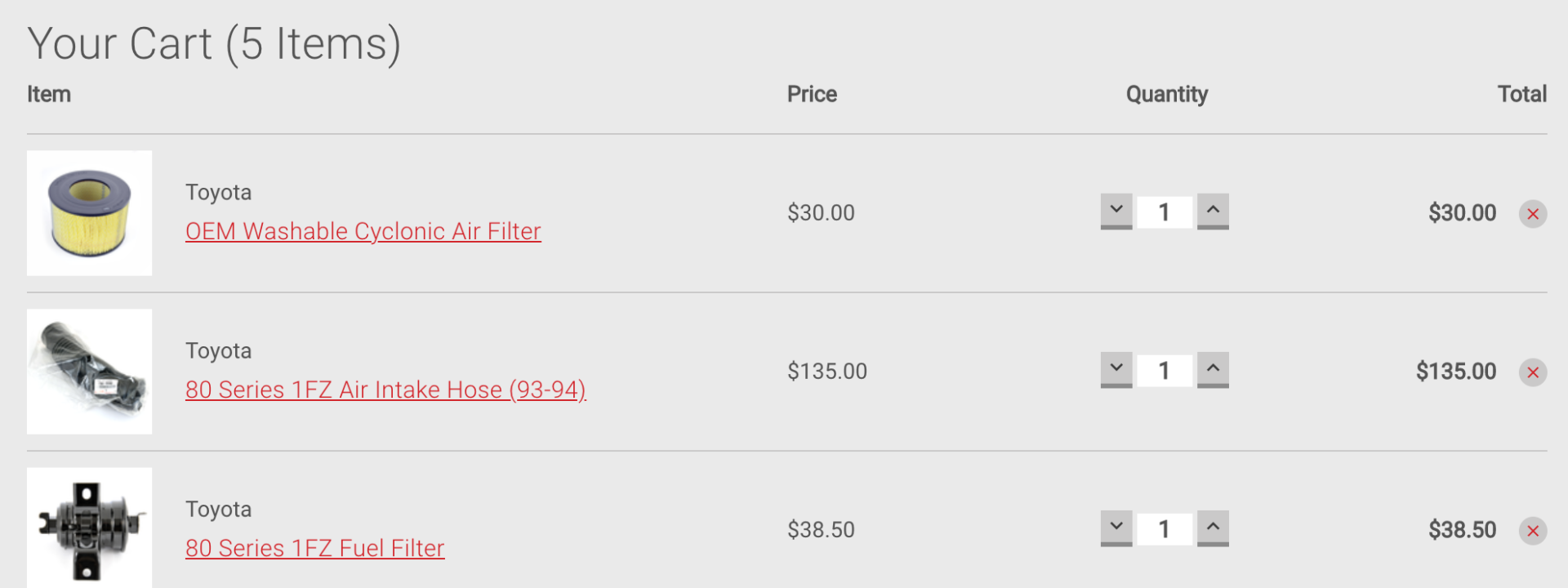

Do you think replacing these items would be a good place to start?
The first rule of ih8mud is to diagnose the problem, not throw parts at her. That being said, all those items are relatively easy to replace. The fuel filter is tricky without the right extensions.

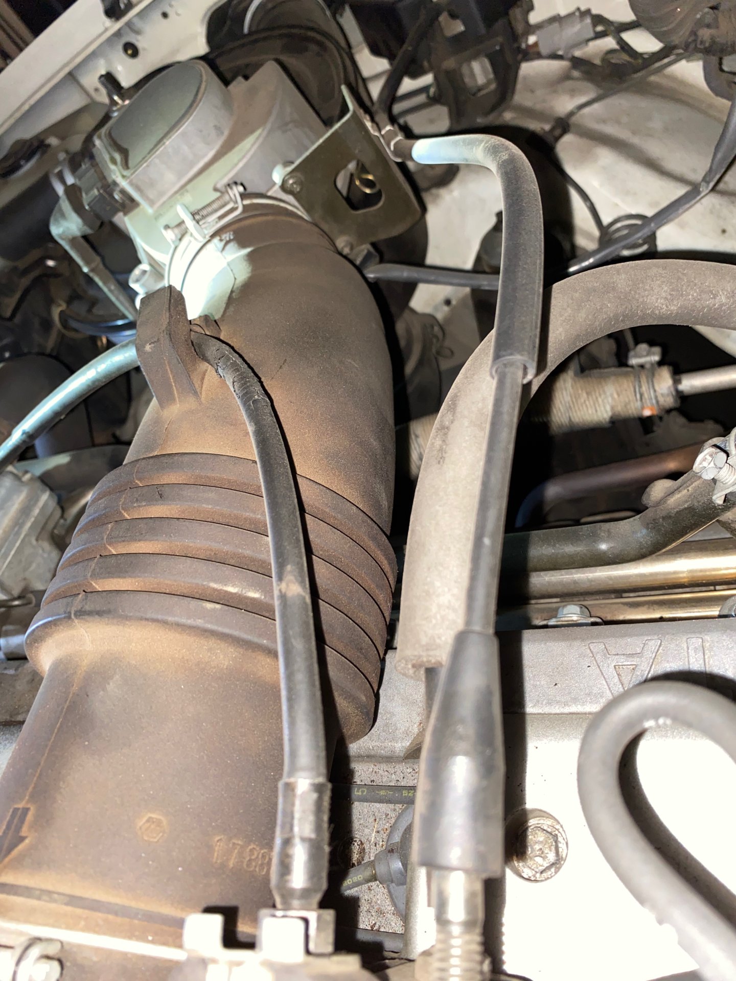

Makes sense... Right! I just figured that replacing these items could likely solve the issue. And I assumed that these items weren't too difficult to replace. And a plus would be getting to replace the old (and likely original) parts. Here's some pictures. I visually inspected the air intake hose and didn't see any cracks or breakage...
By virtue of age, a new intake pipe would be a good buy. -But for diagnosis purposes, you could Gorrilla tape any leaks you find - the bellows over the valve cover & underside are where they like to crack.
If you don’t know the history or have never changed the fuel filter, smart money starts there.
I’d leave the air filter for last - even a dirty one the air is metered after it in the AFM - so really dump the tuna can, change the fuel filter, really pull & examine the intake pipe as leaks there are unmetered air / screws the A-F ratio - but yeah, yours is old but can be made functional until the wallet rebounds & esp w/ Holidays looming….

-Or while waiting for a fuel filter to show, check the intake tube & just make sure it‘s functionally sound.
A quick / easy intake tube test is to slightly shift it while idle - if you can really screw up the idle, go get the Gorrilla tape ;)
