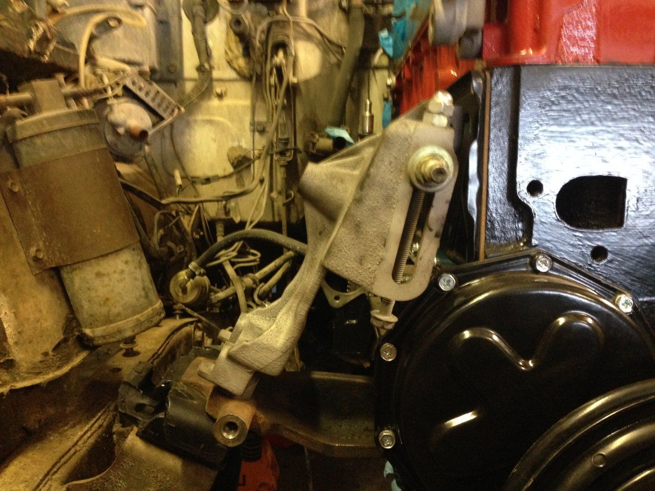

The idler is bolted to the front hole of the engine mount and then the bracket bolts up in two places to the underside of the water pump.
Ha, I bet your Dad at least thought about it!
See the bolt holes in the motor mount here?
Bolts go through the feet, for lack of better, here, into those holes in first pic.
It's the base of the mount is botched around the actually bolt through the motor mount.
Dunno what the threaded end of the motor are for...
Thanks for putting up those pictures. It looks like I do indeed have the 3FE engine mount on the passenger side, so if I can get an AC compressor bracket, I'll try to get it bolted up!
It looks like the AC bracket is going to sit right on top of the lower radiator hose. Things are going to get tight in there w/ an AC compressor mounted.

Not sure how to address, best, but thinking it'd probably be better to fab a new lower bracket, altogether, rather than space at the bottom.
Takers?
The distance the 2F is taller than the three. Compressor mount has to attach at the lower locations on the power steering pump bracket.
Can see how the lower legs attach to the motor mount here.
How far they're off and the real challenge if spacing.
Think I'd lose a fair entry if a solid block could be machined to bolt through the bottom of the motor mount, beveled for the differences in the surfaces, with threaded points to bolt the bracket to?
Other idears?
I'd like to stretch it to fit, but didn't think that's gonna work.
Christa Lancy (sorry, that story was too funny), is that tensioner for a pulley that is not attached to the bracket in the picture?
I am trying to get me a bracket, but it looks different.
Does the AC run a different belt than the PS?
