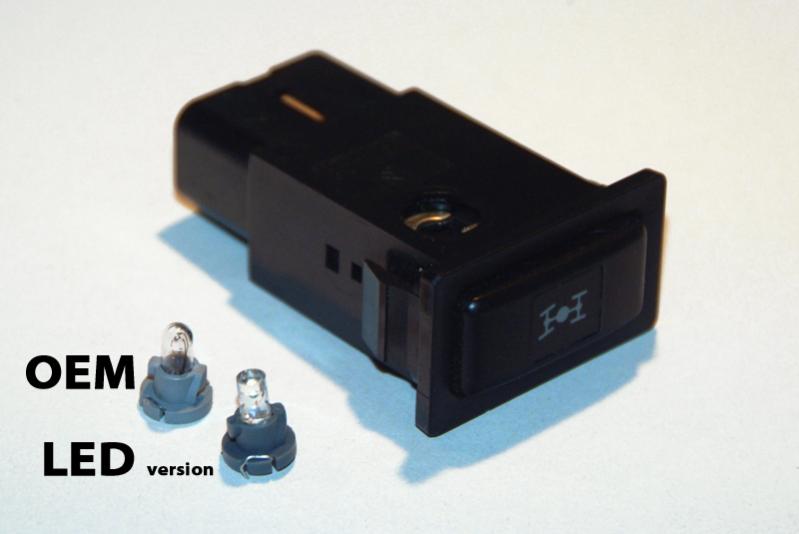

Center Diff Lock is a Type B - white in the stock configuration.

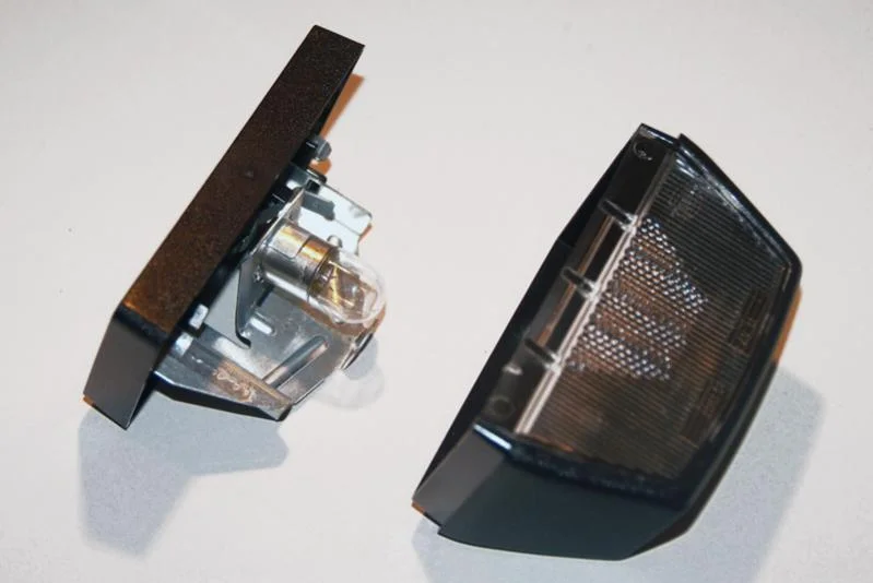

Slee's rear license plate light is a 5007 ba15s (single contact).

Slee Rear Bumper License Light
(1)Ba15s--------------------------------------------------------autolumination - Cool White - G18 Small Head - 15Led Matrix
$9.99

Everything works better than stock except for the Type A and B bulbs for the dash switches. The light is pointed downward and the label is forward so the light output isn't that bright at night but you can still see the buttons.
