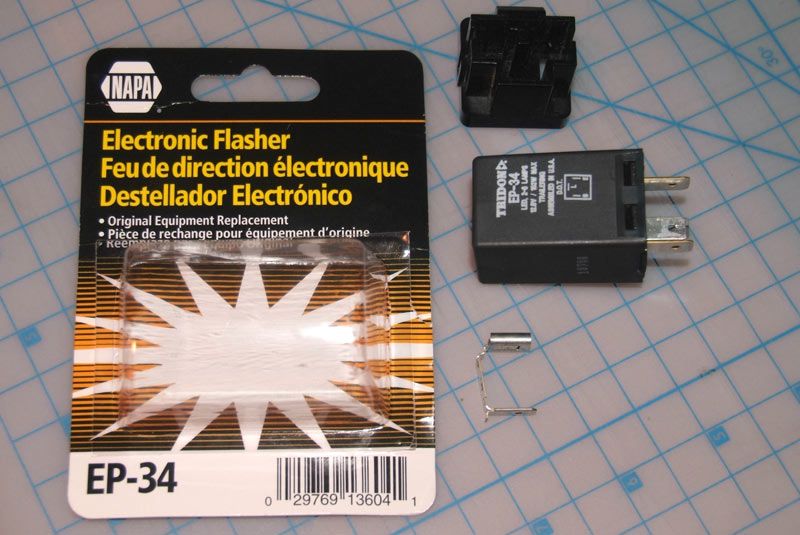

Tuner flashers no more!!
The OE flasher is located in the driver's side kick panel about as far forward as you can go. Turn on the hazards and let the clicking be your guide;)
From what I could gather, the stock flasher is a EP-34 type and according to Landtank's heavy duty flasher upgrade thread Toyota swapped the E and B legs from the norm and used a jumper to reverse the leads. Instead of rewiring the 80, I swapped the jumper over to the new flasher.
Napa carries an EP-34 flasher rated for LEDs, 2-6 lamps, 12.8v, and 162W max (might read 182W max...the ink is blurry). Part number EP-34 and $14.00. The other chains had the same Tridon flasher for around $9. I went for the $14 one to support the shop that dug through the books to find it. Thank you NAPA:)
Works perfectly! :grinpimp: I also want to note that cutting the pin7 LD (Lamp Failure Detection) circuit from the IC chip of the OE relay DID NOT work...
