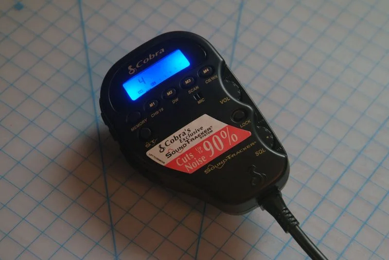

The antenna up and down was a bit lethargic no matter what I did so that had to be corrected. Cut down and soldered a 3 SMD LED into the little bugger and it matches the others perfectly. I tried adding a 1 SMD LED to it like the other buttons but it just looked terrible. The way the button is made the light has to reflect left and right into a little pocket to illuminate the face and an LED pointed down just doesn't cut it. It is hard to take pics at night...the color is more blue in reality but the same brightness.
Before and after:
