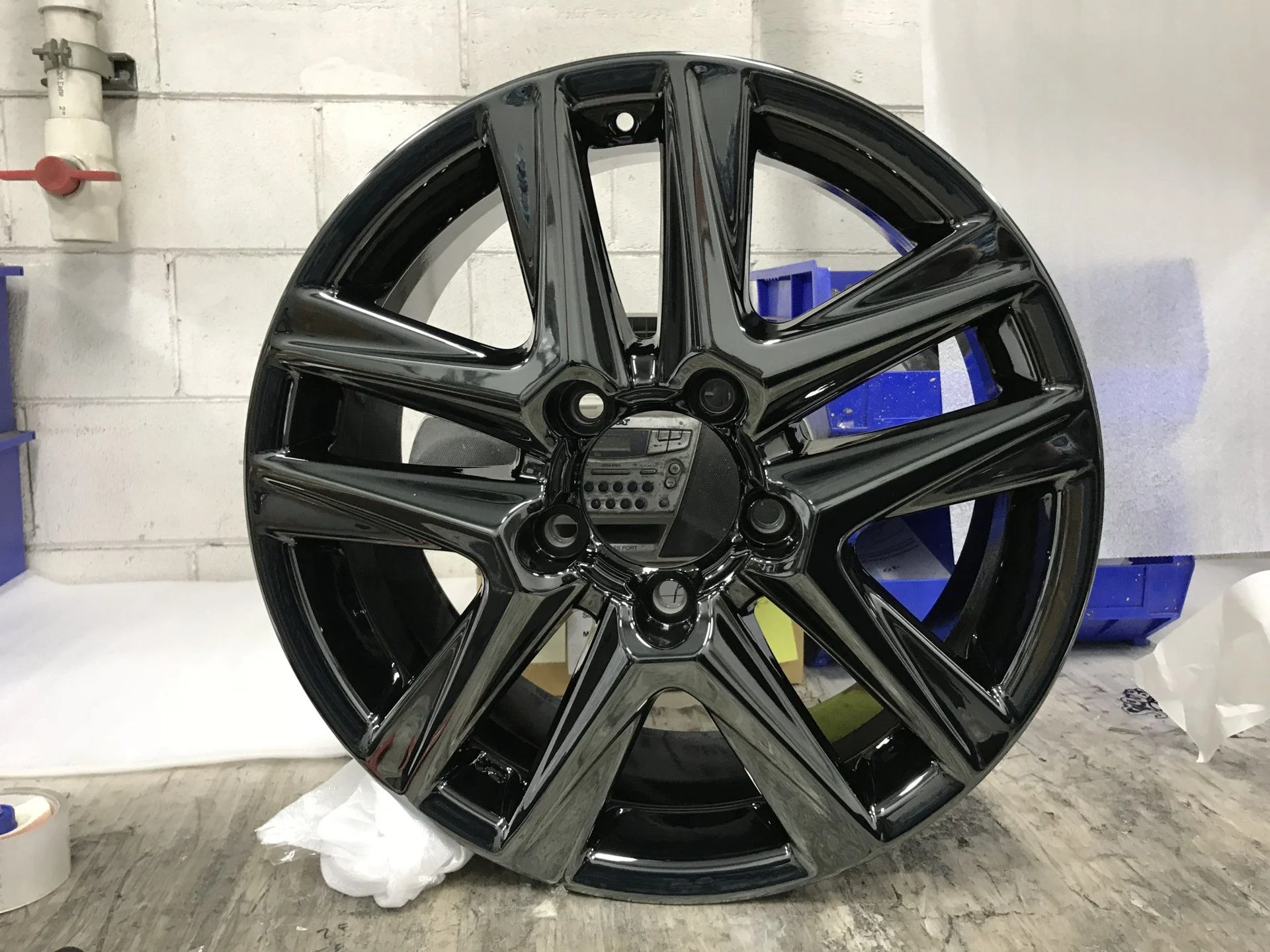

I picked up a set of wheels, tires and TPMS from the 15 model for 750. Right now they are being PVT treated in Onyx Black and then I’ll install the Michelins.
I won’t quite get all my money back from selling the 21s and the tires from the 20s but it’ll be close.
I never liked the chrome PVD color but in Black they should look much better. Looking forward to seeing yours.
I don't think I want to change the original color of my 20" wheels because as I learn from my other cars is that once you start modifying it, you never stop. But I am interested in getting a set of Volk TE37 in 18", but not anytime soon as the car feels still too new so I wanna keep it as stock as possible.
My wheels are almost done. I think they will look great, based on the color of my LX and the dark tint. I'll post more pics once they are done and installed.

I originally thought I wanted more of a gunmetal finish, but the grille is basically that color, so the deep black looks much better (unless of course you are looking for a completely uniform look). I think the process is about 10 days give or take. I shipped a spare to them and so once that is done I will pick up all 5, sometime next week, and then I'll get everything installed.

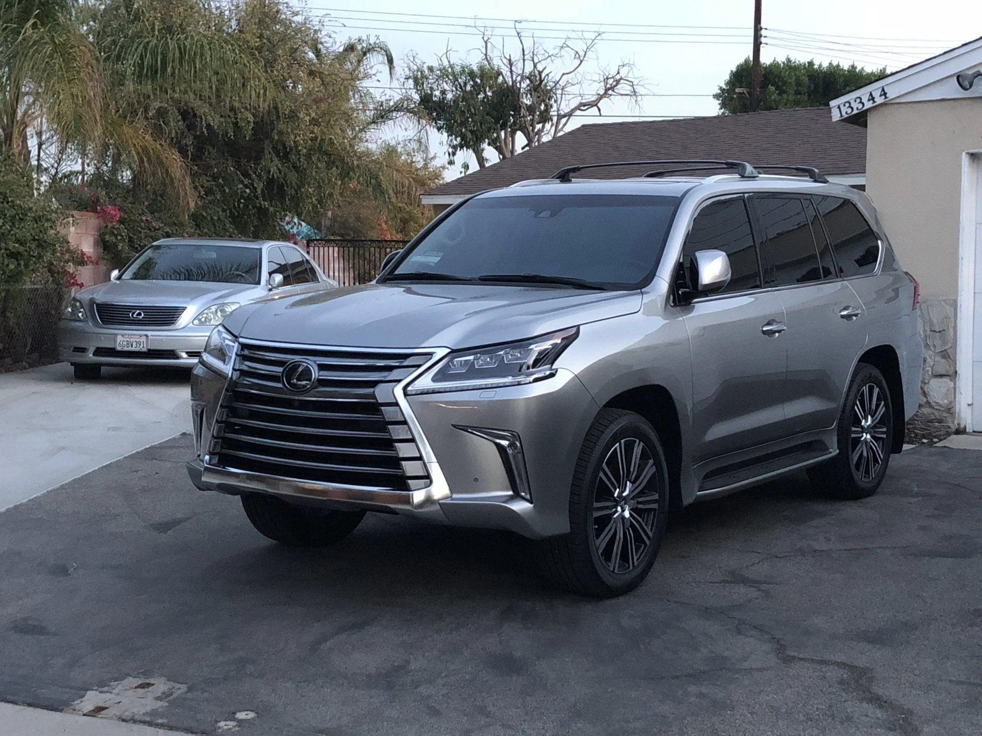

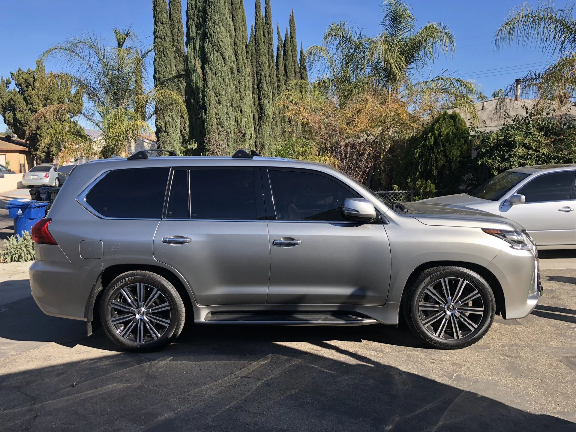

My Lexus dealer just called. Its a great shop. Being in L.A. they have sold a ton of custom wheel packages, as well as OEM wheel packages. They were already willing and prepared to use the heat gun to adjust fender wells, or splash guards etc. They are used to doing all of this for their customer.
That being said, they called today and suprisingly they did not need the spacers I supplied, as these large tires clear the UCAs just fine. What they did notice was a little bit of rubbing, where the tape can be seen on the attached pic.
