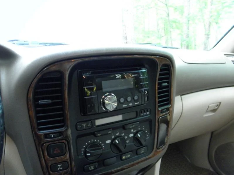

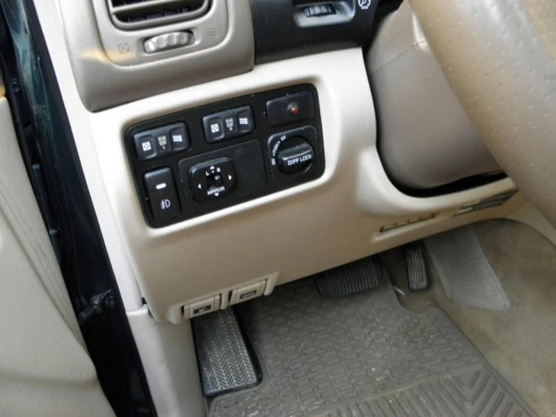

the circular knob there is the rear locking differential switch (says "DIFF LOCK"). The center lock sits on the face of the dash, left of the radio.
there it is, just below the hazard.
