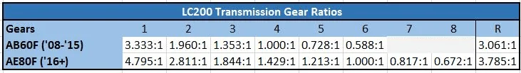

In regards to diesels torque advantage, yes a diesel torque curve can have drivability advantages particularly at higher loads. But peak output may not be one of them, especially when compared to high output gasoline motors that is the 5.7L. Toyota does give the later USDM 200-series a gearing advantages in the form of an 8-speed tranny. I believe most of the rest of world, and the diesel powered cruisers, to still use the 6-speed.
Overall gearing in first gear between the 6-speed and 8-speed is 13.03 to 15.86 respectively. Assuming peak torque of the petrol 5.7L and diesel 4.5L to be 401 lbft and 650 Nm (479 lbft) respectively.
Some quick math gives us max wheel torque in 1st gear to be:
5.7L gasser w/ 8speed: 401 * 15.86 = 6,360 lbft
4.5L diesel: w/ 6speed: 479 * 13.03 = 6,241 lbft
For comparison, 5.7L with 6-speed: 401*13.03 = 5,225 lbft. Diesel will have a strong advantage off the line in comparison to this. Once things get going however, the gasser will catchup and start running away with its over 100+hp advantage. Then the diesel will win the race with superior range when the gasser needs to stop for fuel first. Thank goodness for aux tanks.

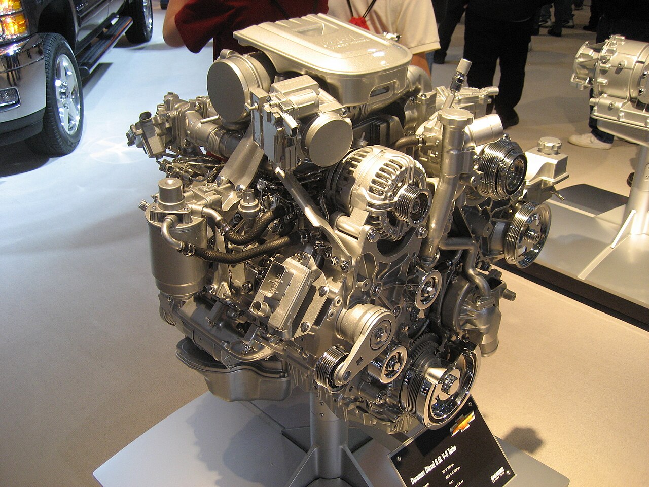

I hear you - I do - but let me offer this. Imagine a similarly spec'd diesel in the 200 platform. I'm just saying 700+ ft/lb of torque - you're not going to have a problem towing over a grade - I just don't get or buy that.
LML (Chevrolet Silverado HD, GMC Sierra HD)2011–2016397 bhp (296 kW)
@ 3000 rpm
765 lb⋅ft (1,037 N⋅m)
@ 1600 rpm
3450 rpm

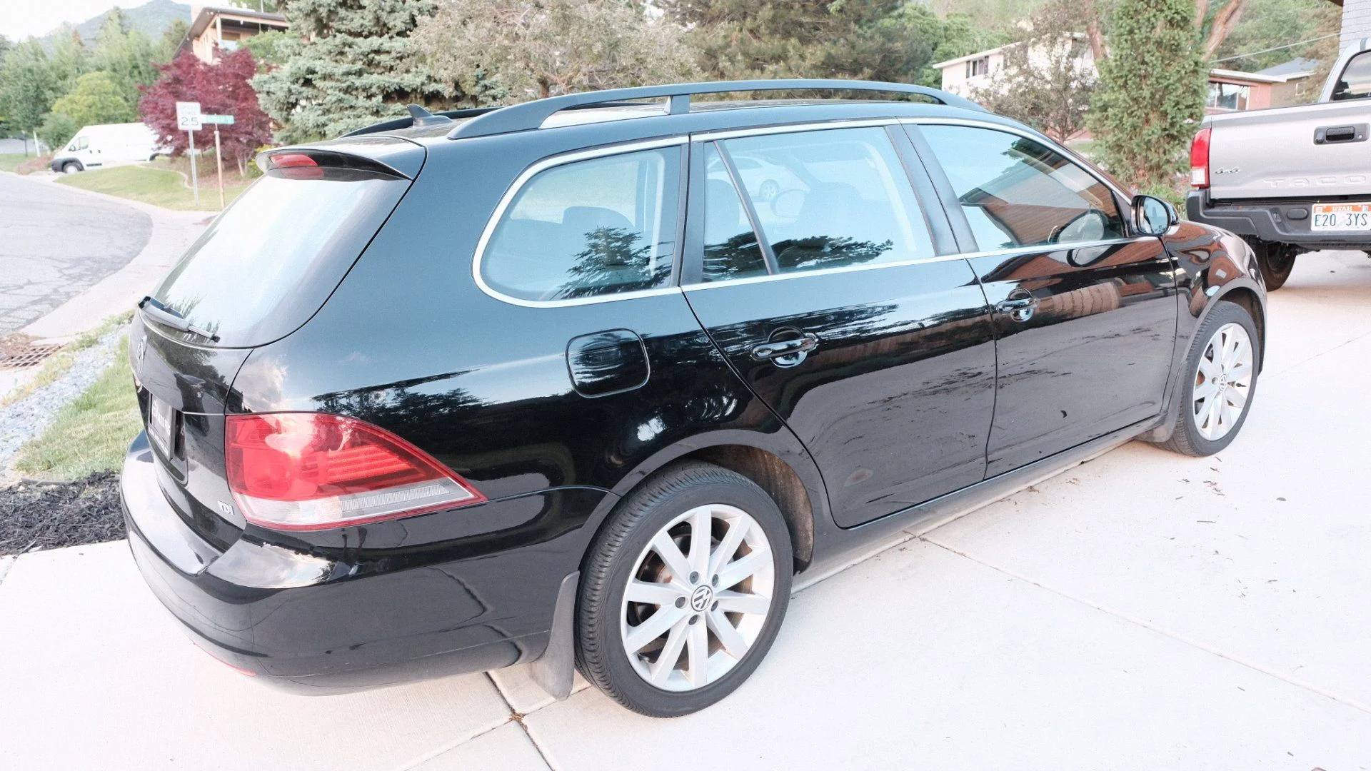

Allow me to digress from the 200 discussion for a moment, you are so right regarding the VW TDI, we had a 2014 Passat with that engine and a six speed manual. 50 mpg plus on the highway. My wife once drove that thing from Salt Lake to LA and had 1/4 tank leftover (not kidding) plus it was fun as hell. However, California decided that sort of thing shouldn’t be allowed on American roads. Just bought this for my Daughter 2014 TDI 25k miles
Don't even get me started on my beloved Jetta TDI sportwagens. 80 MPH fully laden with gear, toybox, surfboards, bikes, in 90 degree weather to the beach (A/C crunk) - 45 MPG. Was it a 'cheater'? Pfffft whatever. Stupid garbage.
