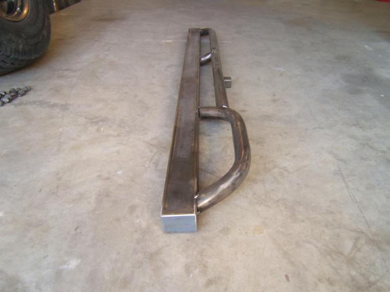

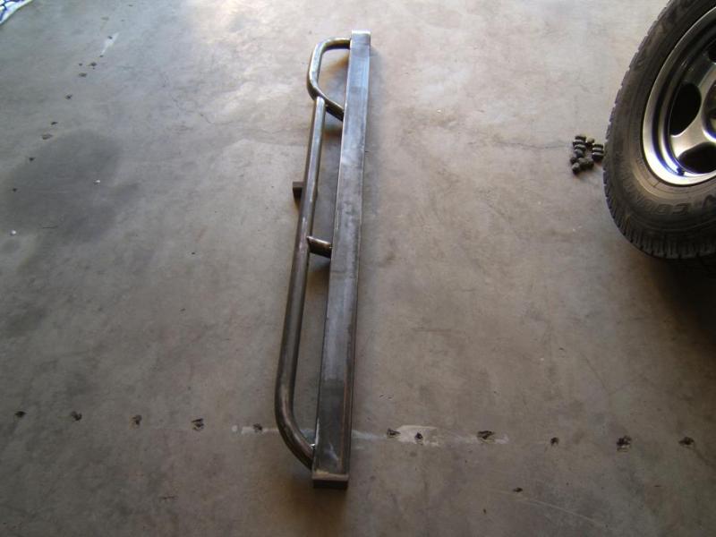

So I've been working on a set of sliders for a local guy here, and made a couple changes to the design from what I have on my truck. I've upped the outer tube from a 1.25 OD to a 1.5 OD, and on this set I've added a kickout at the rear. I'm pretty happy with how they look so far. So much so that I want to build a set like this for my own truck!
Probably no option for the checker plate like on the first ones, I don't think it would look right with the kick out.
Here's a couple shots of the progress so far.

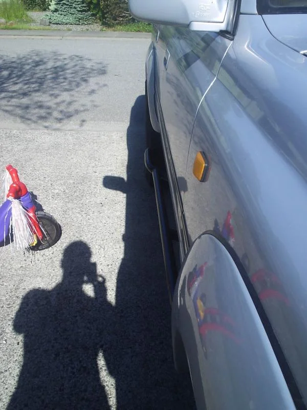

And some pics of the mounting. We (well Jason that is, I just stood in awe of has fab skills), had to modify the one bracket that goes under the resonator for more clearance. Please excuse the rusty exhaust, it's on the todo list.
