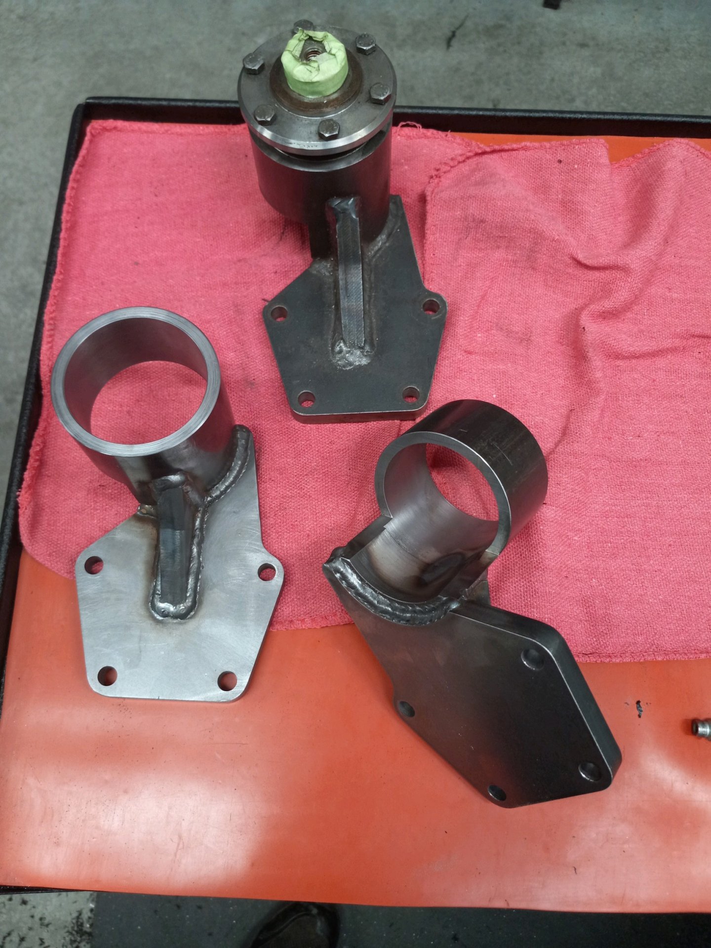

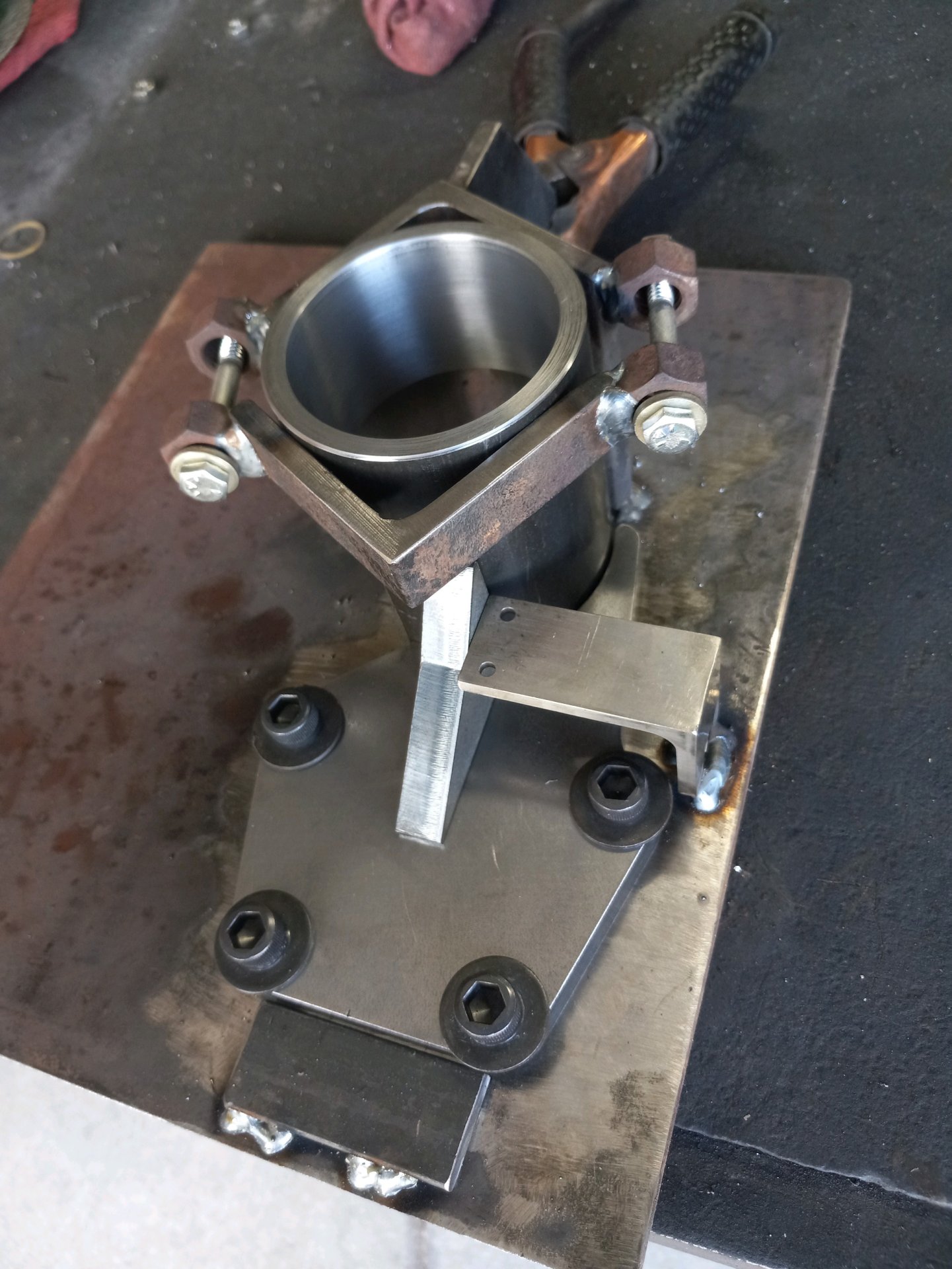

Looking to see if there’s any interest in a fan hub for the 4bt/6BT engine swaps. Currently there are not a lot of options for mechanical fan hub selection for the Cummins engine swaps in 60/80 series. The factory 94-01 dodge Cummins hub places the fan too far towards the driver side and the industrial hub forget about it both causing you to run electrical fans. This hub would allow you to run your 94-02 hub bearing, mechanical fan and pulley centering the with the radiator. You could build a custom shroud or run without. PM me if interested
