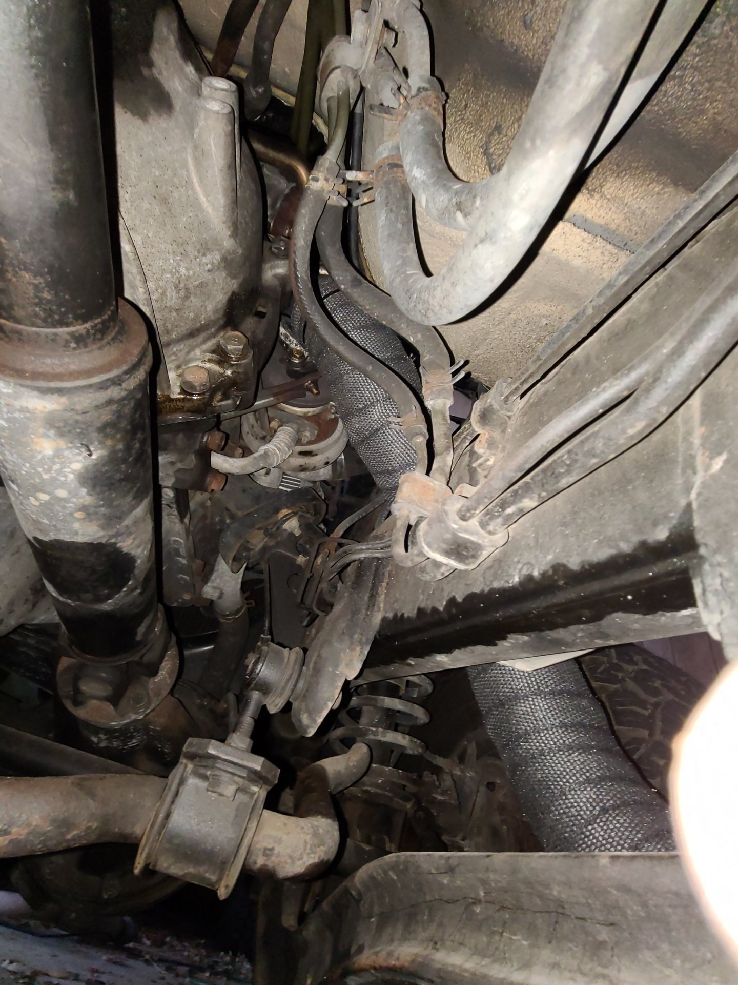

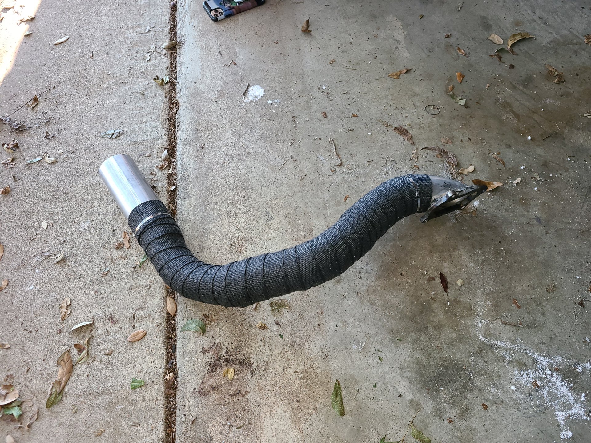

I was able to draw the flange out on CAD software, if anyone needs one made here in the states I can make one made and get it shipped to you, or if someone needs the DXF file let me know and I can provide it. I made a 3" downpipe over the weekend and got it installed.
Here's the 3" downpipe I made
