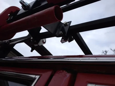

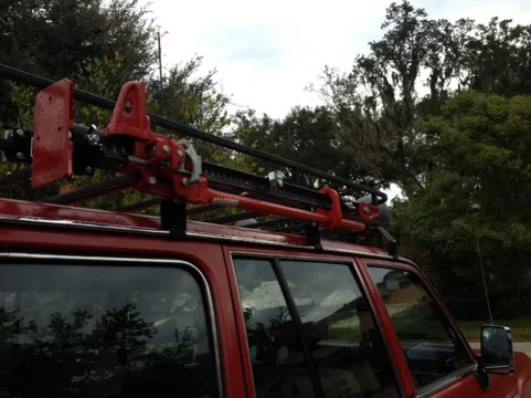

Finally got my jack mounted legitimately, with some 4xrac mounts and some window shutter brackets haha

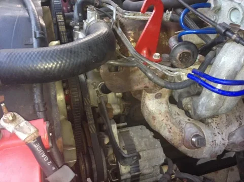

I spent most of today desmogging my 3FE, check out Spook50's "Desmog Guide" of you haven't already, it's very helpful.

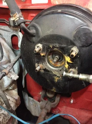

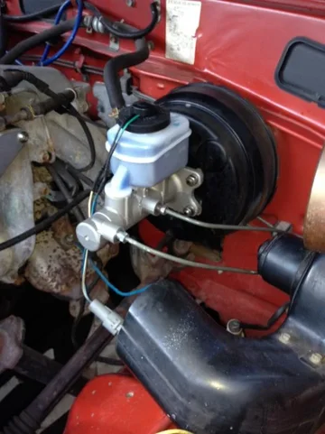

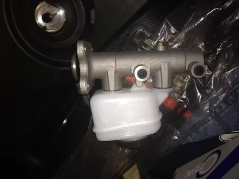

Next weekend's project, 1 inch bore brake master cylinder.
Got my new BMC in Sunday, improved the brakes a lot, they feel much firmer now.

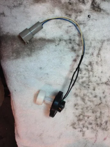

I had to splice the plug from the original to the new wires

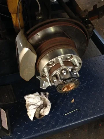

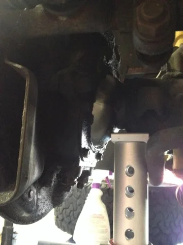

In case anyone was wondering what my wheel hub looks like, had to take the front wheels off, the TLC calipers are bled from the top
All nice and cleaned up
Does anyone think I need a knuckle rebuild yet?

Nice write up Matt, I noticed you got the wheel spacers, I'm waiting for mine to arrive, had any dramas with them.
Nope.
Nope. They've just never been rebuilt with 260K on them.
You will know when they go. You will have drips on the tires and on the ground if they decide to go. Also, your knuckle would probably be so covered in grease and muck that you would not be able to see the nuts/bolts.
Usually I'm of the opinion if it ain't broken you can probably still fix it but in this instance I would say don't mess with it.
Wait until you have to do new rotors or bearings or something then have a look. As long as she's tracking true on the road and you're not getting crazy unusual tire wear its best left untouched.
