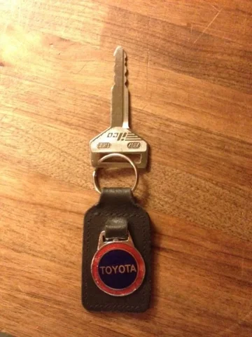

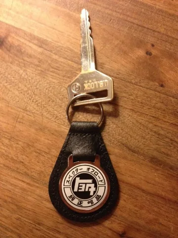

Birthday present from my parents, new key fob
It's replacing the one I stole from my dad:

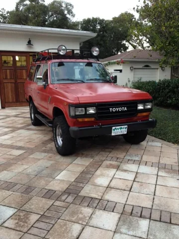

I spent this morning putting the Cruiser to work, hauling more than a thousand pounds of food for National Harvest food bank with the Boy Scouts.
The rear springs were only sagging a little bit, it was worse when we towed the car lift...
Then a much needed and deserved bath and interior vacuum in the afternoon

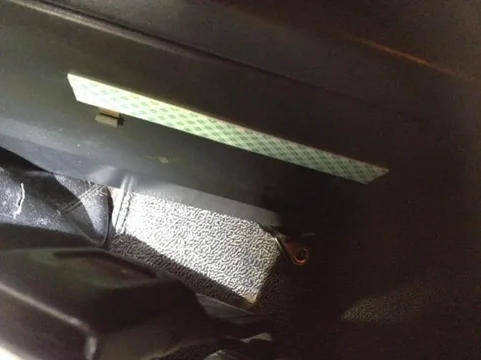

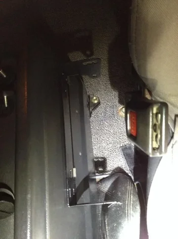

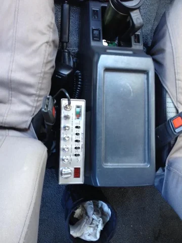

I also got a Cobra 148gtl and a Firestik ll, I didn't anticipate how big the radio actually is. Anyone with a CB of this size have any ideas for mounting?
Alright, the only feasible option I found for the Cobra was in place of the cup holders on the stock center console. The clips that hold them in are defiantly strong enough for the radio, and I put some tape on to eliminate rattle

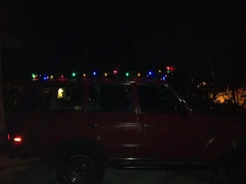

All the wires are under carpet, to here:
I didn't feel like drilling a bigger hole in the roof and real picking the wires that were there...

Running inside outside wires is always fun!
You can use hollow bolts and replace a hinge bolt or something.
Then you just run the positive wire through the bolt, pump the bolt with silaflex and loop the positives to the other lights then just use a rack bolt to negative return.
http://www.jpcycles.com/motorcycle-search/hollow-bolts
There is site that sells the bolt with a terminated sealed cable already in it but I'll be stuffed if I can find it now.
Ehh it's long-term temporary if you know what I mean. When I do a real rust repair/restore on the roof (unlike the load of bondo and paint from a year and a half ago) I'll pull the wires and do it right, maybe run them trough the inside of the A-pillar unlike how they are now, although it is slick:
