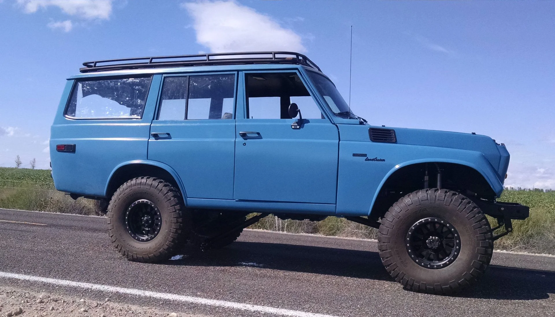

Picture from when I first installed the kit.
Picture how it sits now with the leaves reinstalled.
I installed the kit about 2 month ago. Rear hanger back 5 inches. Didn't remove any leaves, actually added 2 add-a-leaves to the front driver side to help with the cruiser lean.
I need to see that lol
so i'm not the only one with the lean on my 55? that's good to hear, i guess. I ended up going with Alcan springs so I could just keep my stock hangers in place. The ride is real nice, but I have some body roll. I guess my truck was made 1 month after they quit installing the sway bar at factory. Trying to round up the parts to install one.
