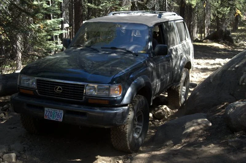

So one thing I've always loved about the classic cruisers is the white top. It's so iconic, and one of the first things that catches your eye.
I plan on bedlining my roof (after I remove my rust rack), and was considering either:
A) Leave it the dark grey.
B) Spraying it with white.
I would probably get some of that automotive paint in a can and going over it. The bedliner should stick to paint well enough, if not I can prime it and then go over it.
I'm not planning on having a picture perfect paint job, probably a good-at-10-feet look.
Here's a (very poor) photoshop I mocked up of what it might look like.
(And no, I will not paint the roof pink. :flipoff2: )

Yeah...but I actually care about the way my truck looks. :lol:
