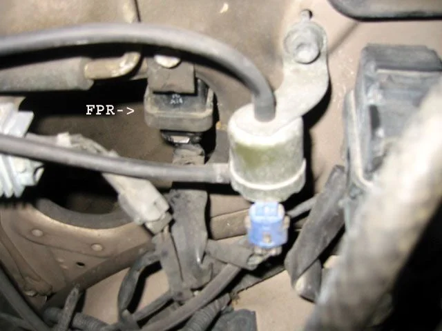

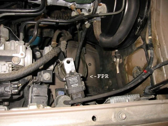

You have it right....I unplug the FP and the check engine light came on. I plugged it back in and the light went out, I had to do about three times just to make sure I was not seeing things. It's really weird. One other thing, I still can not find the fuel pump relay and I really want to check it first, anyone have pics of it's location. I was told by the dealer that it is on the passenger side fender, but could not find it. Thanks for the replies!
Now that I think of it, if it was the relay, how would that affect the MIL/CEL when I unplug the FP?? I would think that if it were a relay, the light would not illuminate whether I plugged or unplugged the FP.
The Fuel Pump Relay is located under the bonnet, on the left side of the engine bay (US Driver Side), aft of the fuse box, and just inside a large hole in the left front fender. It is mounted on a bracket.

Beo....So youre saying on the driver's side then right? My fuse box is on the driver's side fender.....I will check there, thanks!
Yes, but it is better if we use left/right instead of driver because this is an international forum and we don't all drive on the left side. We also refer to left/right based on someone sitting in the driver seat, facing forward. Or we post a picture with a big yellow arrow pointing to the part in question. :D
attachment.php
attachment.php
(Photos courtesy of SUMOTOY's FPR thread)
