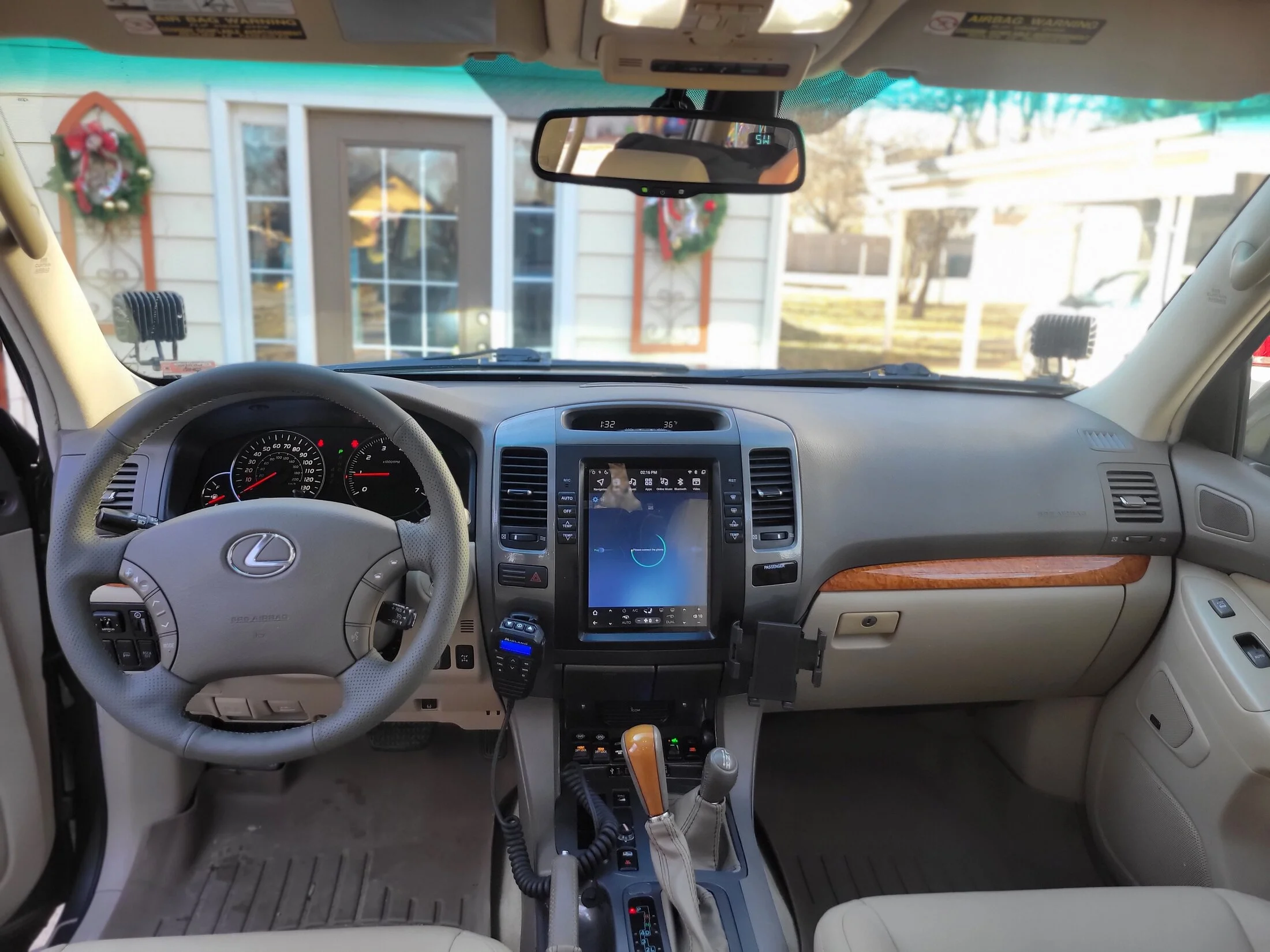

i replaced my dashboard in 2017 on my 2003 GX470…it’s been over 7 years and it still in great shape. I park outside everyday in SoCal
I do use a windshield shade about 50% of the time
Update: and also replaced the seat leather in the front (LSeat.com) and carbon fibered the wood trim!

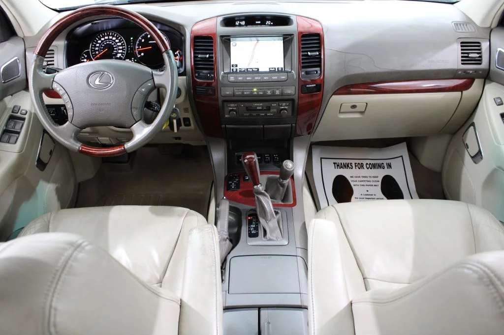

My dash is Sandalwood. Not sure about the one pictured above.

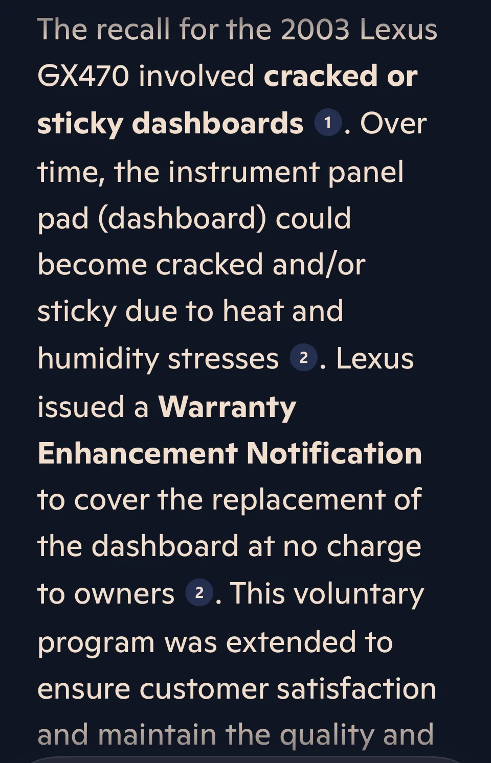

Here’s what copilot pulled up on this topic…
