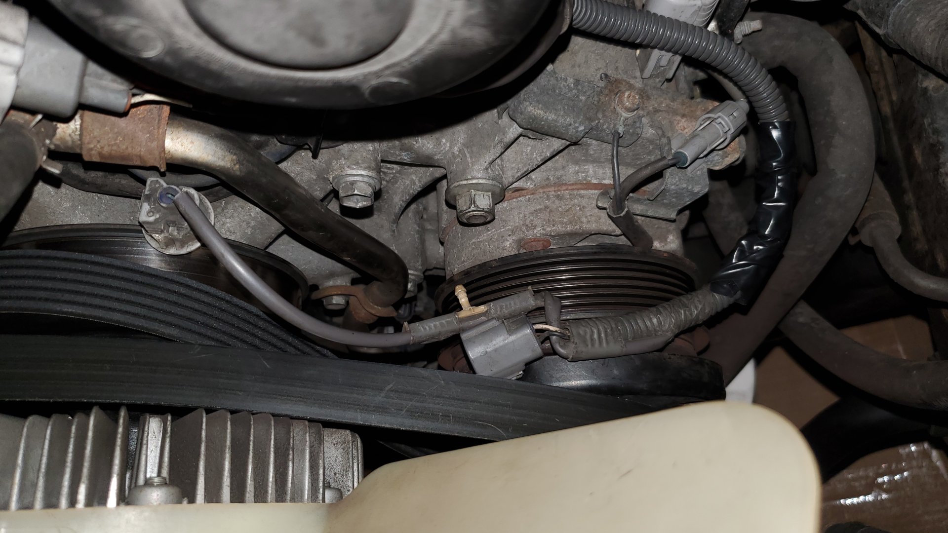

I assume shop after timing belt routed my harness wrong because I caught the drive belt fraying the plastic harness sheathing. So I am trying to move it but only found a post about behind fan bracket ? This was search via google havent been on mud in forever. Is it possible to re route as I am in attached photo? Can someone put arrows or something lol. I pretty sure I caught before frayed wires. It runs fine etc. Thanks all. Or does tons of stuff have to come off to move?
I assume shop after timing belt routed my harness wrong because I caught the drive belt fraying the plastic harness sheathing. So I am trying to move it but only found a post about behind fan bracket ? This was search via google havent been on mud in forever. Is it possible to re route as I am in attached photo? Can someone put arrows or something lol. I pretty sure I caught before frayed wires. It runs fine etc. Thanks all. Or does tons of stuff have to come off to move? View attachment 3095220
Well researched and found timing cover etc has to come off so harness can run over back of ac compressor down under timing belt area etc. Going to half to yell at moron local long time mechanic to get labor discount. They will be replacing thermostat in a week so i guess they will be 1/3 of way there anyway.
