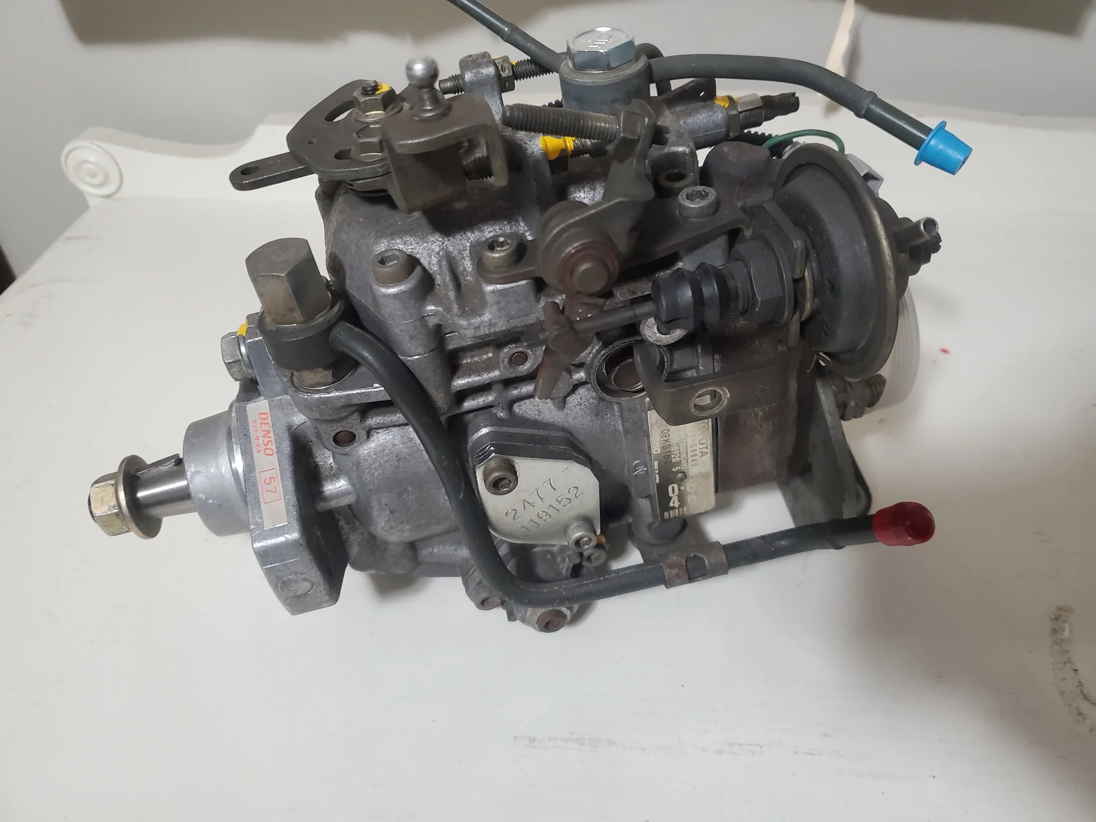

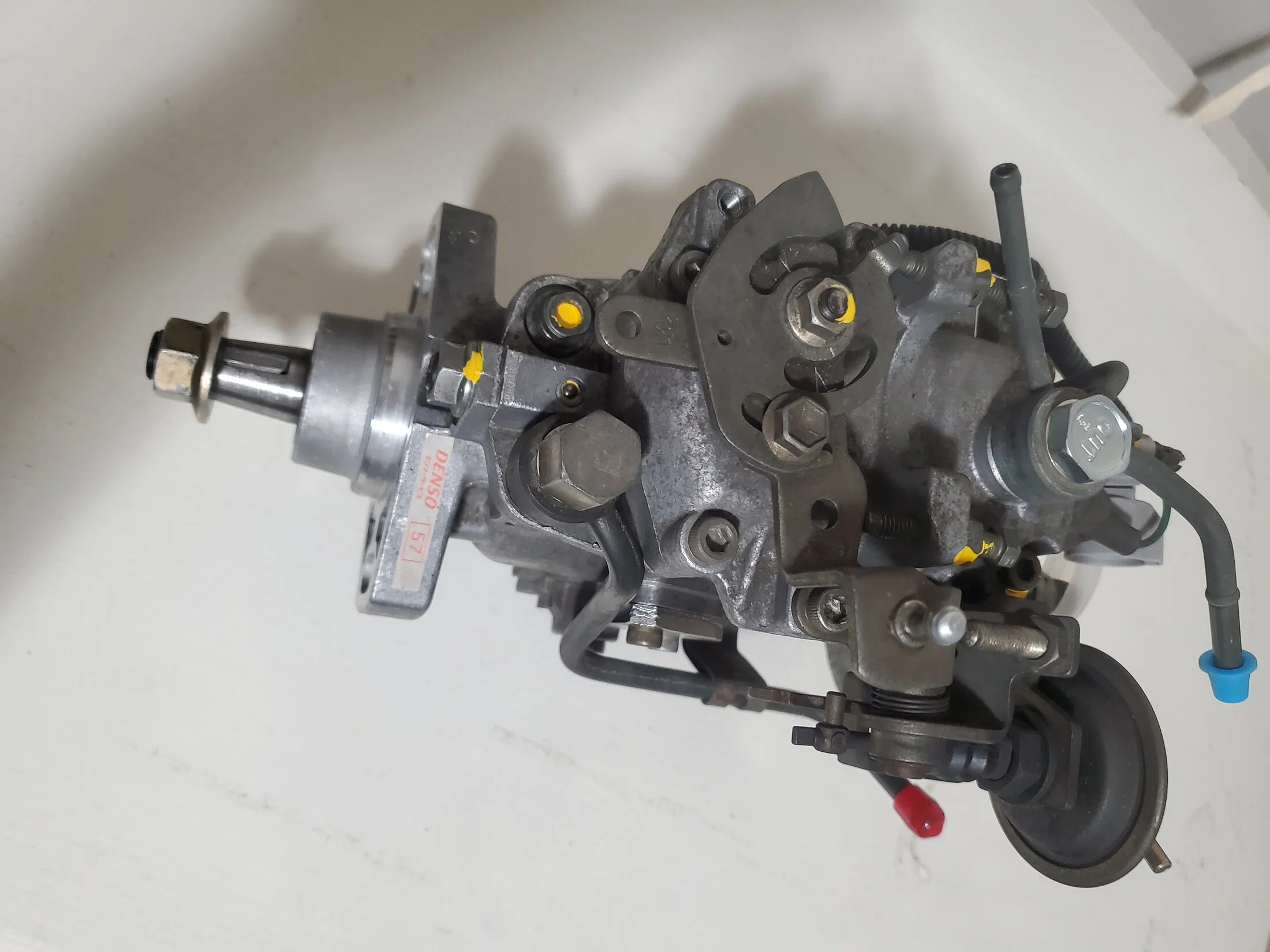

What year is your engine?
I just bought a 93 3L and the pump come with boost compensator already

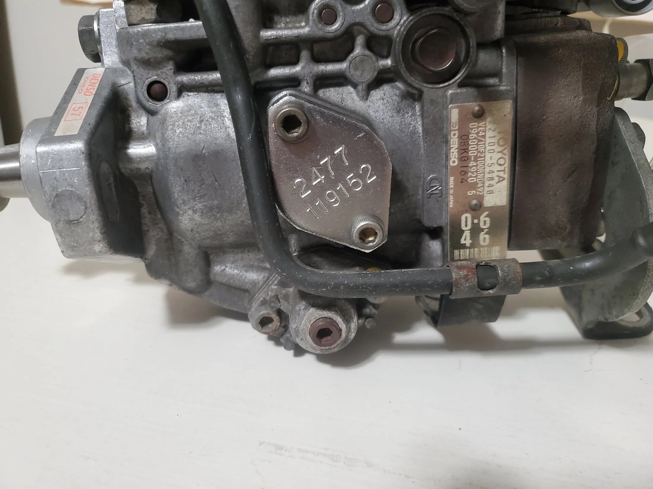

can you post the pump id tag and a pic of the pump?
i search on partsouq and the boost compensator are out of stock,some one on this forum must know where to get one,
im glad my 93 hiace 3L pump (lh117) already come with the compensator.
