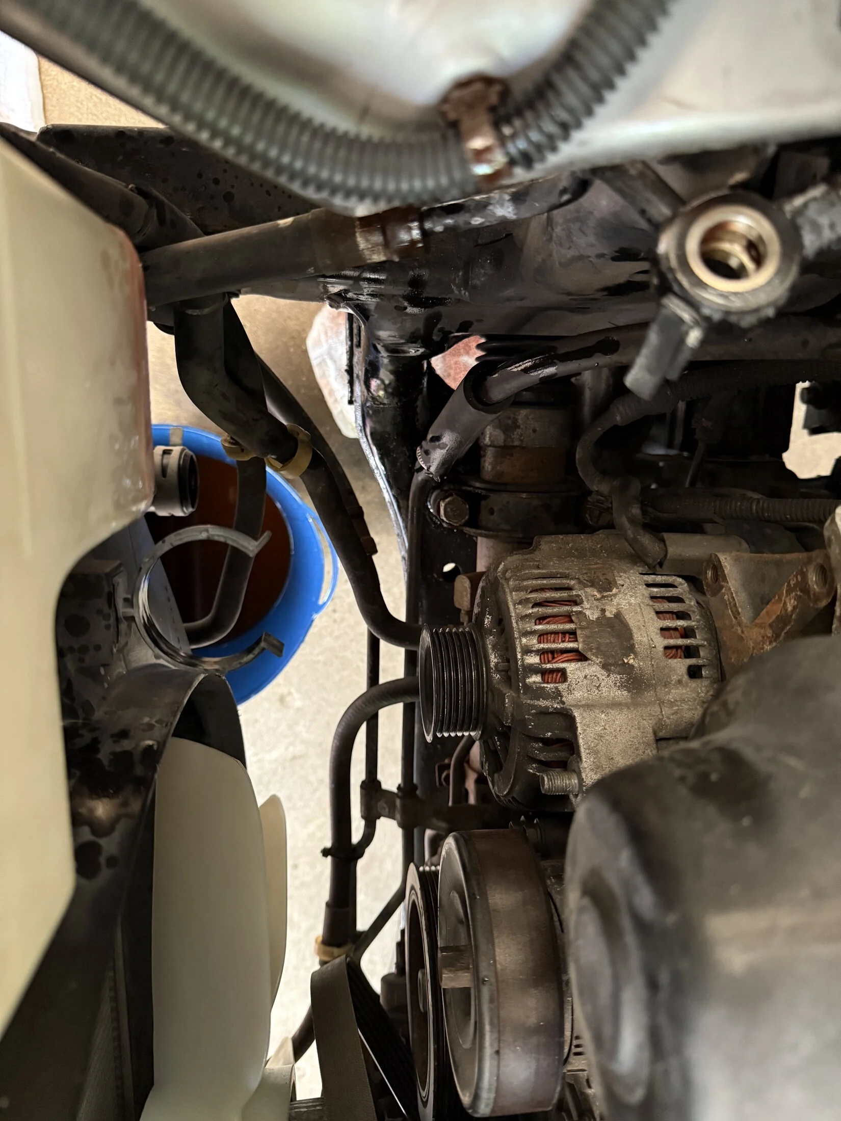

For me, it was much easier to remove the PS pump and the radiator hose #2 to get the alternator out from the top. The amount of room that opens up is 1000% worth the small amount of effort it takes to remove the pump IMO.

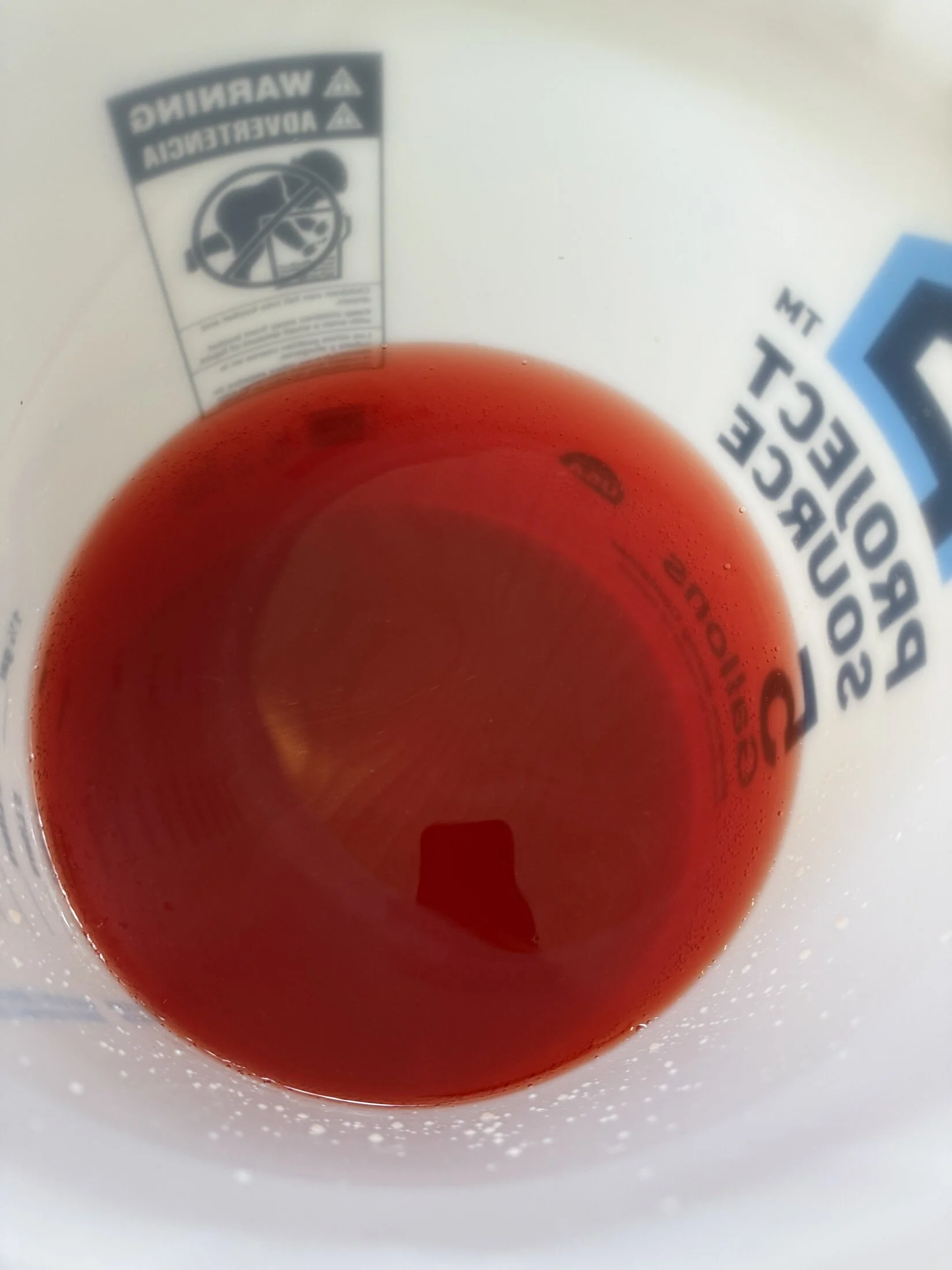

When I removed the radiator hose, I caught the coolant in a non-measured bucket (wasn't planning on doing this initially, still no excuse for not have what you need). It mostly came out of the bottom of the radiator, but eventually some came out of the engine as well. It's probably about 2 gallons worth, and I'll grab a measured container tomorrow to know for sure.

Coolant is toxic and requires careful disposal. When I remove some from the system for service and I know it still has some life left, I just filter it through a white cotton t-shirt and pour it back in the radiator. I’d rather deal with disposing that soaked shirt than a gallon or two.

Thank you. I’ve left the coolant uncovered for a couple of days- you think it will be ok to add it back as long as I filter it?

Thank you. I filtered it and will resuse. Bought a gallon to account for spillage.
