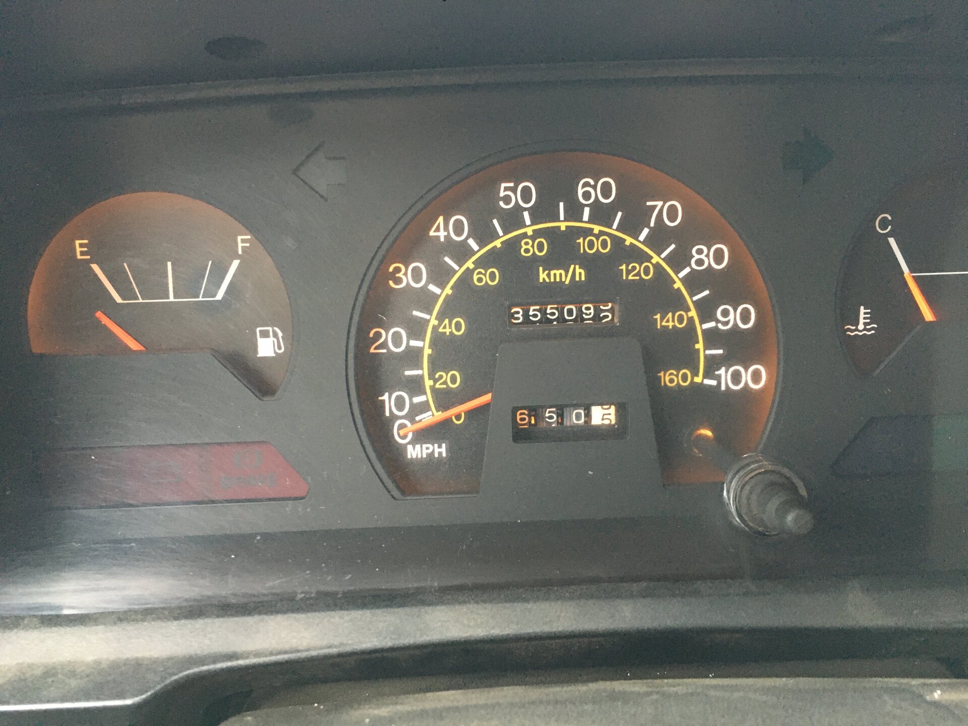

It's still illuminated as it was before. It's a good match, hard to tell it's not stock.
Looks really great - nice job. So the dial will just be dark? Not a huge deal really, I can tell how fast I'm going by the seat of my pants usually, but I didn't know if someone was going to attempt to illuminate the front/surface of the speedo somehow. There are some very small LED's out there that could be an option.

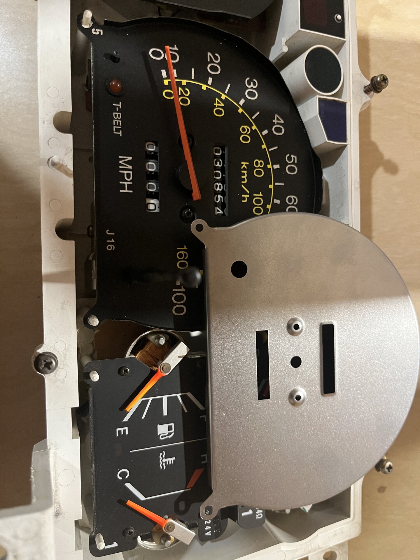

Here are what the metal dials look like.

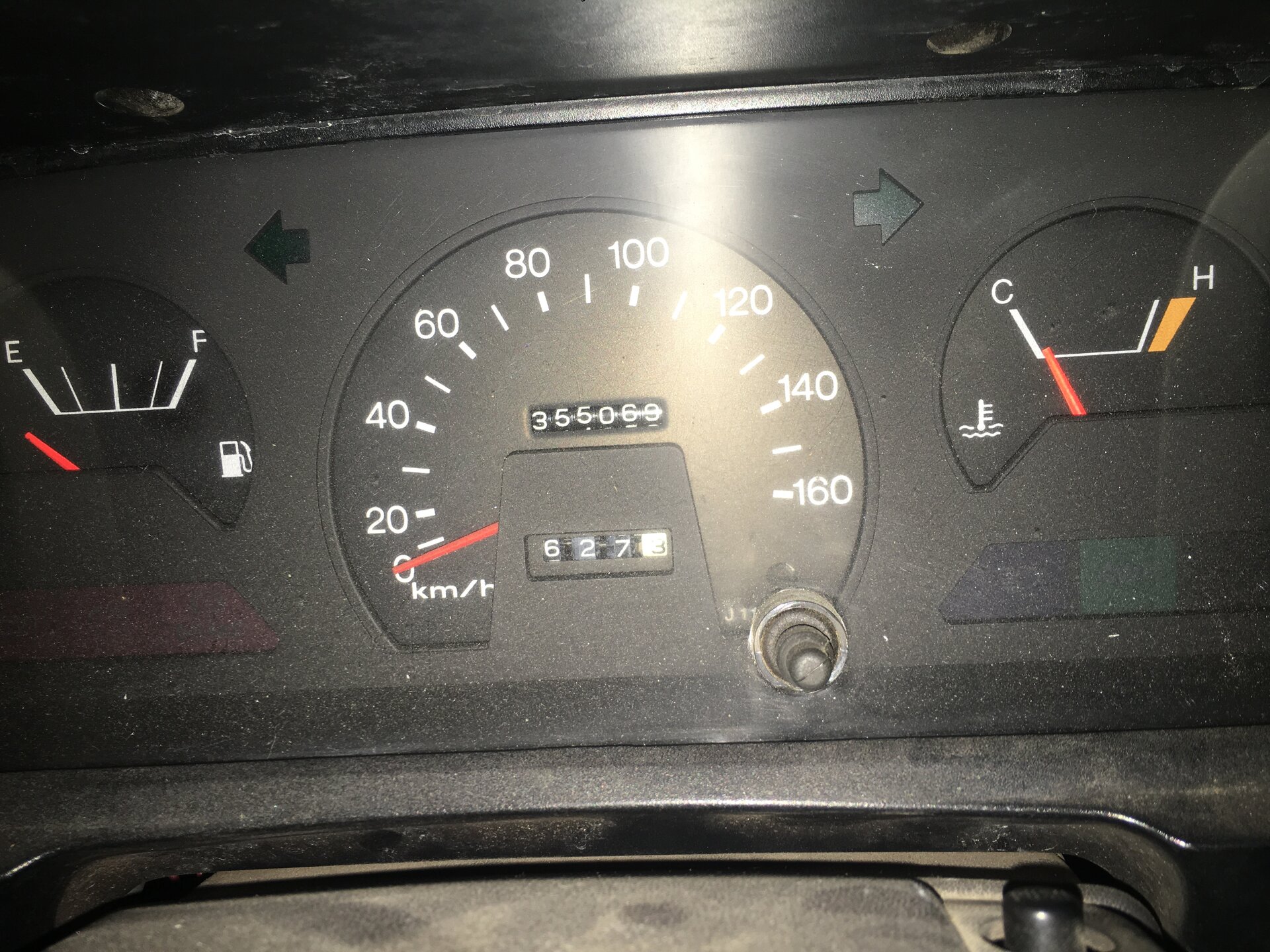

That's fantastic. I have a 180 kph dial - my 100 kph is dead vertical. Do you have one like that? Or is easy to re-do the speedo cable to adjust? I'm ready to throw some money at somebody.

I have one ready to go. If this is what you need, Send me a pm and I can get this heading your way.

@JVZii @FJ73Texas - these look great! But from what I gather, still not later model backlight option available, correct? I have a 1994 75 series, with 180kmh plastic face
I've been thinking about options for the backlit gauge folks who don't want to put a vinyl sticker over the backlit kmh numbering.
One idea is to keep the current gauge face and leave the outer kmh numbers backlight, and use Dry Transfer decals to put the mph numbers on the inner side of the gauge (basically like @FJ73Texas original design). Dry Transfer decals don't have any borders and don't need to be cut out - you can just press them onto the gauge. The experimental aircraft folks are using this to make the labels on their cockpits. Turns out really nice.
Here's one of the recommended companies. It's a little price for a sticker, but if we get a few gauges printed on a larger sheet, we can all split it up. We could even print different gauge designs on the same large sheet, since there's so many variations of gauge requests out there.
The only drawback is that the MPH still isn't backlit - but at least you don't obstruct the the KMH backlighting.

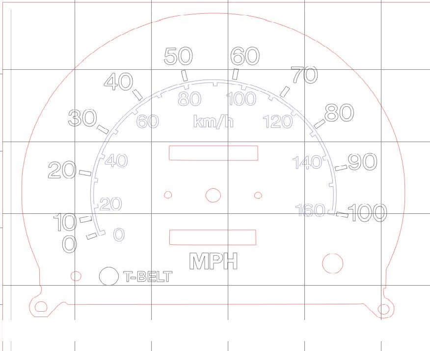

This is a continuation of another discussion around converting the face of the 70 series which I think are all Kilometers per hour over to miles per hour. I have a rough outline of the 160 max conversion (which can be done with our without the kph) however I need some additonal help to complete the setup. Namely I need a faceplate to make sure the art work all lines up and then to do a video of how to install.
Here is the conversion for the 160. I will do the 180 next.
