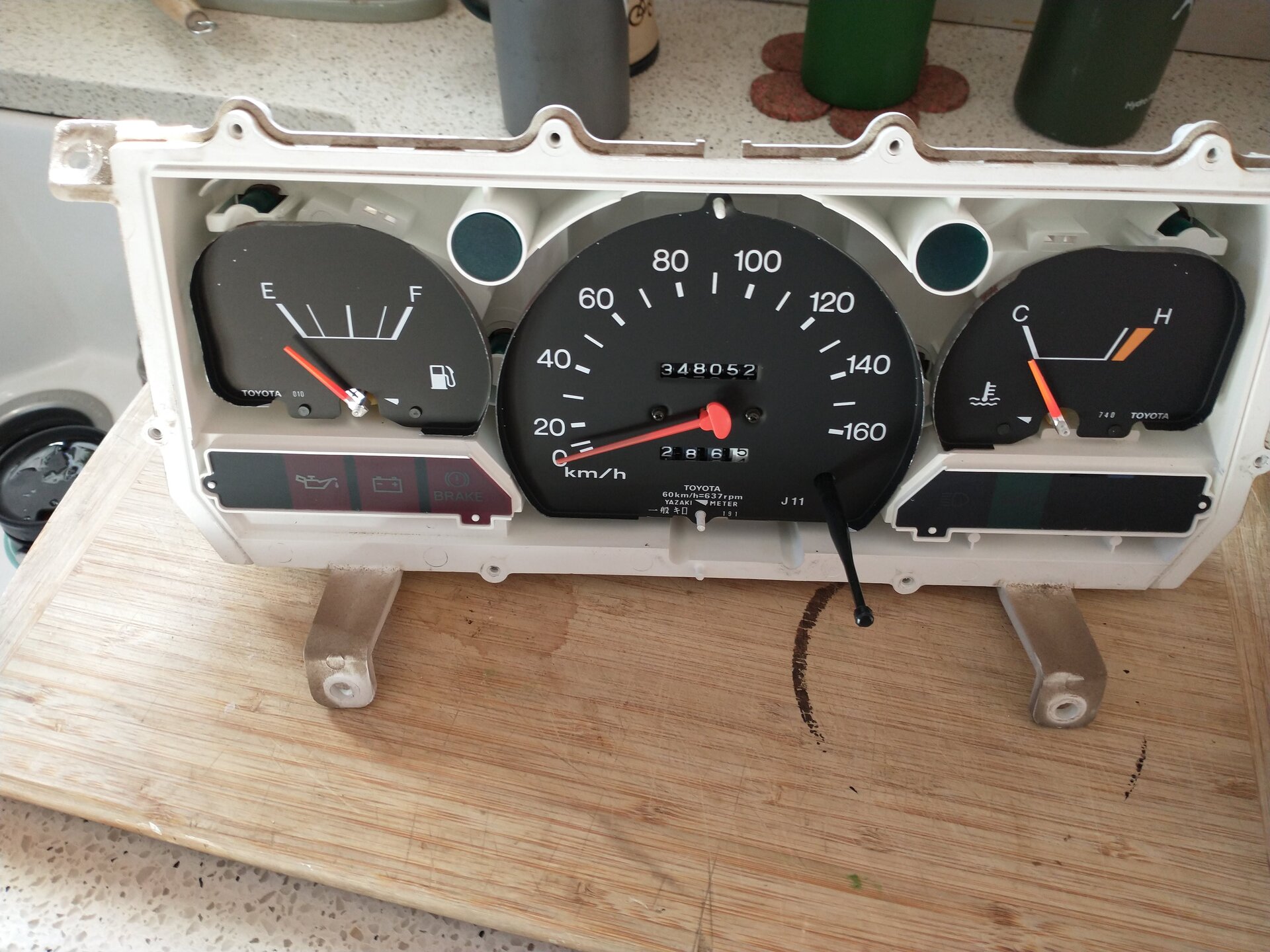

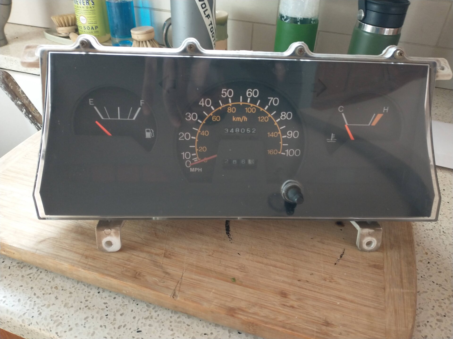

Yes - @FJ73Texas - that's what I'd like to have. Except my timing belt light is on the left, not the right. I have the identical original speedo to the one @woytovich pictured back at the beginning of this.

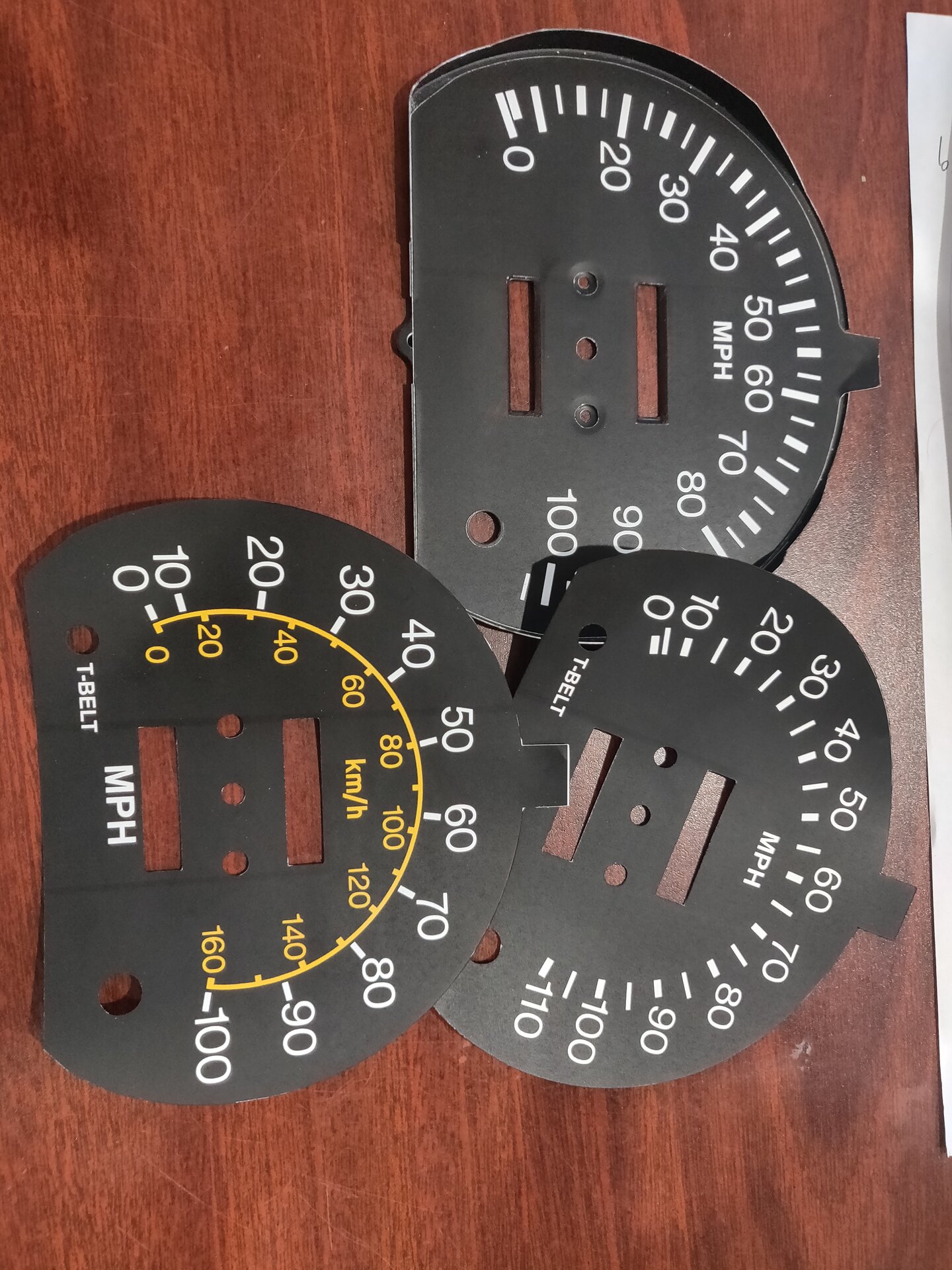

The circle you see (in the first photo I posted up) that you assume is for t-belt is actually for the reset button/shaft for the tripodometer. I also had the t-belt version drawn up as well (shown below).

Ok everyone I have these ready. I have this done. I have the single color 160 and 180 conversions as well as the two color conversions done.
There are so many variations on the T-BELT that if you send me a picture of your speedometer first it will be helpful. I can move the T-BELT on top of to the side of remove it easily if you just let me know.
I am going to list these on eBay to see how they do but PM me if you want one here. $30 and that includes shipping.

What is their structure? Are they peel and stick? Will they work with backlighting? These threads went through so many permutations I can't remember the specifics.

This is a peel and stick setup. It's a printed vinyl sticker with all of the cutouts for odometer, trip meter, T-BELT etc.
These are not for the backlit applications unless you want to put this over the existing speedometer.
