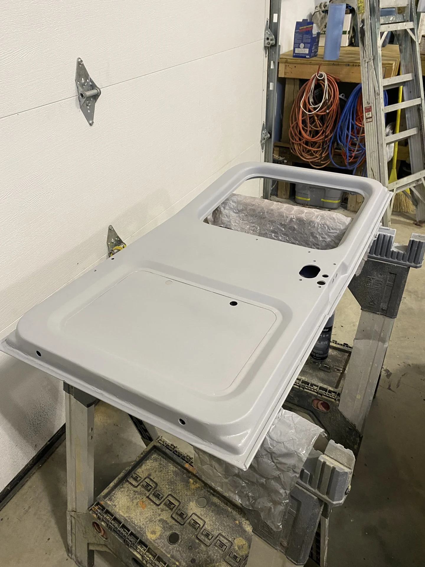

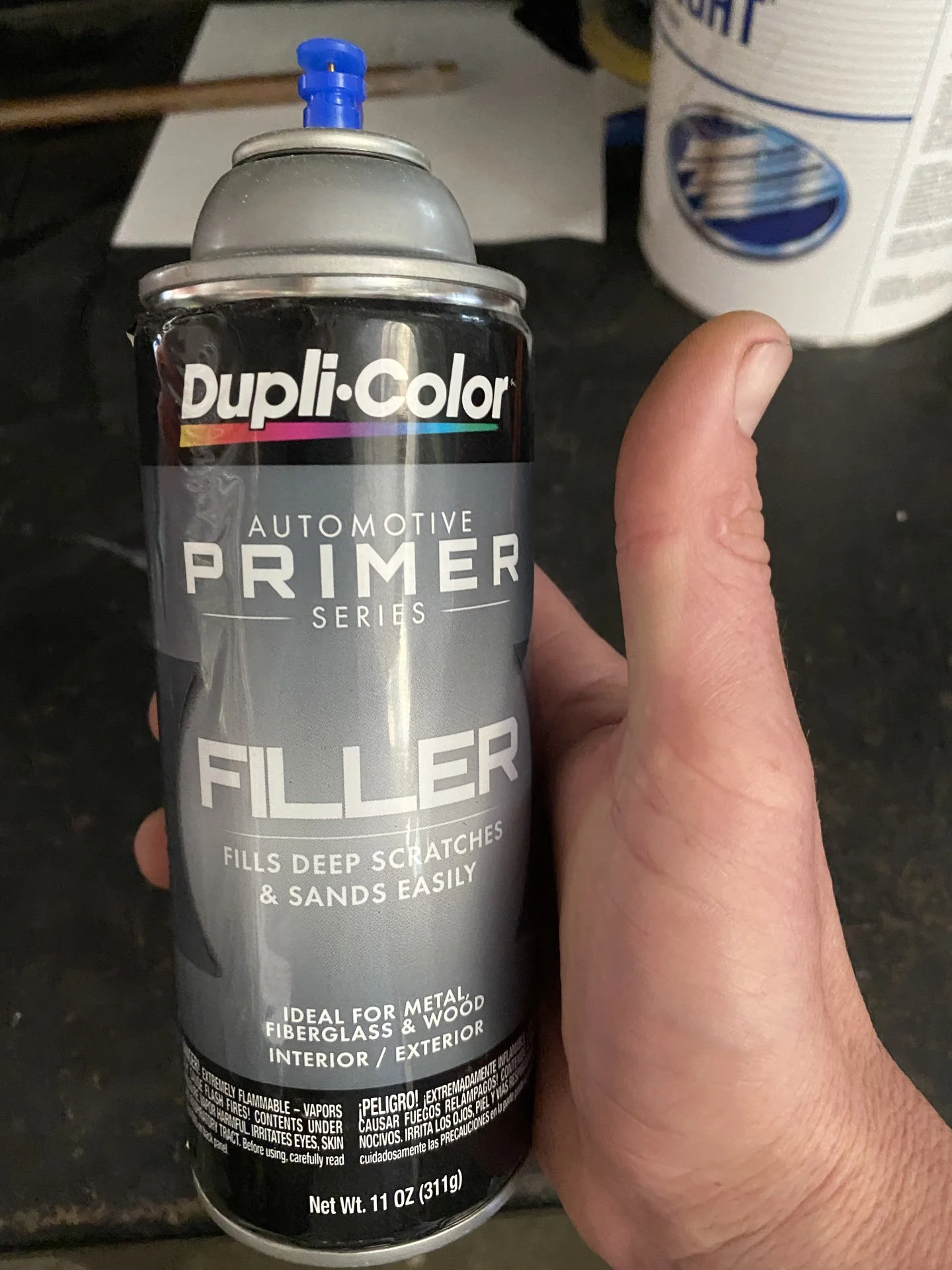

The amby doors, sides, aprons, and fenders have all been sanded down or sand blasted. I used Eastwood's Fast Etch on any bare metal, followed the directions, and then applied two thin and one medium coat of Duplicolor Filler primer. I started with the Duplicolor primer due to the convenience of the spray cans, and got a good price on a bunch of cans. This allowed my dad and I to chip away at one panel at a time without having to mix a batch of epoxy primer.
Pics of some panels and progress on the rear quarters we replaced.

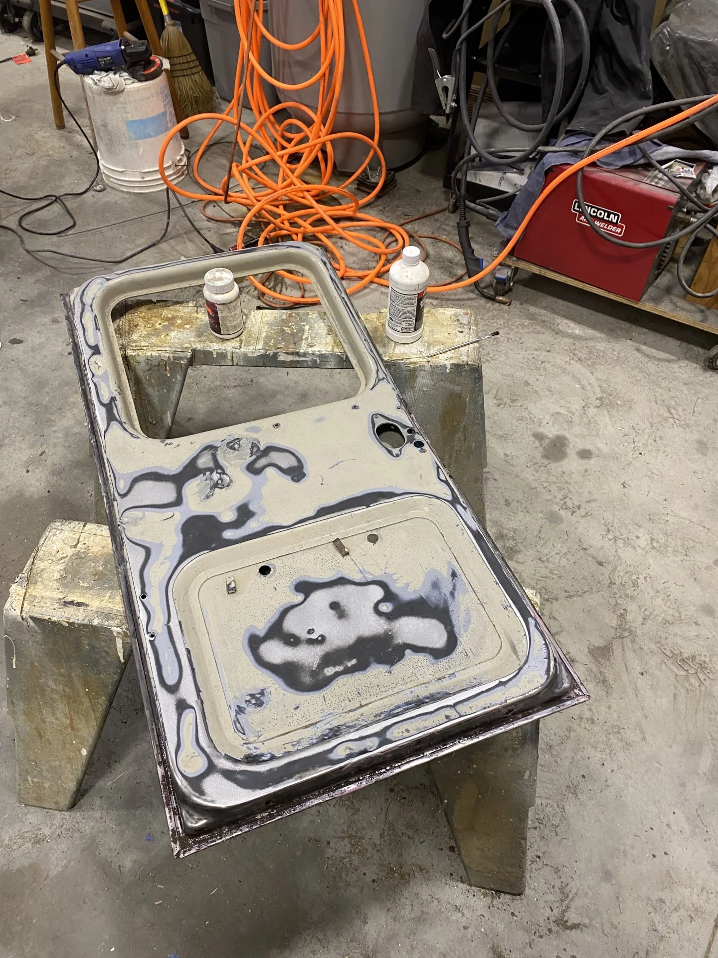

Fenders and bib after I sand blasted, cleaned and primed.
