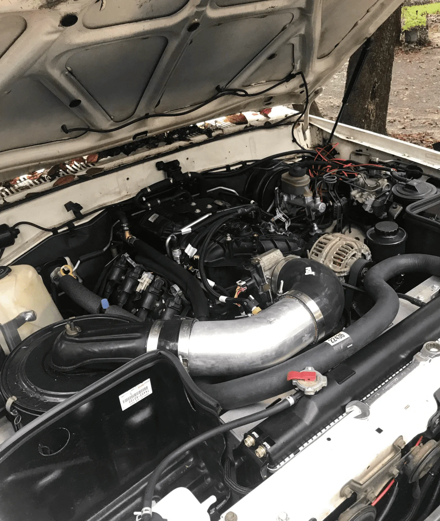

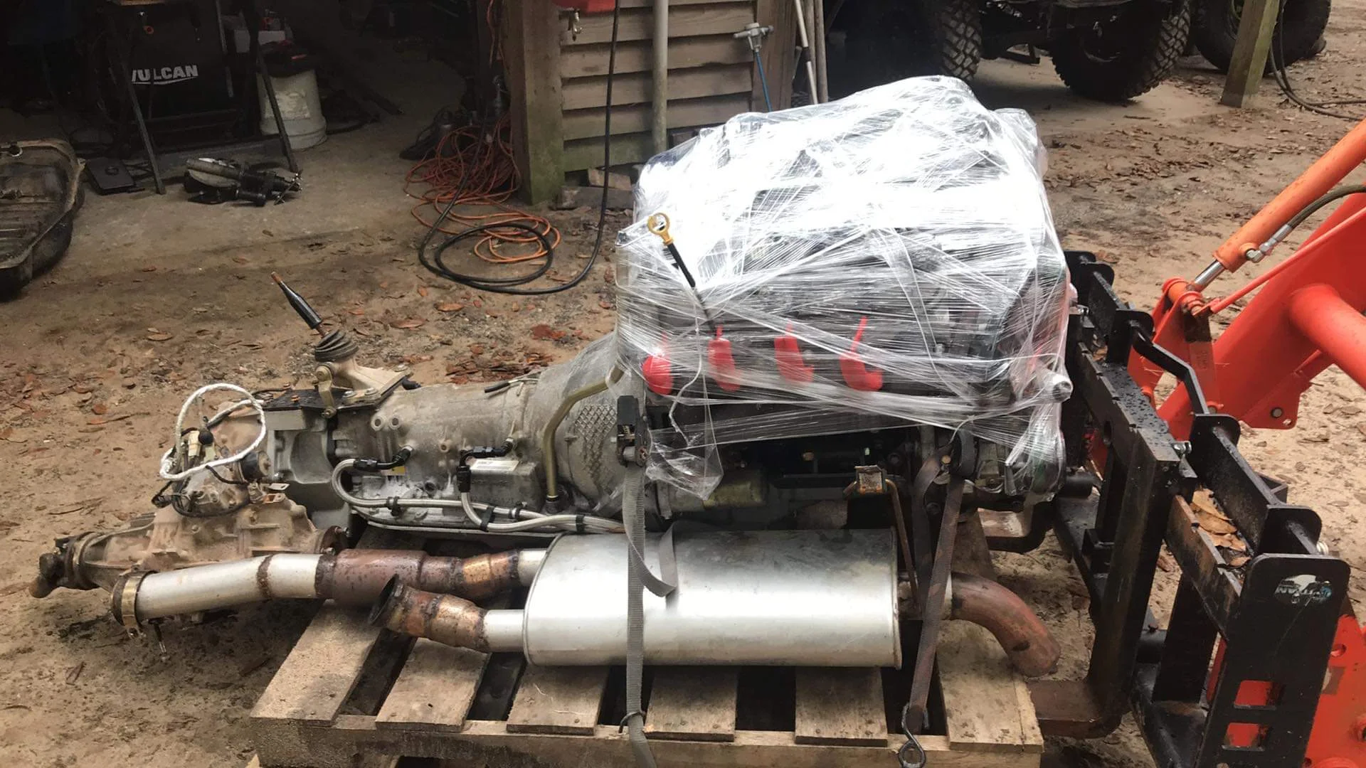

Complete 6.0 LS swap ready to go. Located in South Georgia.
Swap includes just about everything you need to swap into your 80. This was pulled from a running and driving LX450.
Freshly built 6.0 LQ4
4l80e transmission
Marks T Case adapter
Holley Terminator X Max ECU and Trans controller
Power Steering Lines
AC lines
Drive by wire gas pedal ready to bolt in
Transmission shifter. modified and ready
Motor mounts
Complete exhaust

This was my list of items I was going to need to complete the build
Front drive shaft $400
A couple power steering fittings $30
Power steering cooler $30
Heater control valve $35
Rear coolant fitting $30
I was going to use my stock radiator with mechanical fan and shroud to fit. So that decision will be left up to the next person.
Gauge cluster will work with the swap. I believe the previous owner already adapted the water temp and oil pressure sending units.
One thing I was not 100% sure about was the TACH. You may need to use a dakota digital box to convert that over. That sells for around $100.
@Natev22 I tried to direct message but your inbox is full, was wondering what else may need to be purchased or modified to have it driving?
Will the factory 80 cluster work or will it need to be modified in any way?
Thanks,
John
Hey john!
So what he’s selling is basically complete engine and trans, adapter (you supply your tcase). It also includes the full exhaust, Holley terminator to run it, trans cooler lines, radiator hose, engine mounts, intake and I’m sure I’m leaving something else out. However basically all that’s needed to make this work on your end is wiring it up on the vehicle side, build a custom trans mount which isn’t hard, and modify your existing shifter! Then have a front driveshaft made. I purchased my driveshaft off eBay for $400. It’s a great engine and trans, and I honestly should of just left it in place haha. But my dmax swap is almost done now so, we will see!
