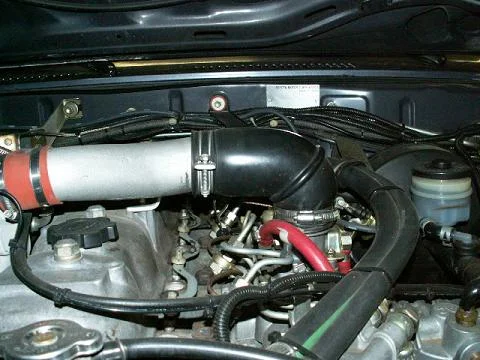

He did mention that with the boost pressure the oem hose doesn't hold up. I'm trying to find a pic of the replacement michael did.
Michael? you out there?
