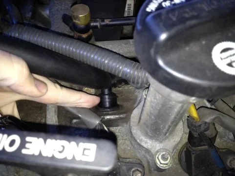

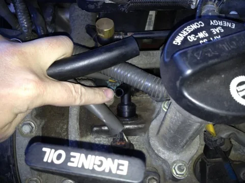

Where is the PCV valve located? I'm on the road right now away from my manuals and I have a setup much like yours....
Thanks,
It's up front by the oil fill cap. It has a tube that runs from the intake to the drivers side valve cover.
As requested, photos of PVC valve on the drivers side valve cover near the oil fill cap
I took the hose off to see it better here
