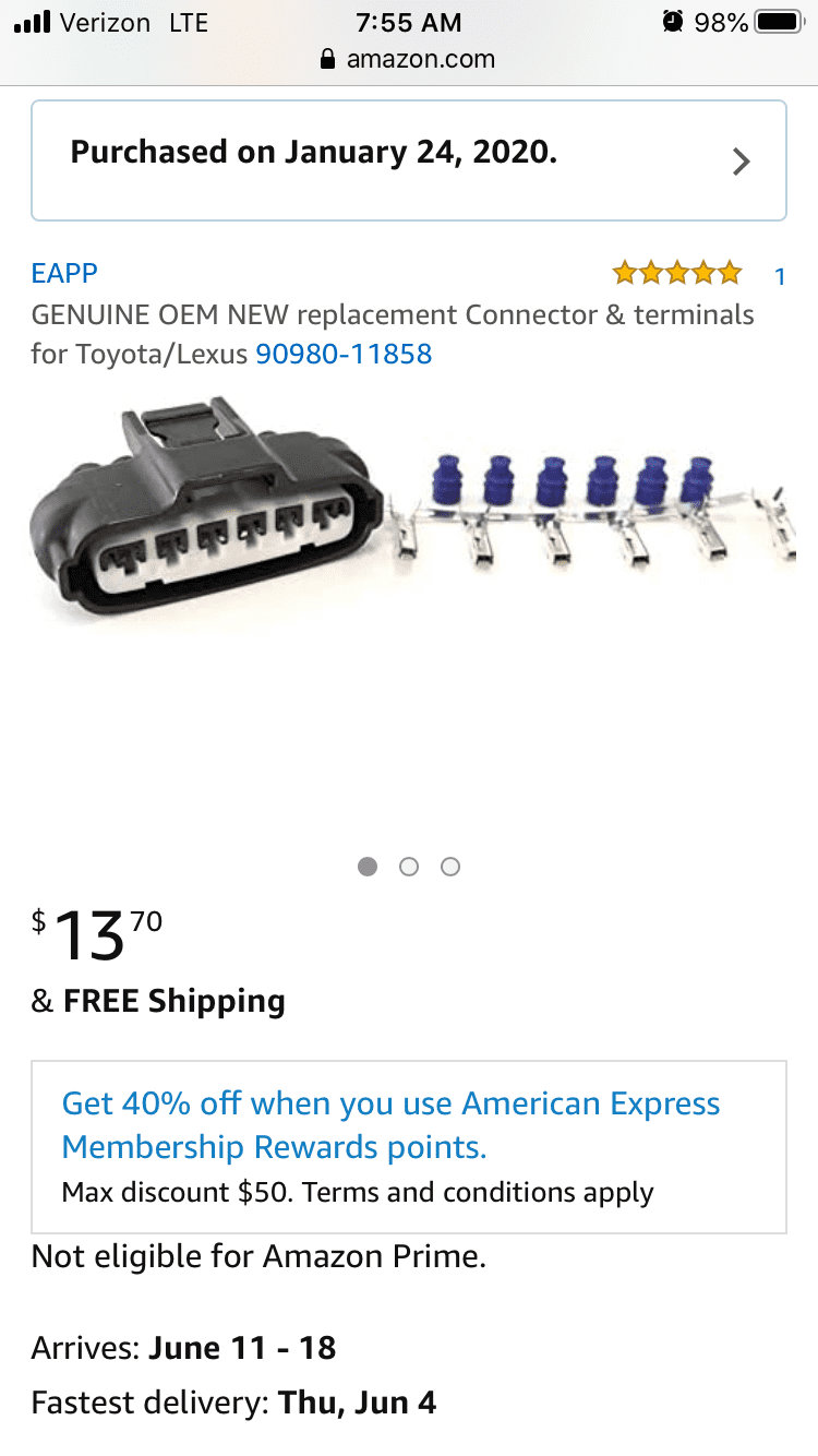

I just cleaned my Maf sensor and throttle body yesterday. I use maf sensor cleaner spray and throttle body cleaning spray.
I removed the throttle body and unplugged the electrical 8 pin connector so I could clean it more easily. When I reinstalled it and plugged the connector back in I found that I had broken the locking tab on the connector.
I ordered this and it was the correct part, and I was able to take apart the old connector, leaving all the pins intact, and just popped them into the new connector.
I ordered this hoping it is the correct connector. I’ll post back when I receive it if I remember.

Bumping old thread.
Was this part correct? The clip is broken on mine as well.
