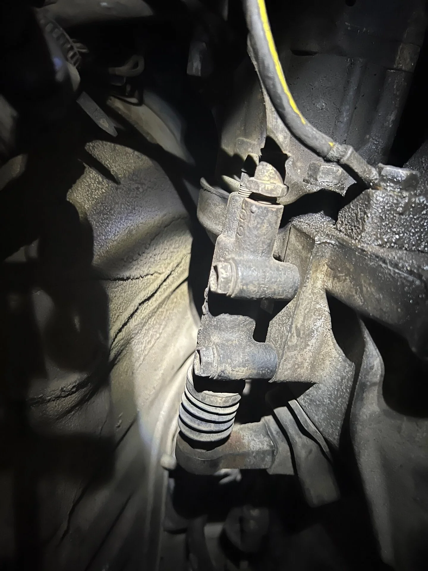

Make sure the slave cylinder rod is not tight when the clutch is not pushed in.

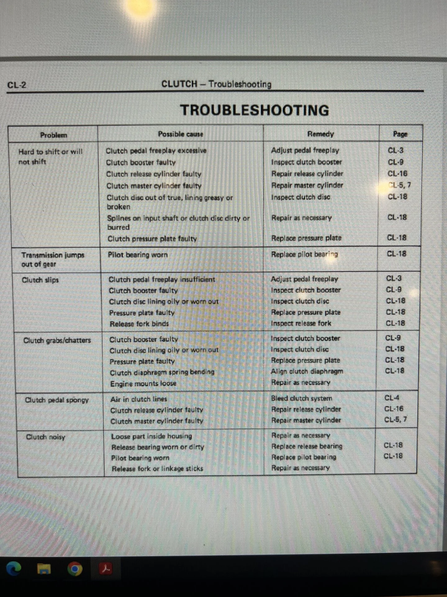

Adding this photo from the manual since it doesn’t mention anything about a clutch cover in the “inspect clutch disk” remedy. I’ll look again and also look to see if the slave rod is tight or not. Thank you. I will post back when I am able to get to my truck.

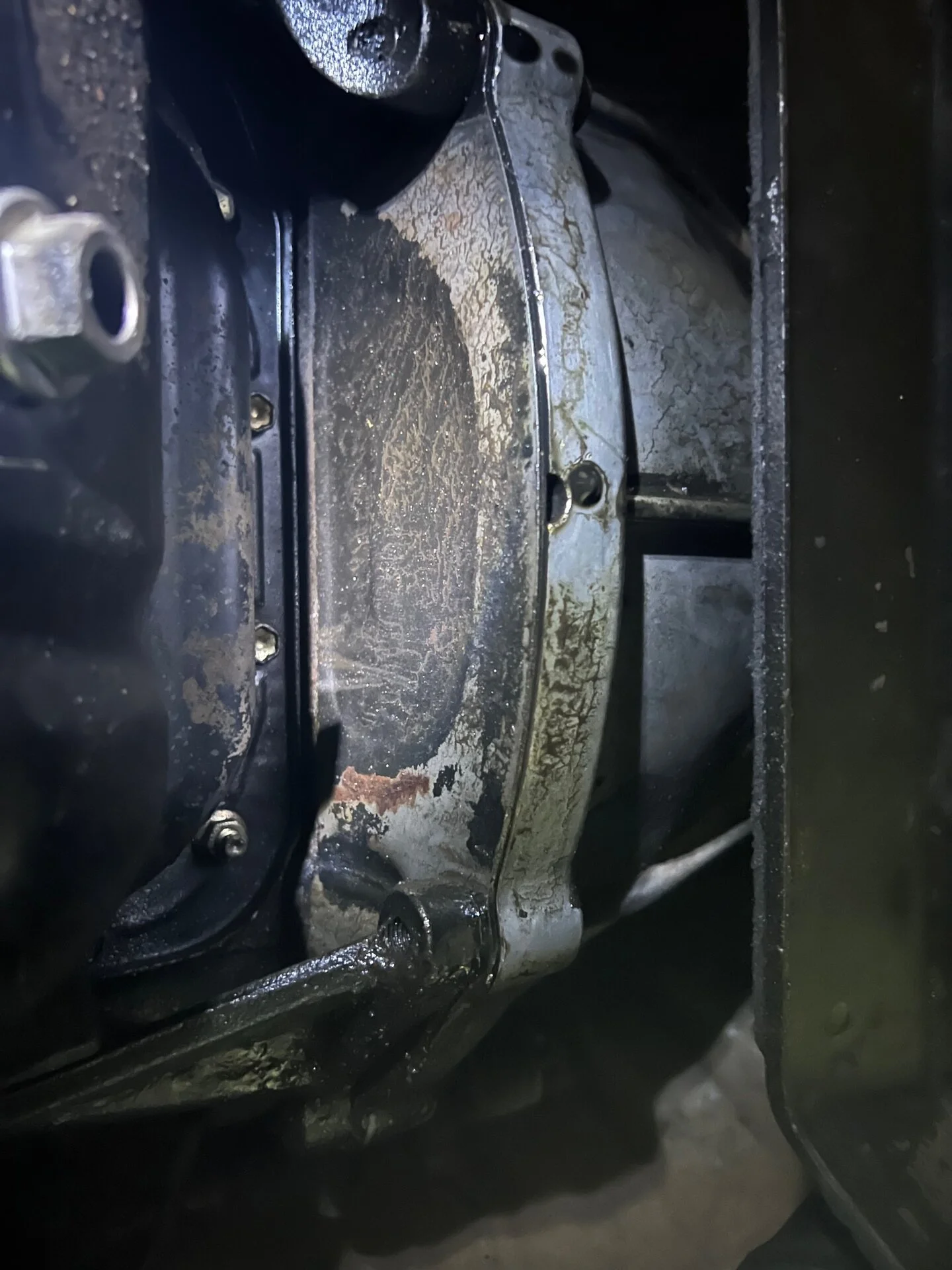

There is a big cover on the bottom of the bell housing held on with 6? 10mm headed bolts.
Just got back from vacation tonight and crawled under her. I don't see a cover under the bell housing although it does look like a bolt is missing. I will try again to look in daylight tomorrow...

Additionally, the slave arm was tight, I couldn't move the arm under the rubber boot with my hand.

Maybe the FSM will show me the way tomorrow.
That is not what I was expecting to see. That’s a different bell housing than I’ve seen. Yes I would think the FSM would help.
