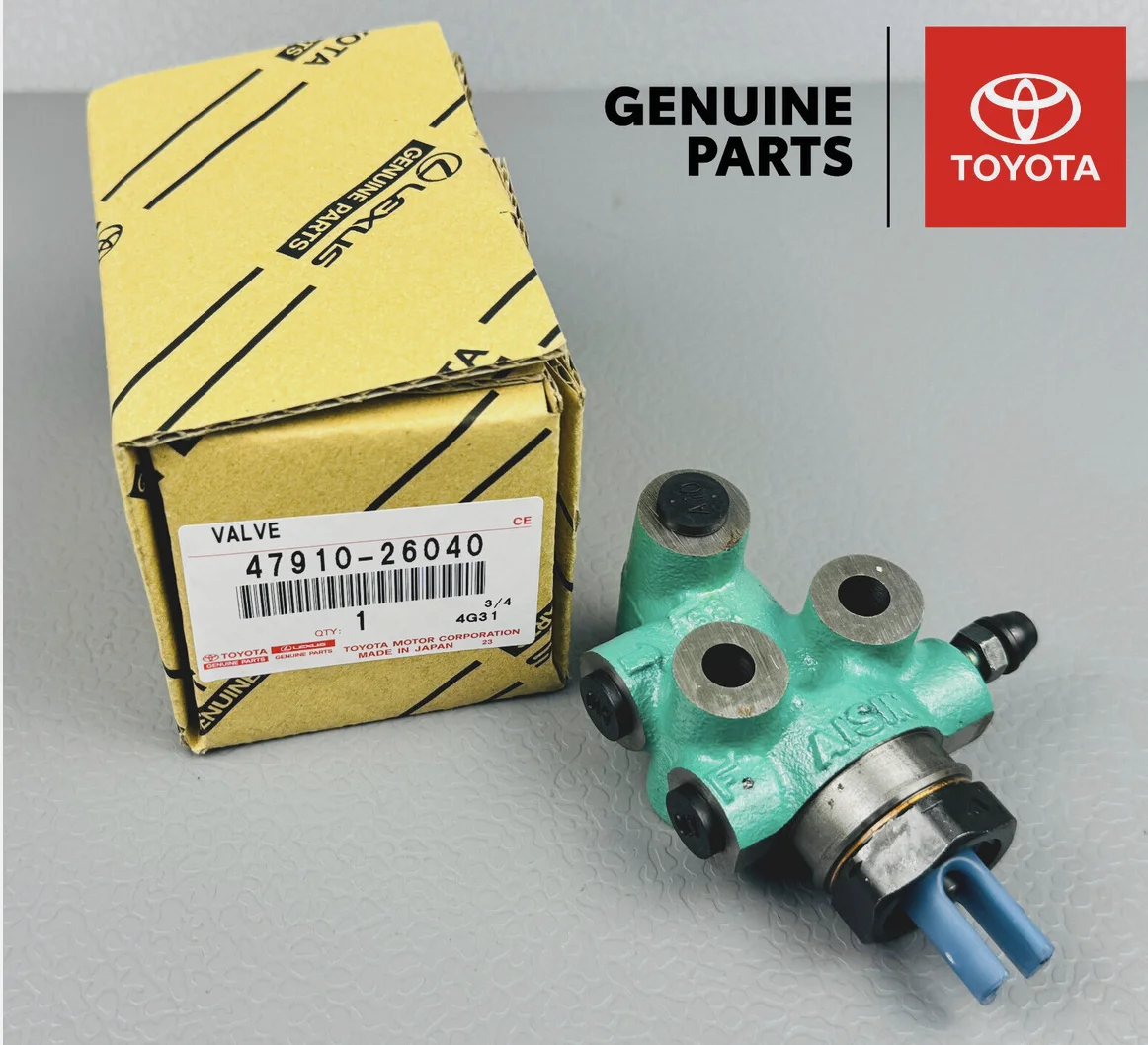

How about that Load Sensing Proportioning Valve above the rear axle? It has a bleed nipple on it too. I replaced mine but they can be dismantled and cleaned. I believe the Toyota part number is 47910-26040

I just ordered a replacement LSPV and my expectation is that this will fix the issue once and for all. After all, there is nothing left in the braking system that I have not once-overed.
OK, and update. I have replaced the LSPV and I have tied the long rod that connects to the axle to the top of the bed.

Is the pedal feel any different when you strap the LSPV rod to the axle (in the fully down position)?
If I am thinking straight, when the arm is strapped up, that simulates a huge weight load in the rear end so the lspv should send fluid or allow more pressure to go to the rear brakes. Normally, the front discs do most of the work.
This is not how the LSPV works.
When the vehicle is level (moving without braking yet), full brake goes to the rear. When during braking the vehicle sinks in on the front / rear goes up (can be simulated by lever down), the LSPV gradually sends more brake power to the front, using a bypass line.
When the vehicle is level / LSPV is full open to the rear, this (then sealed off) bypass line belongs to the front brake circuit; means: If there is air in that line, brakes feel spongy. This line can only be bled to the front, with LSPV open = lever down. It is a long line, so lots of fluid and patience is needed.
Also note that the LSPV operates by pressure to open. Bleeding devices sucking may thus not work well.
Good Luck Ralf
What would happen if I had flip flopped the two brake lines entering the LSPV? Could this be the cause of this issue?
If @Felde is correct, then I need to *not* have the LSPV tied to the bed, and instead need to have it pulled downward.
I guess the other relevant question to ask is which one of the two brake lines is the return on the LSPV and which Ray Lyne exiting the master cylinder is the return? Maybe I do have them flip-flop but I have no idea and I can’t see any documentation in the chassis manual about which is which.
