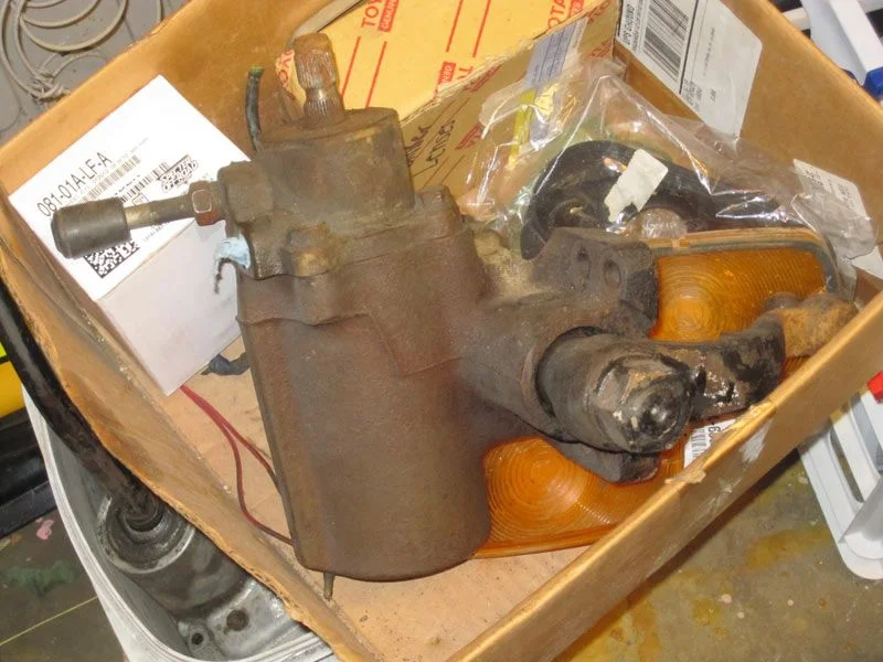

I'm slowly accumulating the parts for a mini-truck PS conversion. I got a gear box that I would like to clean up a bit. The picture makes it look less grimey than it actually is. Sandblasting would be nice, but I don't want to risk getting sand inside. Any suggestions welcome.
Parts washer or just dish soap and a scrub brush.
Simple Green from Home Depot. Spray, scrub with old toothbrushes or old scrub brushes, rinse with hose. Works great.
Then wire brush the rust, primer, then paint.
