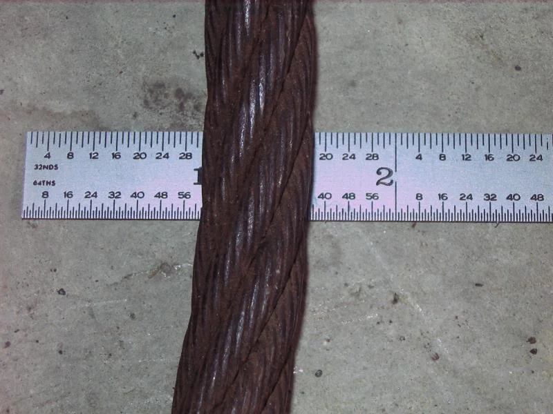

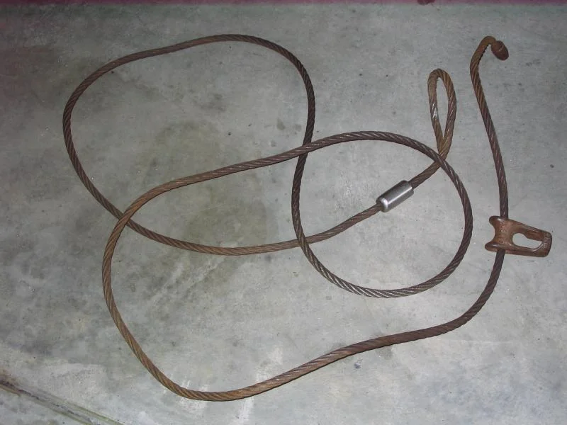

One of the benefits to living in the PNW. This little beauty was laying on a trail that I was running. It must've hopped out of the bed of some rancher's pickup and was waiting for me. It's 15 feet long, coils up nicely and fits in a drawer in back of my rig. A nice thing to have in your toolbag:
Lucky find. IMO (and I guess that of the loggers), a choker cable set-up is a lot safer and easier to use than chain. Given that it was free, I wouldn't complain about the size of cable. if I were to buy it new, I'd have a cable/logging supply place make one up for about a 15,000 lb working load (more than double what I'd likely ever need).
