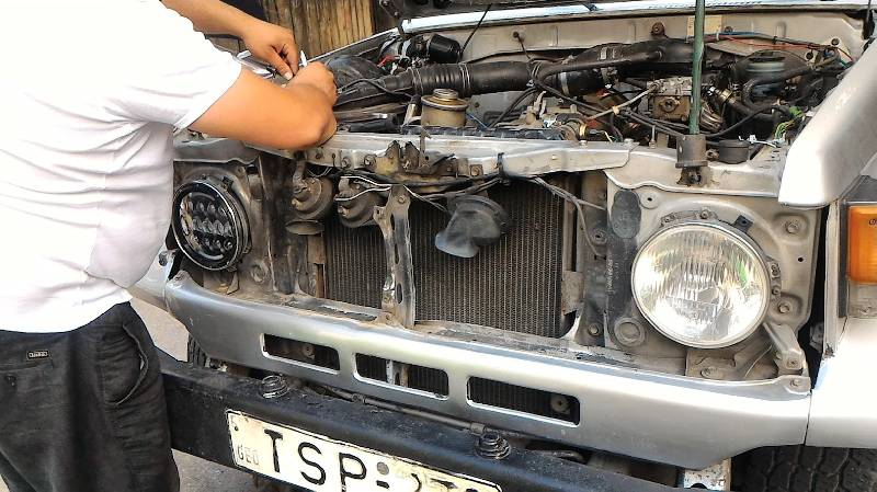

light arrived today... tonight i Will mount the new eyes to my old 73 :hillbilly:
Well, lights just installed..... I'm impressed :clap:
The light are very well made, and very bright, much better than the stock hella.
Fitment is perfect no minor modification required
If I have to find a cons the hig beam is is a little narrow... But not too much and anyway super bright.
Well they worth the money for me.
Last thing now my 73 is very aggressive :cool:
Picture to come tomorrow
Here a photo sorry for the poor quality but I've used my cell phone...
