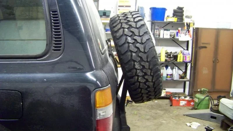

The spare even clears the carrier with no modification, though it is a tight fit. Of course, the wider tire decreases the clearance between it and the rear hatch. I haven't measured it, but I'd say that there is still a couple of inches of room.

The only problem I see with that rear tire is that if you drop off of a big enough ledge it WILL kick the tire into the window. BASH! You could mitigate the effect by installing a type of spacer block with a rubber end 2-3" thick that will hit the metal first....
The only time it ever became a big deal with my carrier was when crossing a really steep "V" notch in moab, the rear tire hit the descending wall on the way up the ascending wall and I have a dent in my hatch now because of it.
I've got a 1" spacer that I can throw on there pretty easy, but I'm going to be doing some work on the swing out soon anyway. I don't know how much everyone else's spare moves when driving, but this is a little too much for my taste. My plan is to redesign the latch (it was a quickie design anyway) and beef up a few things.
Tony
Mine is rock solid while driving- unless driving offroad. If you want some pics of the arm I can send some?
As long as the road is smooth, it's fine. But you know how some of the roads here in Iowa can be.......it doesn't flop all over the place, but if I look close, I can see it moving a little. Some pics of yours would be great. I'm fairly sure what I need to do to fix it, but I can verify with some detailed pics.

Don't worry about timeliness, I got bumped to third shift for a while, so I'm not getting anything done around home anyway.......Those gussets at the bottom are just about what I had in mind. I think that once I brace the wing to the frame and modify my latch a little I'll be golden.
