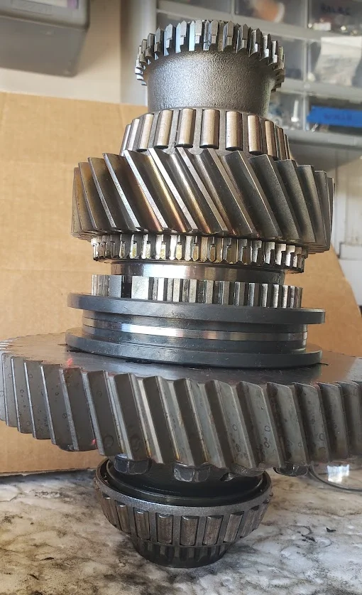

I'm regearing my transfer case, and I got the main large gear cluster all pressed back together. I'd like to know if this looks right to the hive mind, and Georg @orangefj45 if you have a moment to look at this. I still have to do the torque sequence on the bolts on the back side of the center diff.
The first photo is with the shift collar down with gravity, the second photo is with my hand holding it up.
Fire away. Hopefully I got this right. Thanks in advance.
Is the snap ring installed at the top?
Thanks, Georg.
Yes, the snap ring is installed at the top. It's well seated in its groove.
