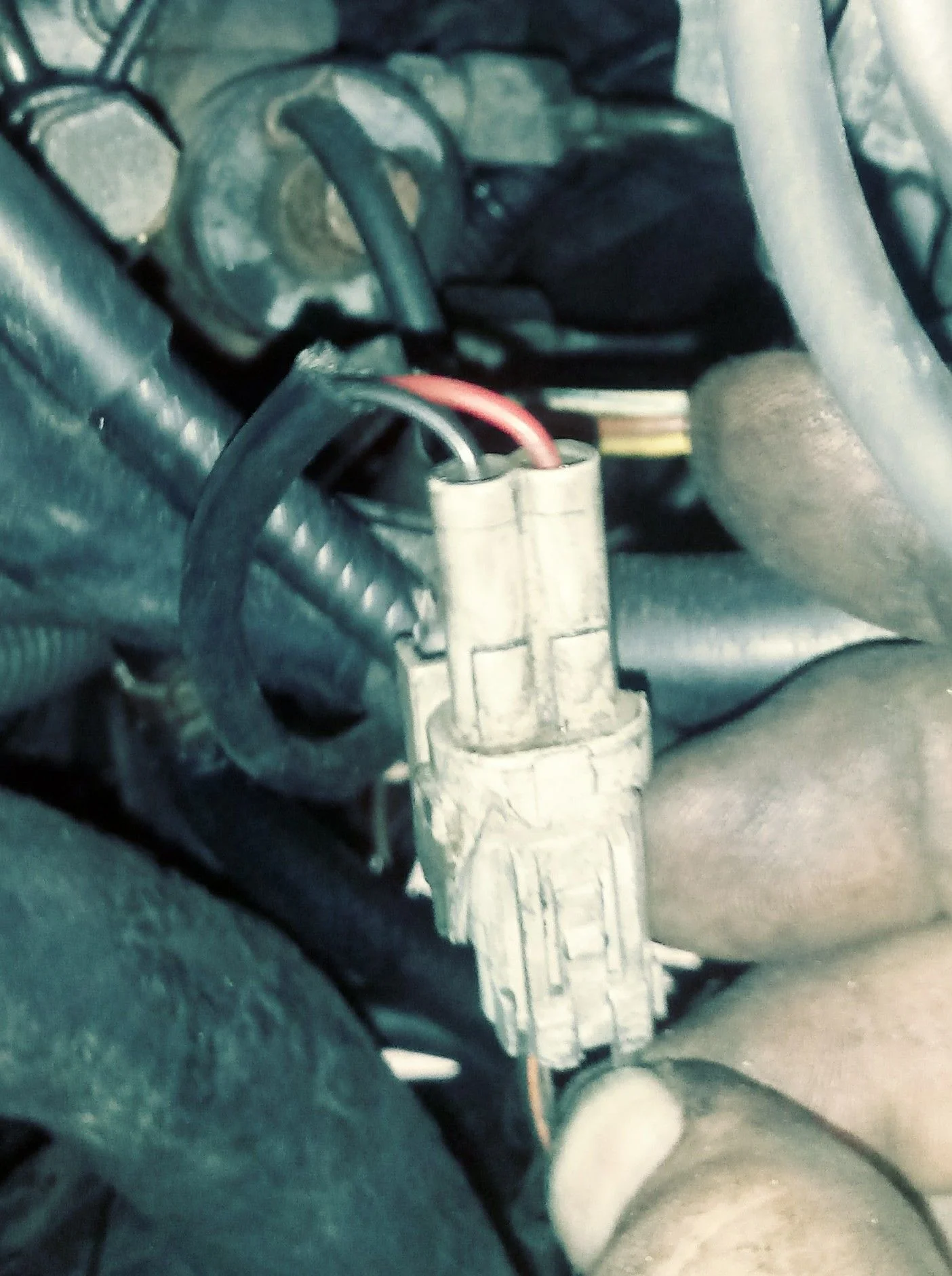

ive tested the plug at the solenoid when the cars switched totally off and key removed. im getting 12v at the black with red trace wire (with neg probe on tester to groung at battery).
Im assuming its not a bad cut off solenoid because of the constant 12v at the plug.

also as ive been reading that what I thought was a fuel cut off solenoid is called an electronic spill valve.
if this has a specific resistance from the ecu could i damage it by hot wiring it to the ign?
another thing. the wires on the spill valve plug are black and red. where they plug in the "live" wire from the loom its red with black trace. it plugs into the valves black wire.
just seems strange that the looms 'hot' side doesnt go to the valves red wire, but to the black. im sure many things have been changed on this old girl though and correct parts are hard to find
