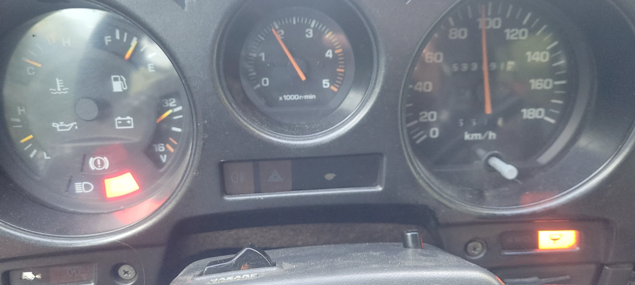

I have charging issus! FJ60 Diesel 24v system 1989.
BAttery Light and Filter Light at the Dash are on.
ITs charging over 32 V at around 2000rpm.
Charging Regulator is new. Is there a hiddn charging relay/24v somewhere at tje dash?
Thx a lot for your thoughts!!!

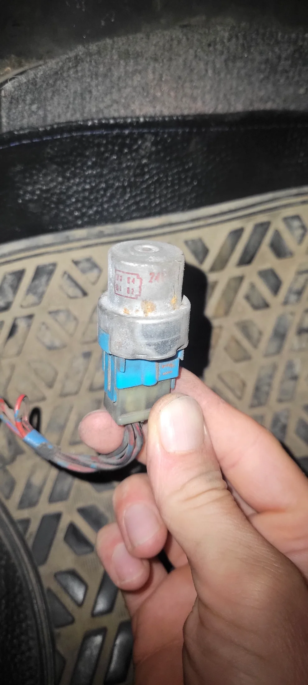

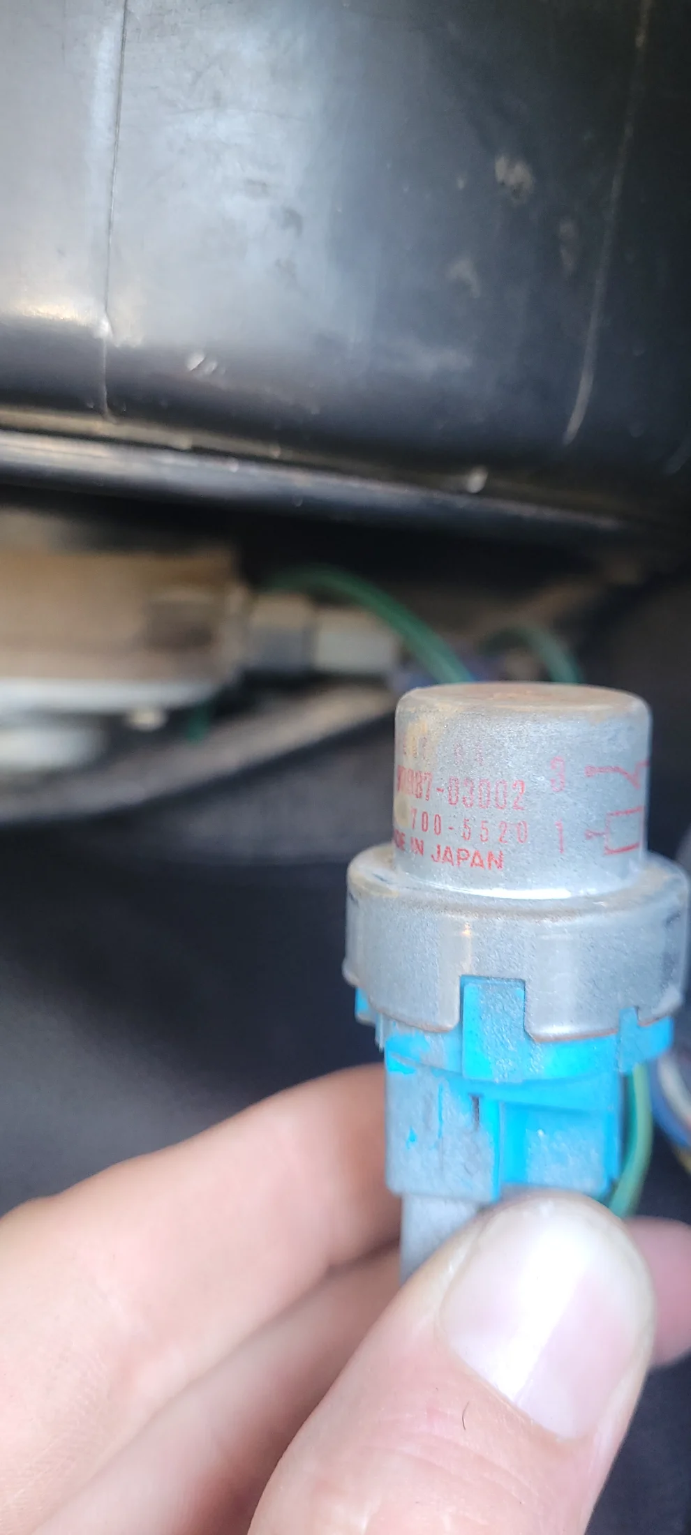

charge light relay is in the driver side kick-panel , but I think you might have a defective regulator :(
Does someone know how those one look like? I have under the dash driver side just round ones all the same. Regulator is really new ...like brsnd new...
I the kick panel to the left/ drivers side or under the paddels?
Thx so much for replying at me
yes driver side , the plastic panel left of the pedals . The relay is behind that. Its litterally written charge light relay on it 😉

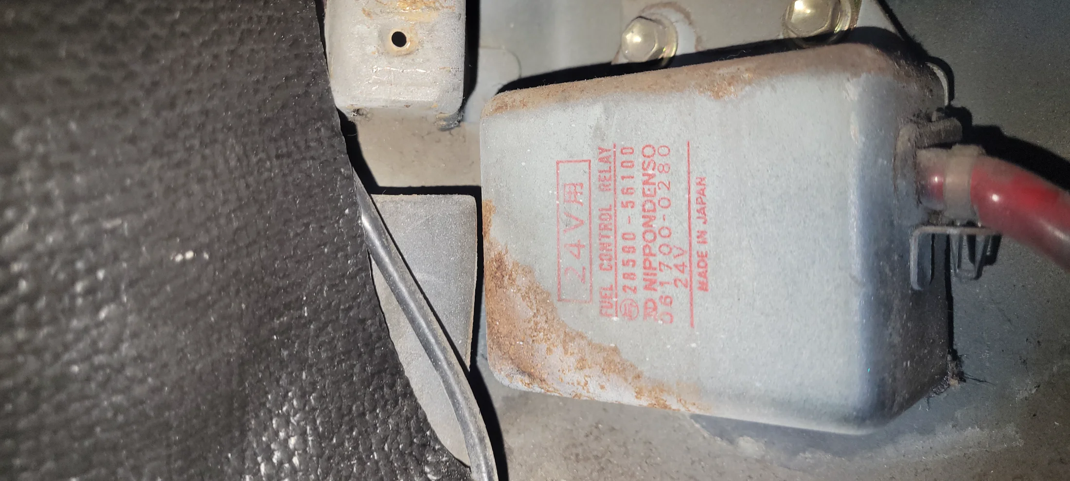

Wrong side. Look behind the right kick panel.
Mine was on this side , square black plastic written in red . May be different for a 1989, mine is a 1987

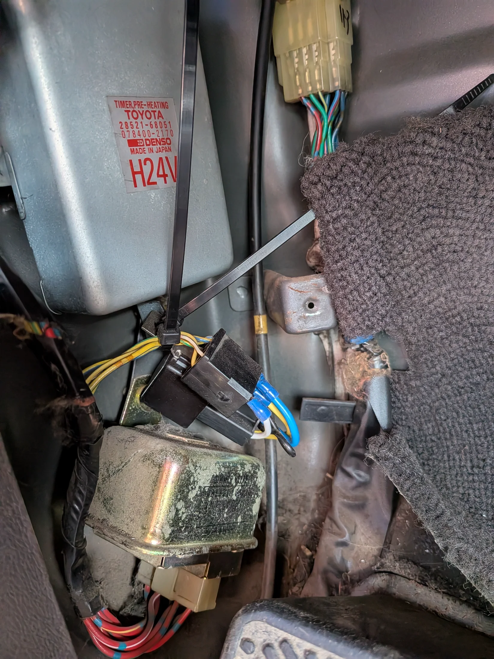

Replaced mine with a regular 24v relay ... Because the OE one failed
But the original one is like this and plug directly in there ... Can't see it on your pictures tho
