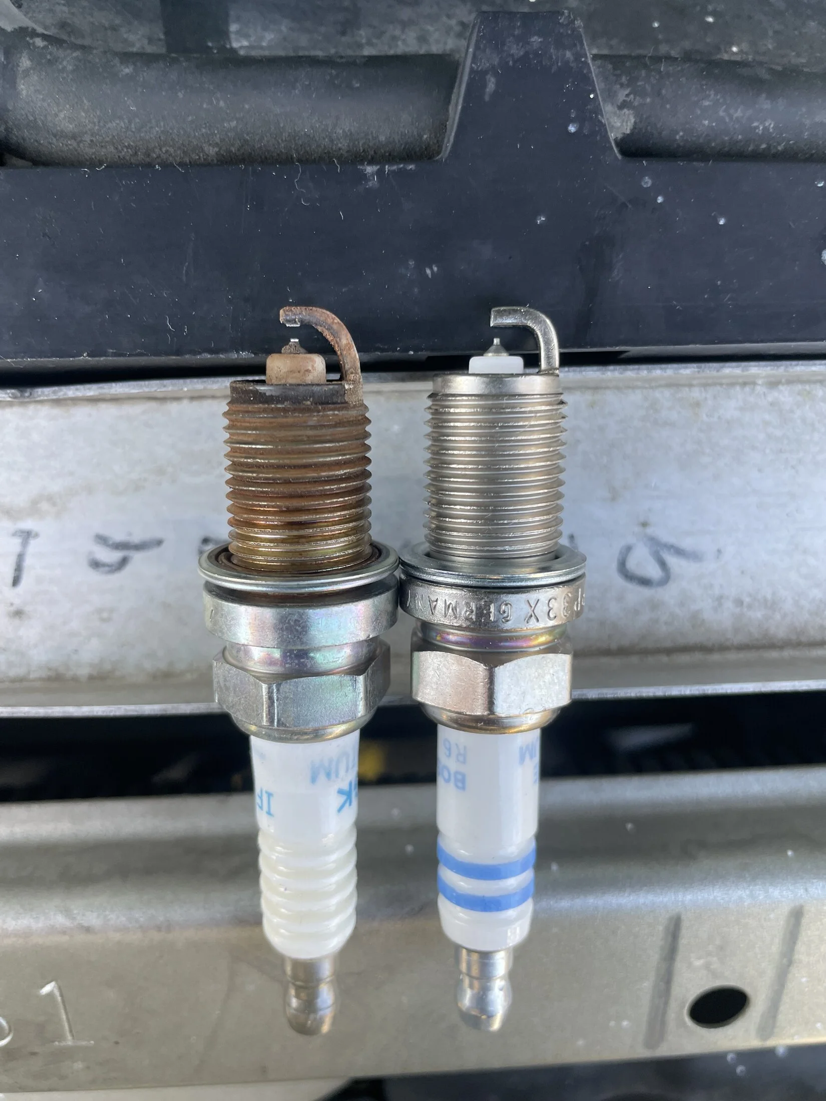

Died after running for 10 minutes. Was headed uphill and thought that a number of these times I have lost power heading uphill. Went back and made sure all my intake was nice and tight. Took the tube off the throttle body. The plate was difficult to move and has not been cleaned maybe ever. I cleaned it as well as I could in the Dillons parking lot last night and got it back to the house. After cleaning, it pulled a new code.
P0308 Misfire on Cylinder 8. This morning I replaced the spark plug and coil on cylinder 8. ODB diagnostics shows no misfire on any cylinder. MAF in correct tolerances. ODB shows all O2 sensors are functioning correctly. I really hope this is what it was. That throttle body was glued shut. Couldn’t believe she could breathe at all.
Spark plug comparison and some of the rags I used on the throttle body.
