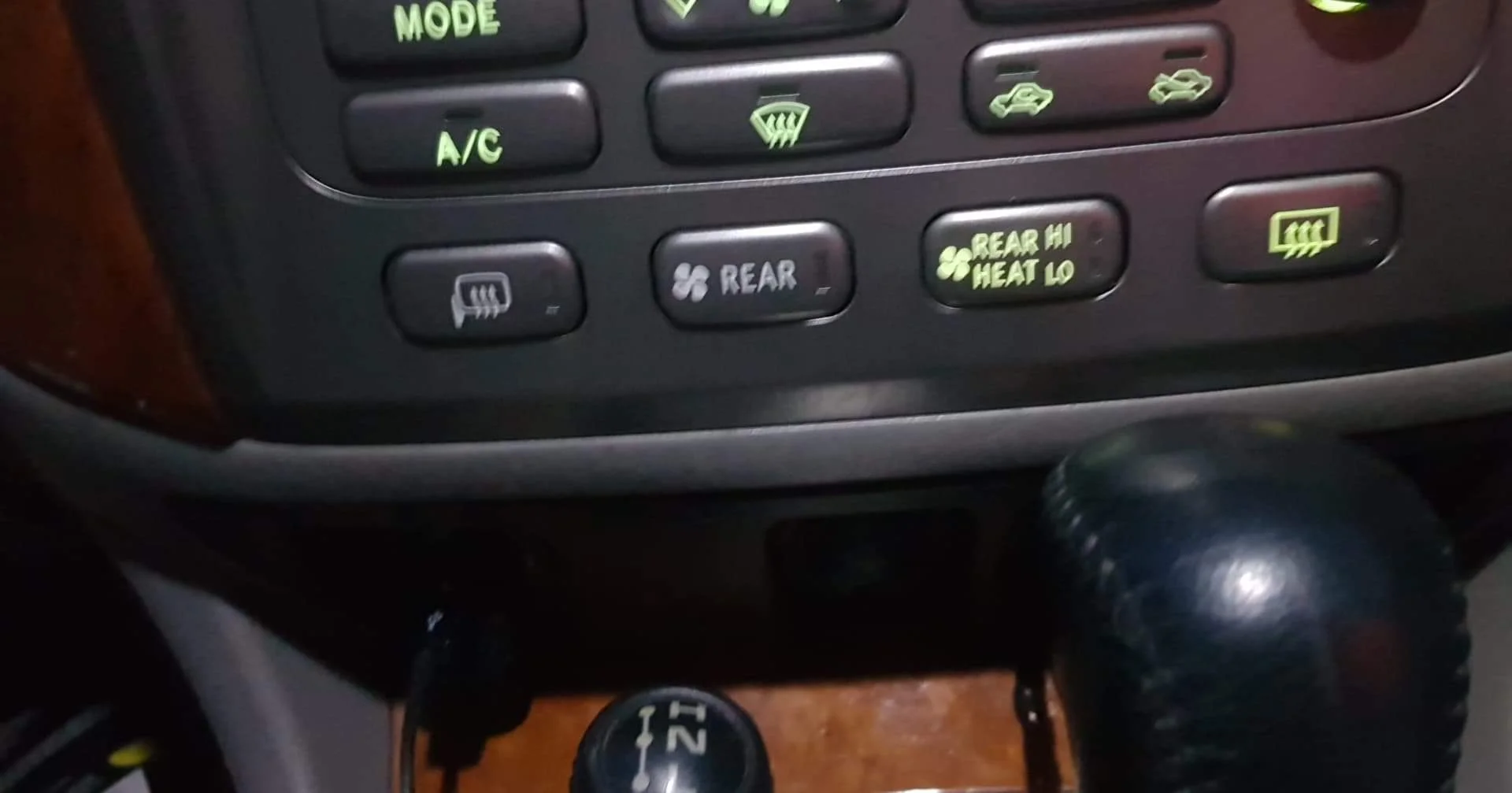

You can find some images here... I'm not sure if the bulbs are T4, but I believe there are two different sizes. I noticed you have a "REAR HEAT HI/LO" button. I've never seen that before. Mine has a blank on the button side, but the circuit board has an actual button.

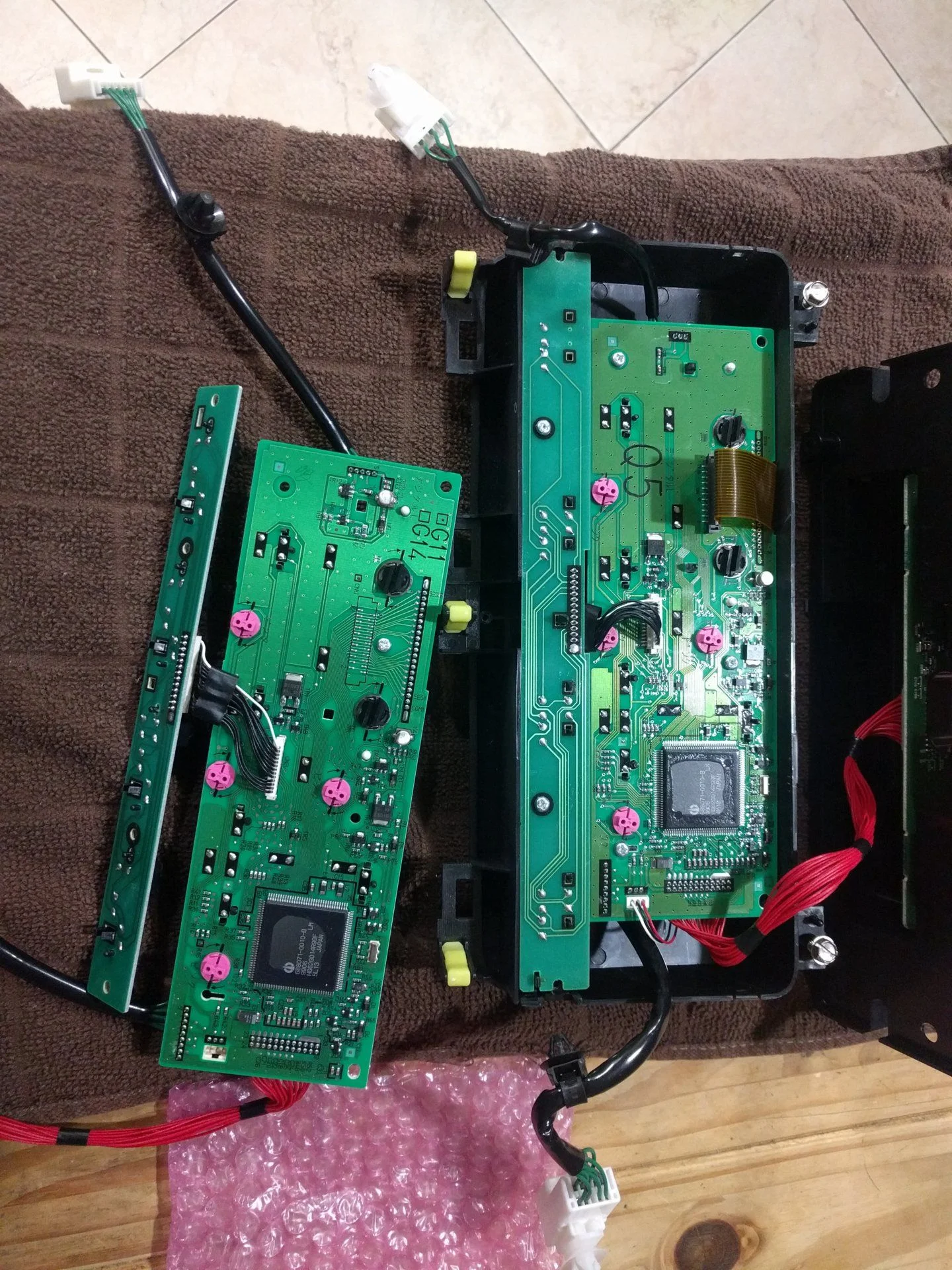

Some of the bulbs are LED's and some are twist in bulbs.
There's a thread that shows what people ordered. I can't search real well from here.
Tiny soldering tip is needed, and enough to replace them all. Newer boards have a few twist in bases but most are soldered on the board.
Cheers mate. Looks like im going to have to strip it apart. And look.
What model and year do you have? I've never seen that "rear heat hi/low" button. I have rear ac, but not heat in my 2001 LX - Canadian spec.
Kind of ironic that your 100 has rear heat in Australia and my 100 has rear air conditioning in Canada.
Bolt ons from lx470 wreck.
Comes standard with dual zone aircon.
Pretty easy to bolt on rear heat.
Out of a lx470
