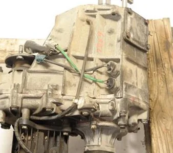

You have two switches on the transfer case that tell the ECU what position the transfer's shift rails are in (green and black sheathing, respectively in image below). The one indicating you have locked the center diff has failed in yours. The other one tells when the transfer is in neutral. They are the same mechanical switch, with different connectors. The switches themselves are used in tons of Toyota trucks and they are common failures. The connector or pigtail is all that changes. Go ahead and replace both while you're up there.
These numbers are for an '06, but this gives you an idea of what you're looking for.
