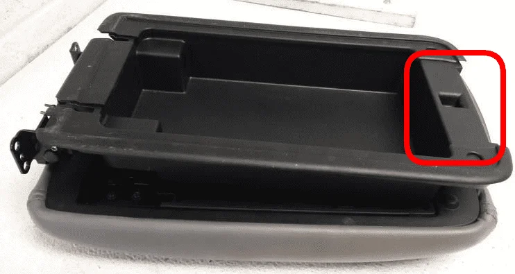

I believe what I needed is the same part (blue box in picture) as well as the top pocket that this part latches into (area in red box was damaged in my vehicle from PO using self adhesive velcro and someone removing this and scraping off the glue). Since neither part is available for purchase, I found a seller on eBay who was parting out a nice '06 LX. The pictures are from the listing. The color matches my interior, so this is an easy swap. As shown was about $160 shipped, but much cheaper than just buying the lid which IS still available and would have fixed the latch. I had considered that a few times since I bought the truck, but I would have still had the issue with the box being damaged. Although not cheap, it is worth it to me for an '06 with good interior. The PO or selling dealer had fixed it so it was functional by screwing a piece of plastic with a replacement latch to the bottom of the mechanism. It was a little peculiar and didn't allow the lid to sit all the way down. It was not really noticeable, and I could have lived with it as I have for the last 3 years, but with parts becoming harder and harder to come by and my desire to have this truck for a long time (only 150k), I decided to take care of this.

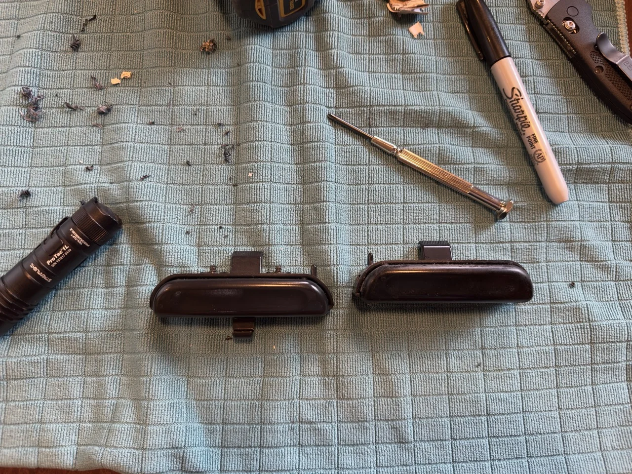

Here are the two parts. Camry latch on left. Broken Landcruiser latch on the right. The indexing pins are on opposite sides. Otherwise, they're identical. (Actually, the LC part seems to have slightly longer screws but that didn't seem make any difference to the install.)

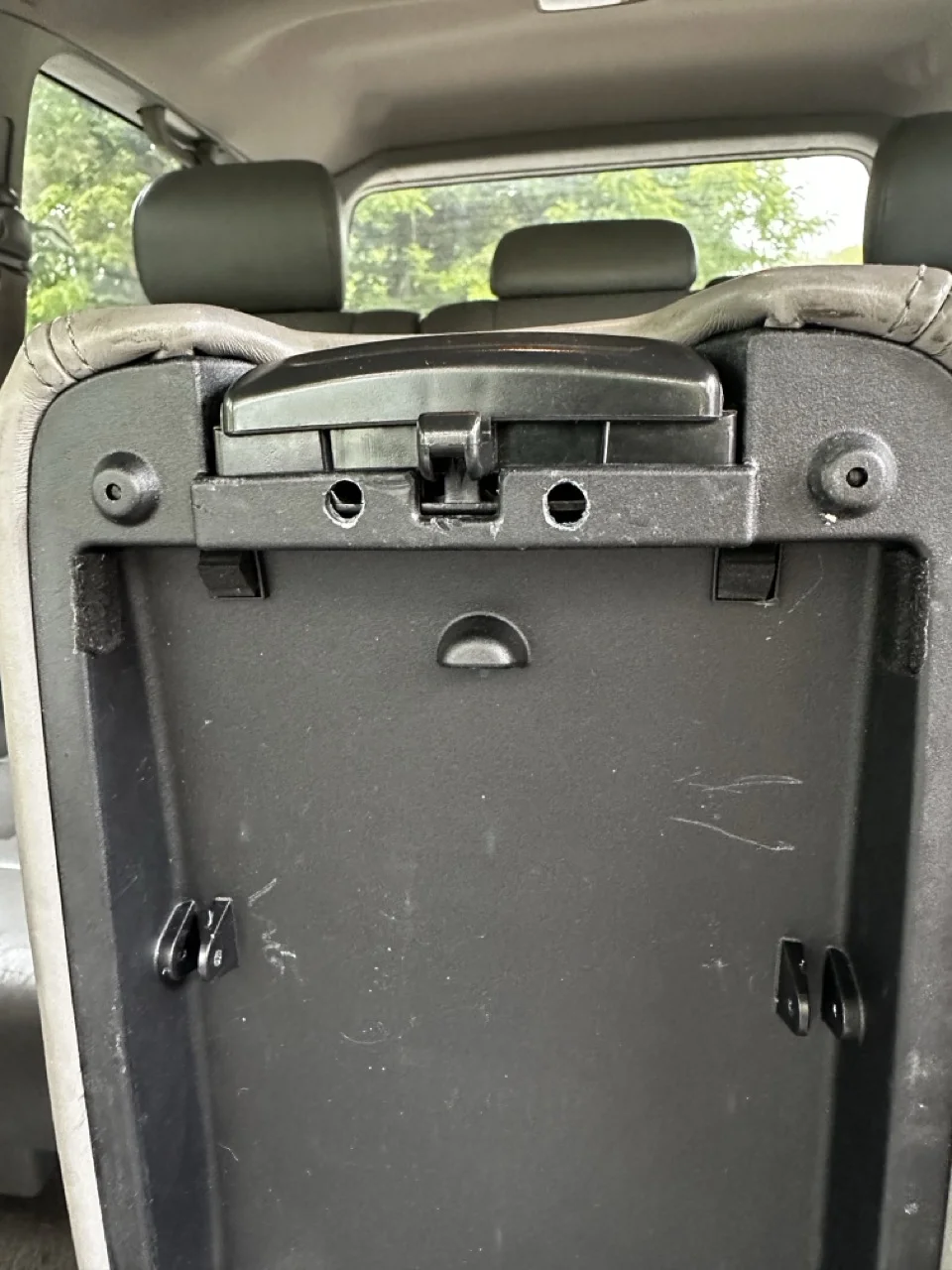

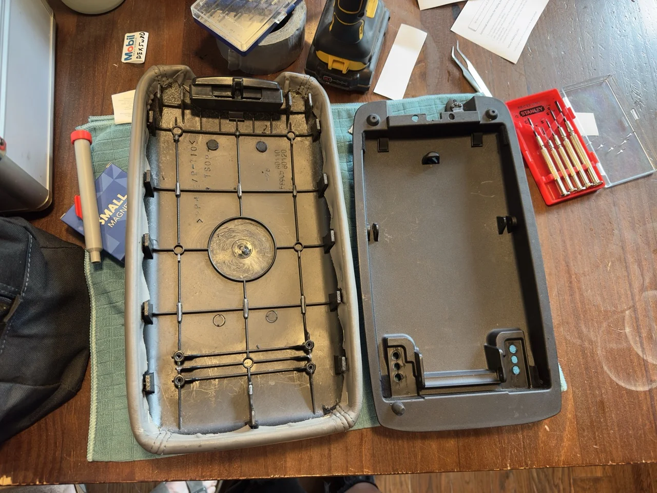

I drilled out two holes in the inner lid to access the screws. This was a wasted step; I had to separate the inner lid from the outer leather lid anyway to get the new part in.
Outer lid on the left and inner lid on the right. In this photo I've already installed the new latch. You can also see the two holes I drilled in the inner lid (at the top of the part on the right) to access the screws. I didn't actually need to do that.

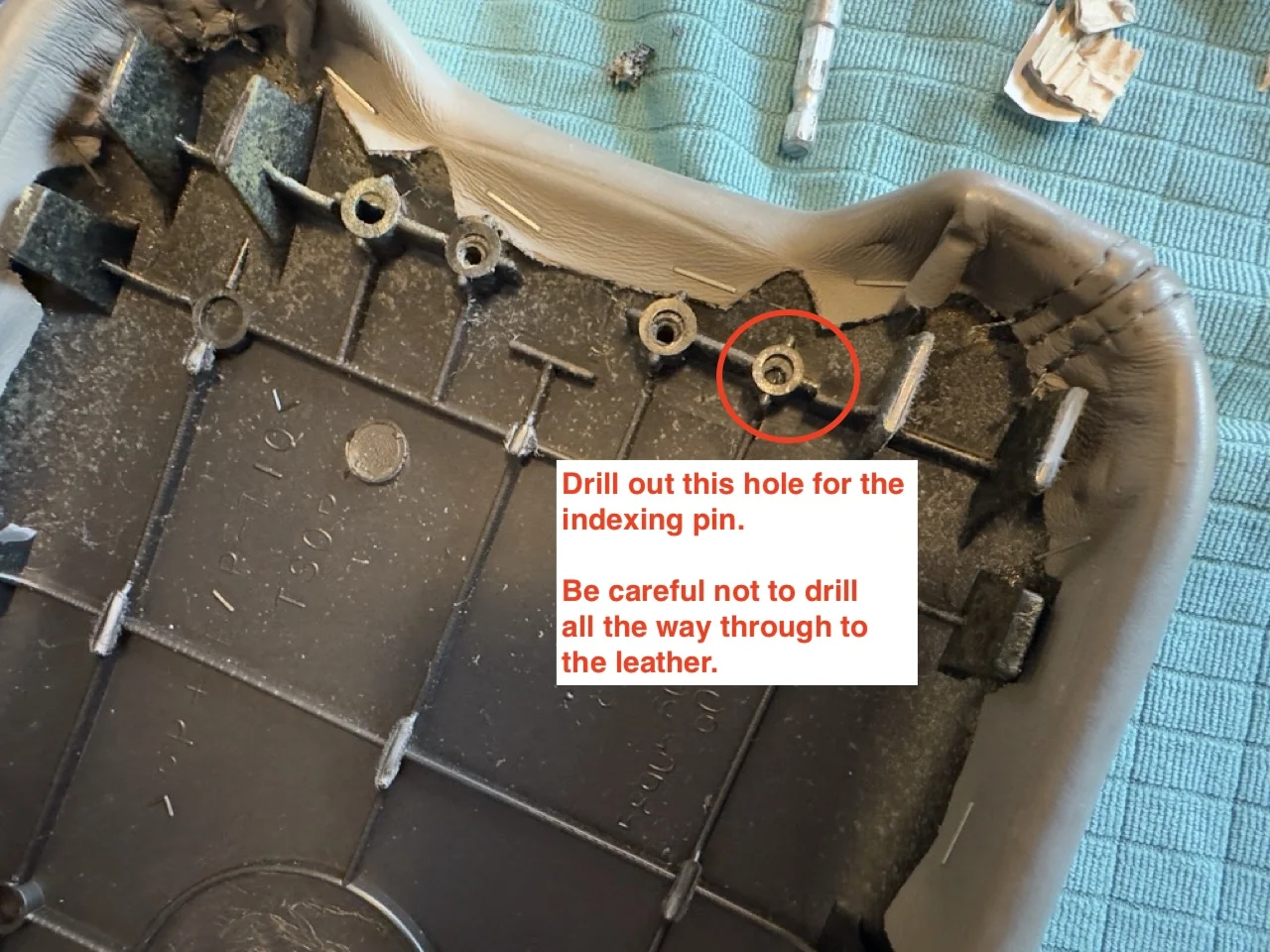

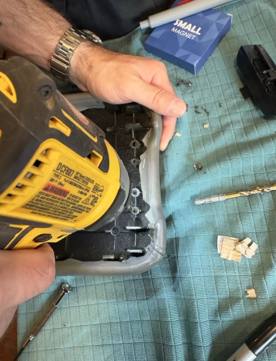

Drill out the right-most hole for the Camry latch's indexing pin.
New used part installed. It's not quite as good as new, but it basically works perfectly.
