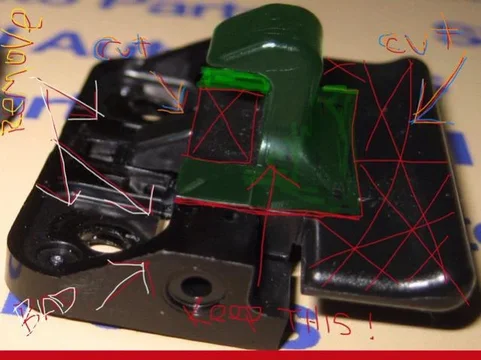

The next step is definitely the hardest. The new cheap piece of plastic has to be cut and ground or sanded down to fit into the space where the old latch once was. Here is an instructional photo straight out of the FSM showing the shape the latch needs to be in order to fit.
Highly intelligent imagery of said latch...
You will also need to cut a groove in the bottom of your new latch. This groove has to be as wide as the hook itself and just deep enough to allow the new latch piece to slide freely as the button on the lid is pressed. Once this finagled mess is fully functional, all you have to do is attach the new piece. I used a tiny drill bit to make guide holes and then used tiny screws to secure the latch. I'm sure some epoxy would also do the trick, or a combination of both for that long lasting durability your Lexus should have offered in the first place. Here's is also a picture of the finished product. Works like new!!!

Thanks for this thread. I found the Camry latch on Ebay and then had to drill and dremel so I could access the screws better and screw it into my existing center console top. Not as hard as I thought. I could probably work on my dremel and drill skills :-).

I just did this with a console lid from a donor vehicle and yes you can dremel out the holes so you can access the screws better and what not but also...the console pops off the lid easily and while it is bonded - the screws in the front and the back hold it on as well. You can then access the side of the latch and pry the front piece out giving ample access to the screws. Don't lose the little spring that makes it pop back out. Then just slide it all back together - no dremel required. Took about 30 minutes but it's all perfect.
