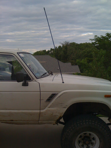

As for the coax cable, my cable came with one end not soldered on so I could fit it through grommets. I used the grommet that the stock antenna cable came out of and soldered the end on inside the cab.

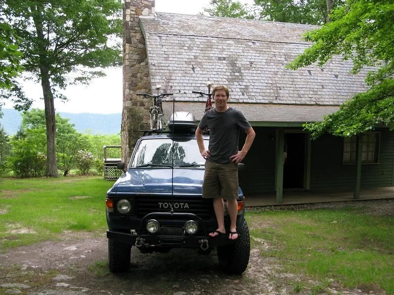

on the front bumper...just got a pipe hanger from lowes and attached a little bracket for the antenna to mount to. had to get the grounding right...use an SWR meter to check it out.

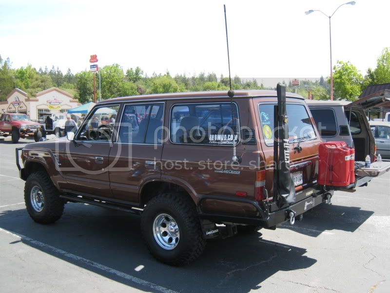

For the antenna mount I just made and welded on my own mount (on my recently new made bumper) and as for the antenna and spring I just used a heavy duty spring with a fire stick and it works awsome

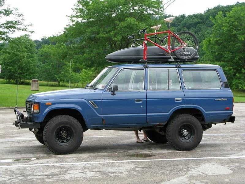

Most people mount the antenna on the front or rear bumper, somewhere, and run the cable through the firewall, or other access hole. I ran mine on the front and cable through a hole I drilled in the firewall, to separate the cable from other electromagnetic interference, but it's really a poor choice if you're after any kind of distance for transmitting.
Best spot is a magnetic-base antenna on the center, top of the roof. Most times, now, I'll just slap on a Wilson 1000 and run the cable through the window. With that, I can get miles of dx/tx in the mountains. With the bumper setup, it's really line-of-sight for a mile, maybe, with a standard radio.
However, bumper mounting with SWR and other parameters optimized it's still plenty good for trail running. Trouble obviously, with the roof mount is it hits everything...
