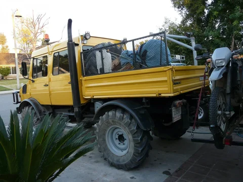

My dad used these back in the day with his fj40 and his trails bike (first pic)
Or you might look into one of these (second pic)

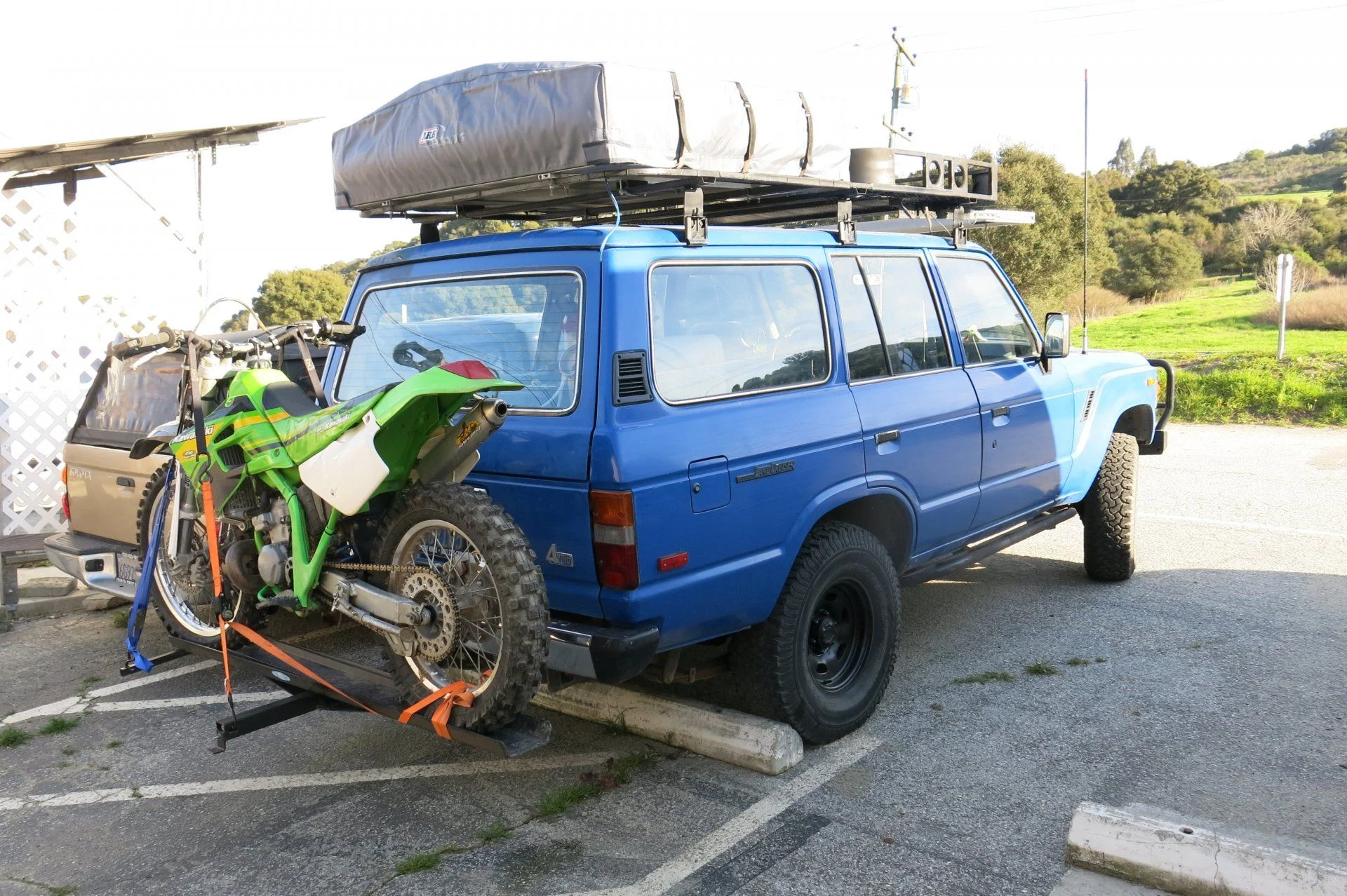

Gonna have to retract my earlier statement. I used the same hitch mount moto carrier with my KDX220 and it has no problems. Just had to try it and see. Course it weighs a lot less than what the DRZ did. Pic. below.
I now use 2 ratchet straps to the footpegs and it really holds the bike steady.
