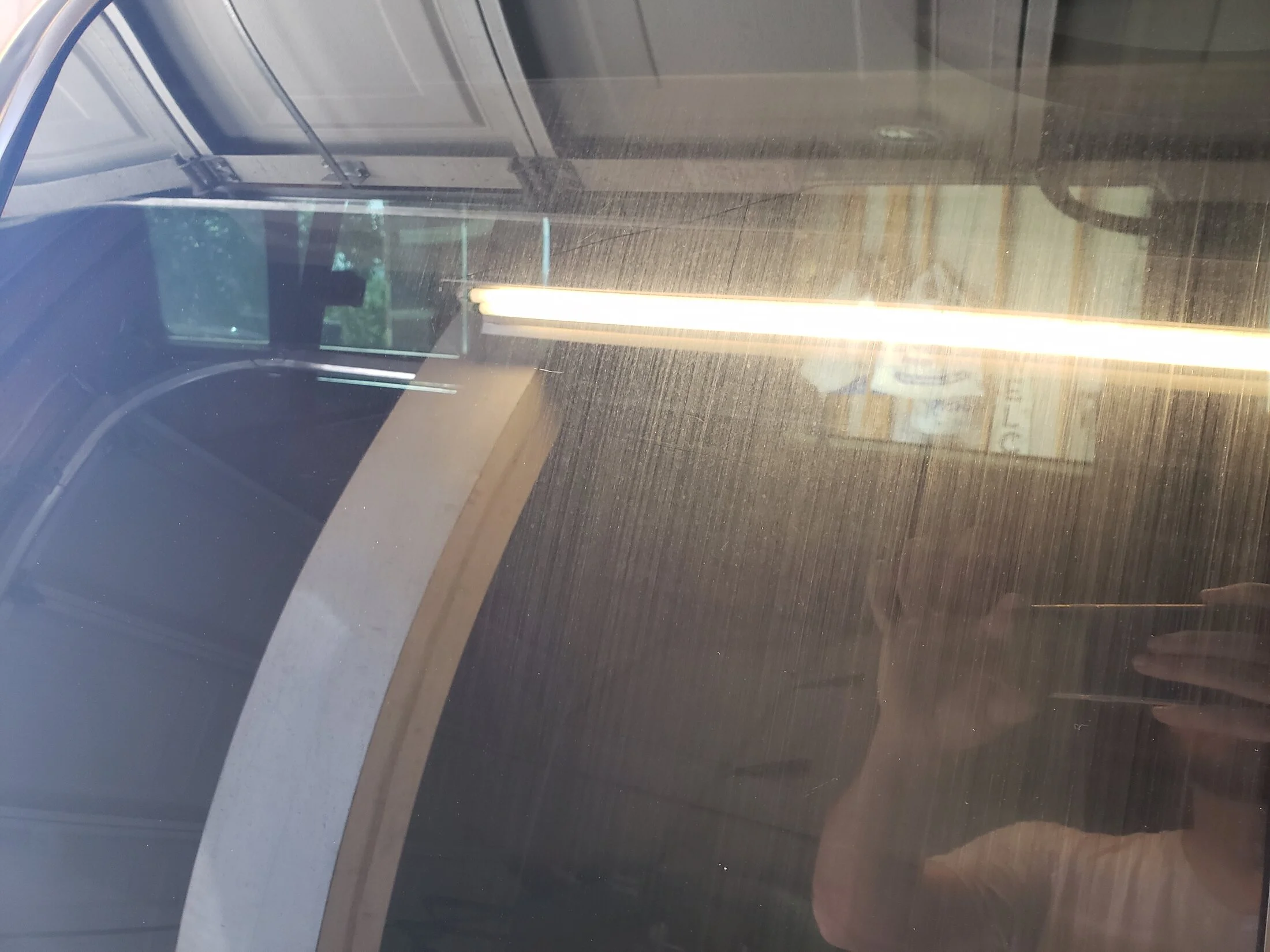

Really impressed by this stuff! I tested it on my old F-150 today, because I didn't want to wreck my Lexus' windows if this was junk... well, it isn't! These windows are much worse than the Lexus', too, so a better test.
The Ceriglass kit contains glass polish, a small polishing pad, and a towel ($18). I'm well-seasoned with polishers, so I also bought their glass polishing orbital pad ($6). It all worked beautifully! The pad is thin, so it's hard to control, but it makes the job a lot faster. The small manual pad is also necessary for the edges. It couldn't get the deeper scratches out, but it's likely that nothing will. Look at this difference!
Before - this is freshly washed!

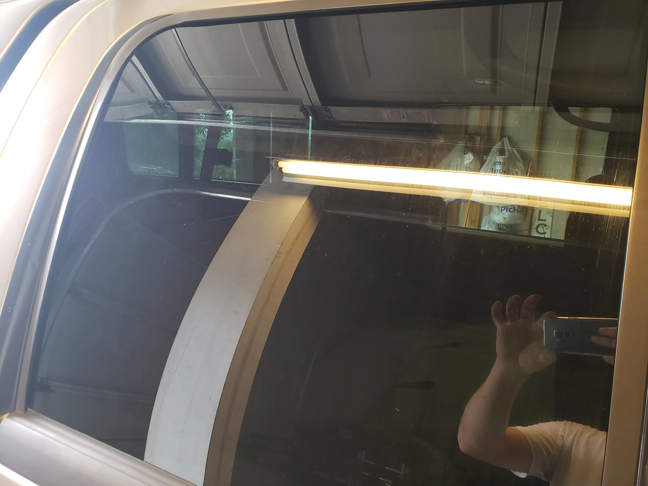

After
Test: passed. I'll be doing the windows in the Lexus real soon.
