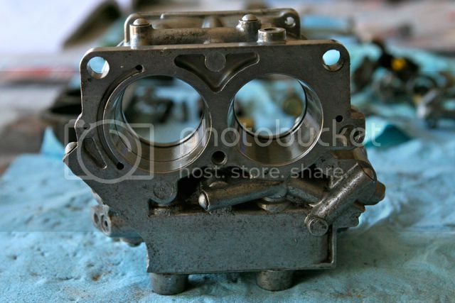

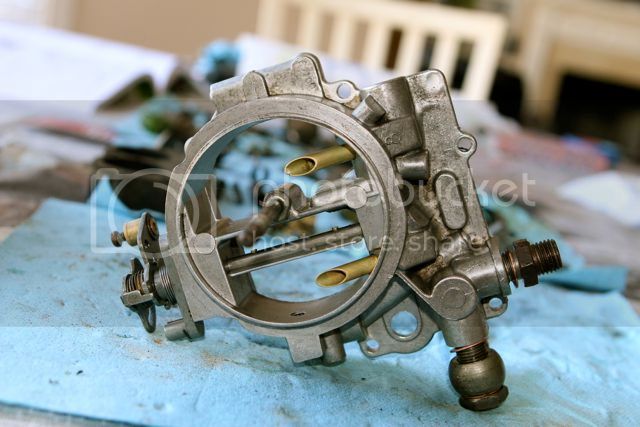

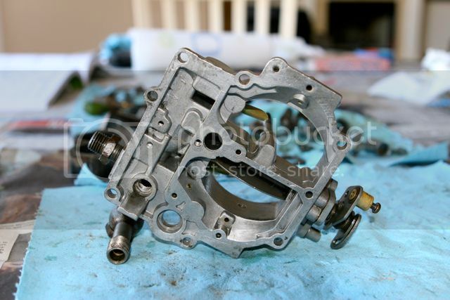

Needless to say, it was fun cleaning, soaking, scrubbing, soaking some more, scrubbing some more, soak, scrub...gets me to this point. The pile o'parts, it cleaned up pretty well considering the start...

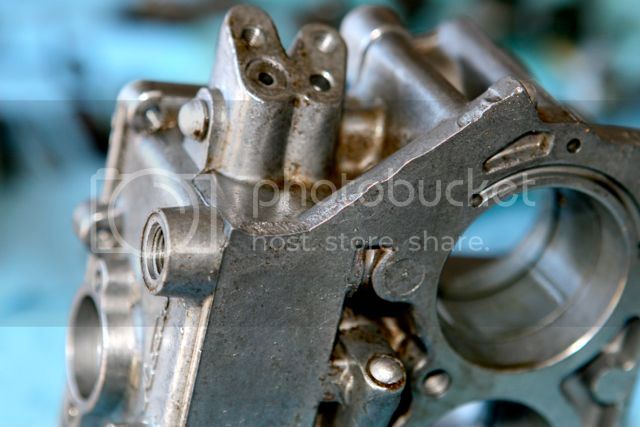

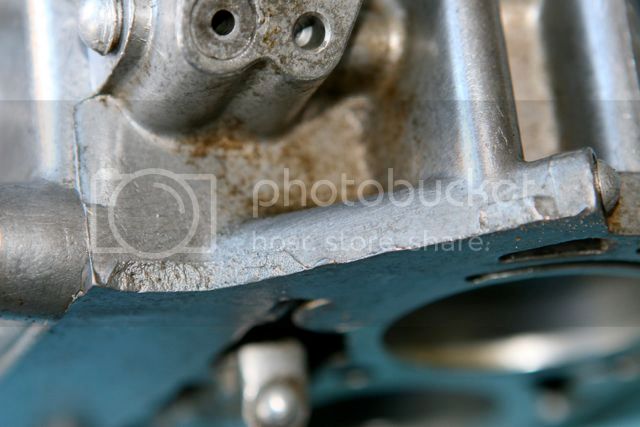

Can't decide if this is a casting flaw or someone was having a hard time removing it before me...

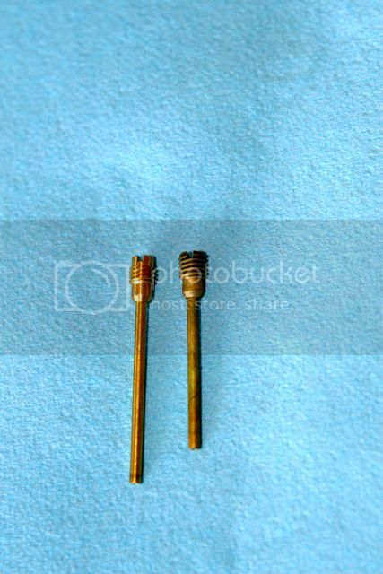

So, everything is going fine until step 3 in the FSM, install the 1st "slow jet". Its not the same length...
Like WTF? So, then the search begins on ih8mud to find the answer. I've read through so many carb rebuild threads, my head is spinning. So many posts that jets can be found at the local dealer, Spector but not by me. I can't even find the part number for the "slow jets".
Best part of all is the ONE that needs to be replace is this oddball. Its clearly plugged. I've let it soak overnight in the carb dip but can't get it to clear. I'm ready to try and push something through but wish I had a back up in case my usual bad luck rears its head and I wind up boring a HUGE hole in the jet.

JimC just replied on the thread I posted in the 60 forum. Says it reman junk, 77 era parts. Kind of explains why things didn't match up.
Hurts to find I've been mislead (again) by the PO, phawk me...
