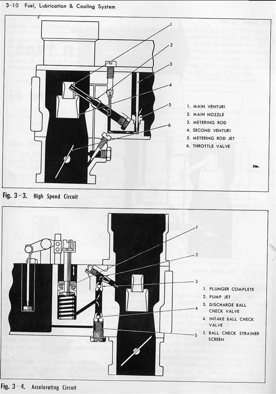

Does it move freely without fuel vs. with fuel or is there any difference? No flow out means no go if that is the case.
That's a good point. I suppose if the chamber was filled with fuel and the accelerating circuit passage (or check ball valve or pump jet) was plugged (hard to clean because of angles)....
