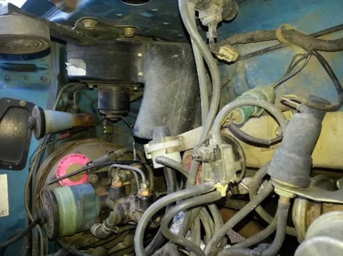

Also, hey Kline- why is it your drivers side fender is without clutter like mine. Check out this pic. Are you desmogged?

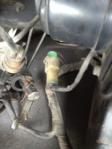

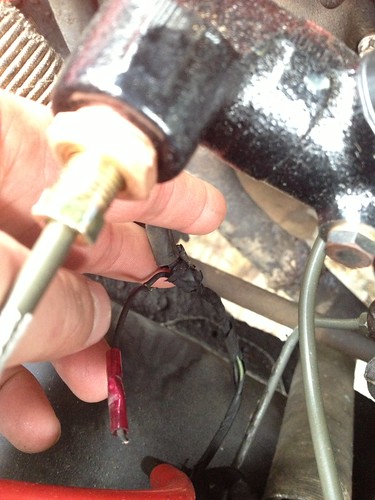

Ok so I just took a stab at this because I am having hot start issues. I remembered there being a random wire that was hanging off of the loom that Dan's connectors are connected too (I have the same connectors). It was busted off and I had not clue where it went. Well with Kline's pics I found the sensor under the carb and sure enough it looked like Dan's pic, ring terminal still connected just wire busted off.
Only wire I had at the house that was not speaker wire was 12AWG (believe original is 16 or 18) so I added a new ring connector and then ran to the pic below where the wire is coming out of the loom.

As you can see it looks like it was spliced once before so hopefully the wire is not toast. I started her up for a few minutes and let it run but nothing happened. Gonna make a run around the neighborhood and see what happens.
For those that need to know, the nut the holds the ring terminal to the sensor is 7mm.

SHE'S ALIVE!!!! Carb fan now turns on when engine is shut down.

A couple posts up above (sorry, android app doesn't indicate post numbers) I posted some pics of my smogged set up of my driver side innrer fenderwell. Can you tell from there? If not let me know, I'm willing to snap some more to eradicate my issue...
cant tell from your pics Dan.... follow the loom that is coming out of the the connectors and going along the fender/wheel well towards the front of the vehicle. I should split pretty quickly and go towards the Fuel Cut Solenoid. That loom that goes to the fuel cut solenoid is where mine was coming out of..
oh and mine is an 85 so dont know if things changed somewhere along the way.
LOL.. yes there is... it is my redneck desmog fix for the extra exhaust section that comes out to the emissions stuff. I know I need to lop that bitch off and weld it shut but just haven't gotten around to dropping that yet.

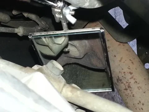

Danny, I'm with you in smogness -- there is no room to maneuver around there. Had to make videos dangling my phone down under the manifold to find the temp sensor connection. If my wire is indeed "the" wire, I'll take some more pics of the wiring loom/s if it would help to find yours. My PO or PPO had done some funky stereo wiring, which I'm still trying to figure-out. Still, gotta focus on getting "The Dump Truck" (what my 4 y/o daughter decided to name it) running better before I delve into luxuries like a stereo.
