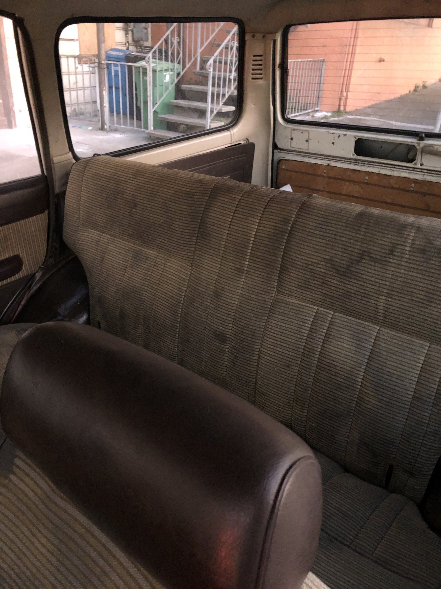

I’ve tackled a few nasty seats like that. One with a hot water power wash, and another by taking the seat cover off the frame and running it through the washing machine.
A new adventure awaits you!
As for that back seat back, it can be cleaned rather easily to look almost like new if you've got a strong wet-dry shop vac available. I got a second bench that I purchased that looked almost like yours and after scrubbing it with soap and water with a brush and vacuuming the fabric as I went along, slowly but surely it looked sparkly clean again. I was amazed. I used Bronner's peppermint Castile soap and water and a scrub brush and worked a small area at a time. Gets tedious- but you CAN clean it up to look nice. Same technique works well for the headliner too, just be gentler with the brush.

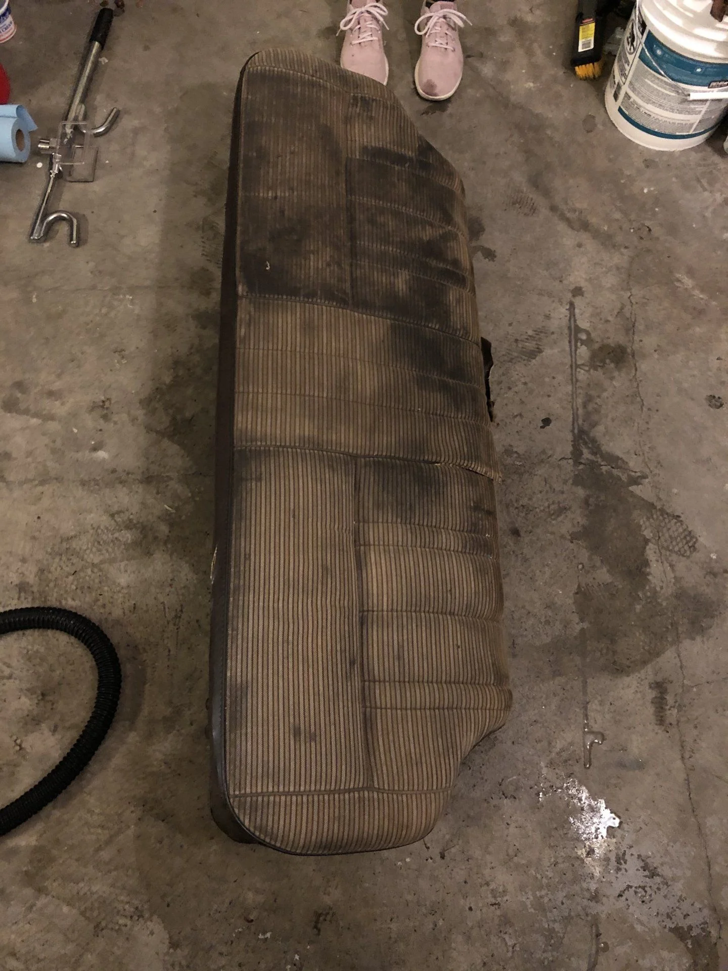

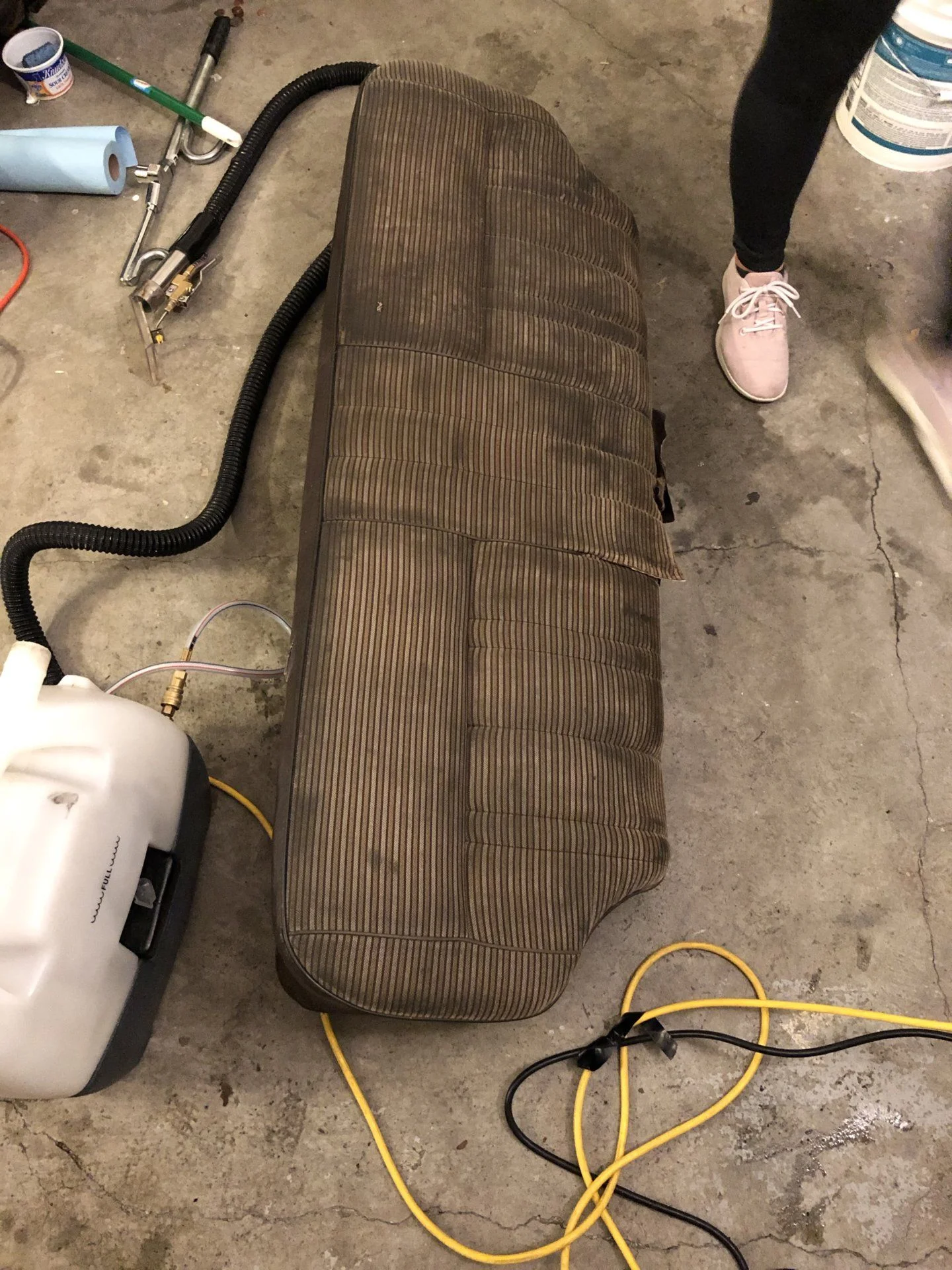

One of the things I've gotten to is taking the rear bench seats out to give them a wash. I used OxyClean and this carpet spot cleaner from Home Depot, pictures below. I'm not that happy with the results... it was an improvement, but they're still rather gross.
I'm not sure what you mean by a wet-dry shop vac, or how that compares to the carpet spot cleaner I used. I'm considering taking the seat cover off the frame to throw it in the washing machine too, but haven't done that yet (I also want to replace the foam myself at the same time).
First before, then after with the carpet spot cleaner:
Clip the hog rings off, remove the seat cover and take the wires out that are slid around the bottom perimeter - You’ll need to pull and twist on them with some pliers, but they do come out.
Hand sew up that loose seam before you put it through the laundry. Wash on cold. Run another empty cycle on the machine before you put any clothes back in!
Those are disgusting seats. I would buy new covers. Your GF is never going to feel too comfortable sitting on those nasty things, even with slip covers. Looks like a homeless person lived out of the truck for years. Strip out the inside, buy a new carpet kit from DNP (@$300), replace the seat covers....will feel like a new truck. Those couldn't smell good either.

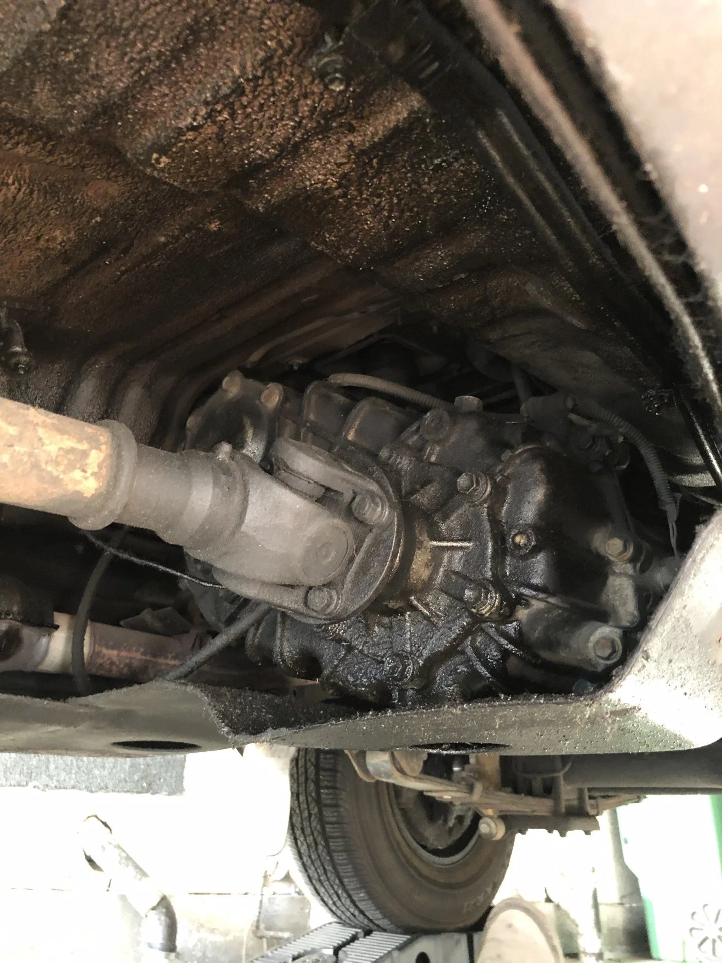

    • The transfer case or transmission is leaking like crazy... it's rather gross in there (a bit more on that in the next post, see pic to the right)

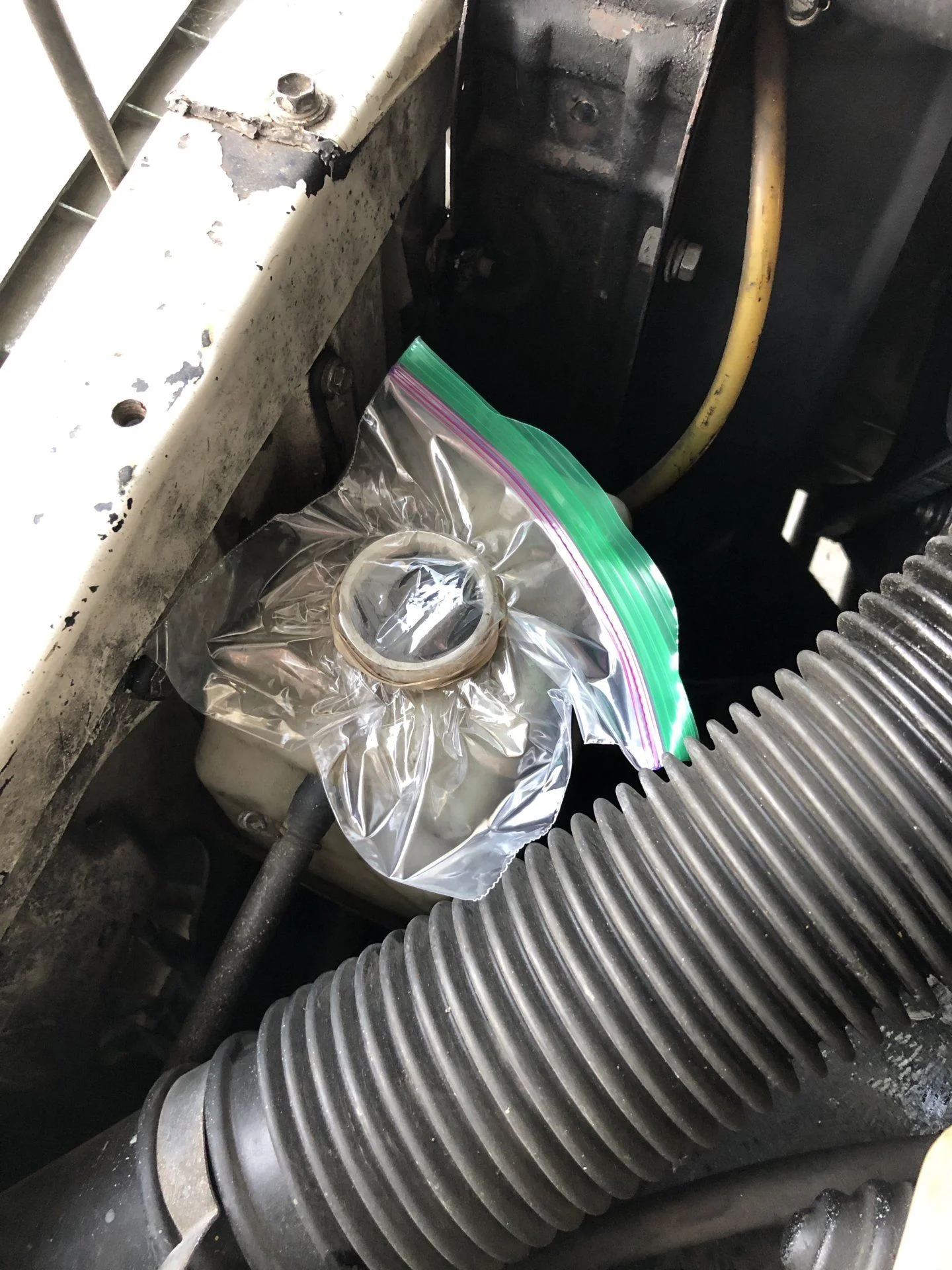

  • There's no cap on my coolant reservoir tank! I knew that when I bought it, so I bought an OEM replacement cap from CityRacer (OEM Coolant Overflow Hose with Cap for '78 to '87 Land Cruiser FJ40 and FJ60), only to find out... it's an aftermarket tank with the hoses integrated into the tank, not the cap. Ordered a new aftermarket tank from CruiserCorps (almost the same price as an OEM replacement cap) to swap in at some point when I can do the coolant flush.
    (Large Coolant Overflow Bottle / Tank with Bracket FJ40, FJ45, FJ55, Fj60, FJ62, FJ80, FJ Cruiser, BJ 1958-2009)
    • Solution in the meantime... is not ideal at all (see pic to the right)

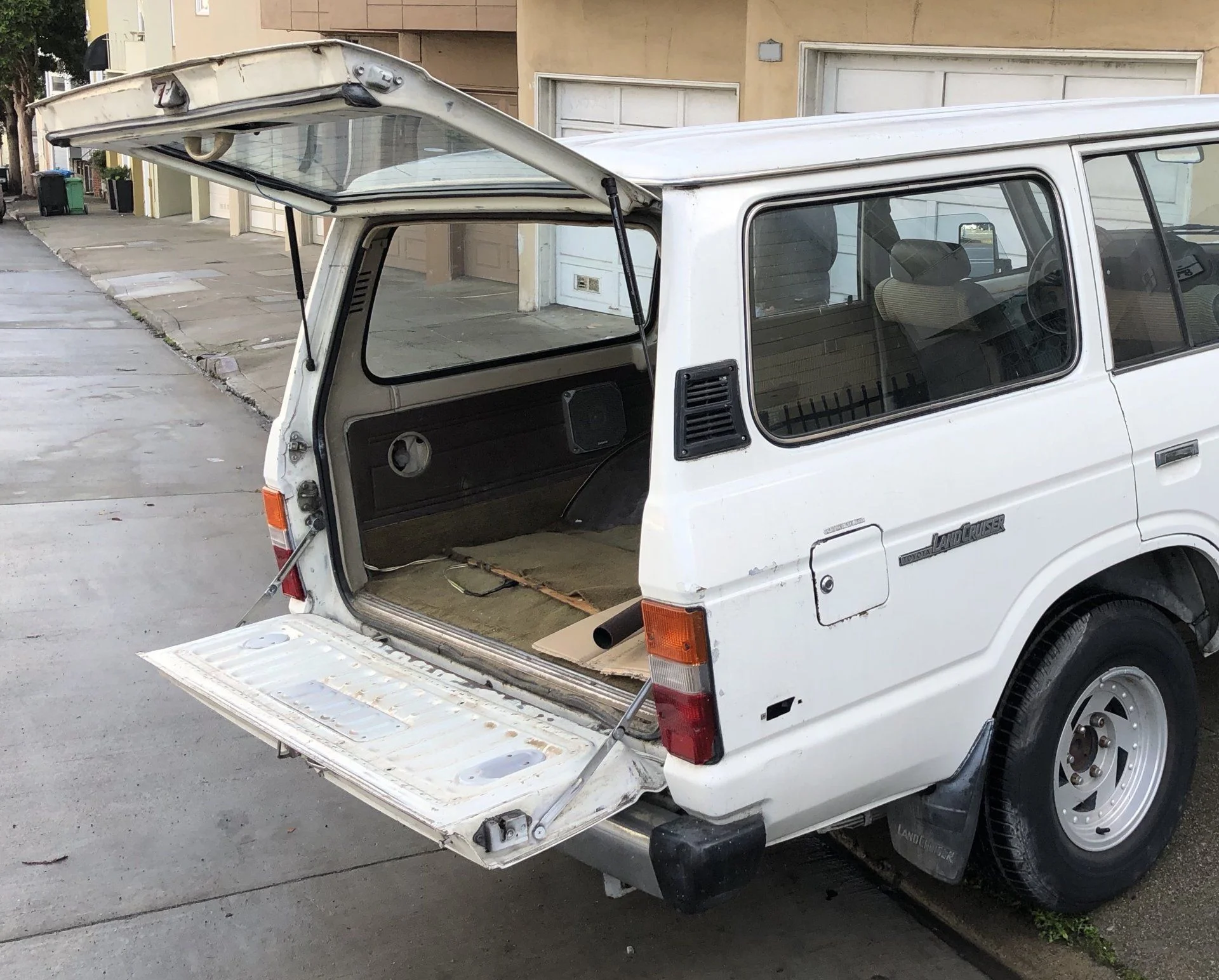

  • Replaced gas shocks on the back tailgate with the Tuff Support aftermarket ones off Amazon (Amazon links don't seem to play nice here).
  • The tailgate wouldn't open, and I couldn't tell why (unlocking/locking it made a solid noise, and so did playing with
    the handle, but nothing would happen). I took the carpet and access panels off the interior, spent 20 minutes looking around inside the tailgate, and things seemed to be moving ok - but somehow the rod pushing the tailgate latch was not being moved enough to actually allow the tailgate to fall. I played around with that rod with my hand while playing with the handle... and then suddenly the tailgate dropped! Since that, it has reliably unlocked and locked and worked properly. Not sure what the issue really was, but going to keep an eye on it [pic of success]. Also gave it the lithium grease treatment.
    • Combined with the gas shocks, the rear now opens nice and wide, ready for camping 😁

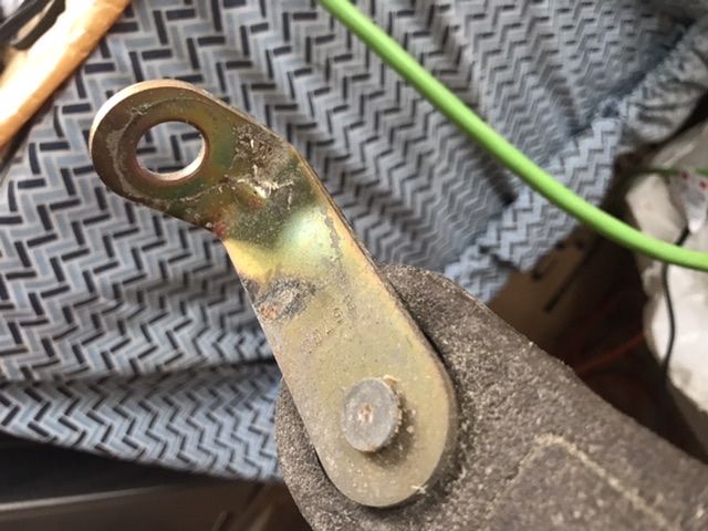

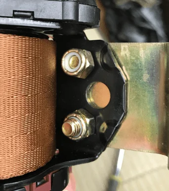

  • Tried taking apart the front passenger's seatbelt retractor to see what was wrong (the front passenger has really week retracting force, the driver's no force at all). Accidentally opened the white plastic case with all the springs... so just went ahead and ordered new front belts off SeatBeltPlanet. [link here]

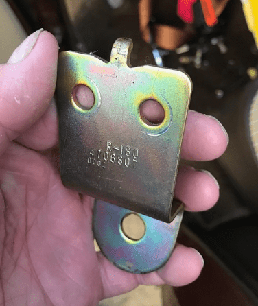

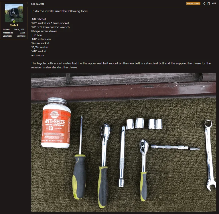

    • Does anyone have an install guide for the SeatBeltPlanet front belts? I'm not sure what to do with them, starting with how to remove the short parts of the belt in the middle of the car (the female ends).
    • I'll re-do the rear ones as well, but first want to investigate the three-point shoulder belt location on the C-pillar and see if mine is threaded or not.

When I get home I’ll drop some photos of installing the new front belts in my 84. It’s all pretty straight forward. Do one side at a time so you can use the other for reference if you forget something. The only trick is that you have to use the old mounting bracket and bend a tab as I recall. Simple though.

  • Transmission and transfer case leaking oil (see picture in my previous post)

  • Is there good documentation for the SeatPlanet seat belt install? The FSM doesn't really detail the seat belt assembly install/removal instructions, just the parts.
Thanks Seth, I'd really appreciate it ☺️
Here’s my thread. First page goes over seatbelts.
The first and second page on the link I show the steps I did to swap the front belts. you will need to remove the sill plates in both the front and back doors so that you can peel back the body trim from the door opening and then carefully pull out the plastic B pillar trim. Once that trim you can see the reel mount bolts. The floor mount and B pillar mount bolts are also straight forward. The only thing I had to do was use the old mount bracket from the original reel to mount the new reel:
The only modification you have to do is either cut off that little nub on the top...or like i did straighten it out like this:
I also replaced the mounting bolts with shorter ones:
And the tools I used for the job. I used the copper anti-seize for the bolts that thread into the body in the floor and B pillar...but definitely for the floor as those are exposed to the elements under the truck.
I had nasty seat covers as well (not as bad as yours, but stained and smelled musty and gross.) I removed the covers, stitched up a blown seam and bent new rods.
I sprayed the covers with Shout and let it sit. Then I threw them in the wash with some oxi-clean. They came out looking and smelling like new. It also allowed me to treat rust on the seat frame. It was a bit of work (ih8hog rings) but the result was awesome.

Leaking oil from the areas you mentioned can wait. Just keep checking the dip stick and topping it off. Look at what is pooling on the ground. If were talking teaspoon or tablespoons... just put it off. If it looks like quarts leaking on the ground like several sq ft of oil...then it becomes a priority.
The side plate is relatively easy, next easiest is the oil pan. Harder still the front timing gear seal and most hardest...the rear main seal because you have to pull the transmission. But none of the leaking oil is hurting anything but the asphalt as long as you keep the oil topped off.

@kenavt i wasn’t sure what you meant. But I happen to have my old belt in hand. You don’t touch the rivet. Just unbolt the whole thing and use the new parts. The new belt comes with new bolts and brackets that mount to the floor where the old one mounted.
OH this makes so much more sense! Thanks Seth.
After struggling with it for a while including buying a Torx bit for my socket... does anyone happen to have extras of the reel mount brackets on the B-pillar? Happy to pay + shipping. If no one sees this thread then I'll buy an impact driver, that probably won't work, and then I'll start hitting up pick-n-pulls.

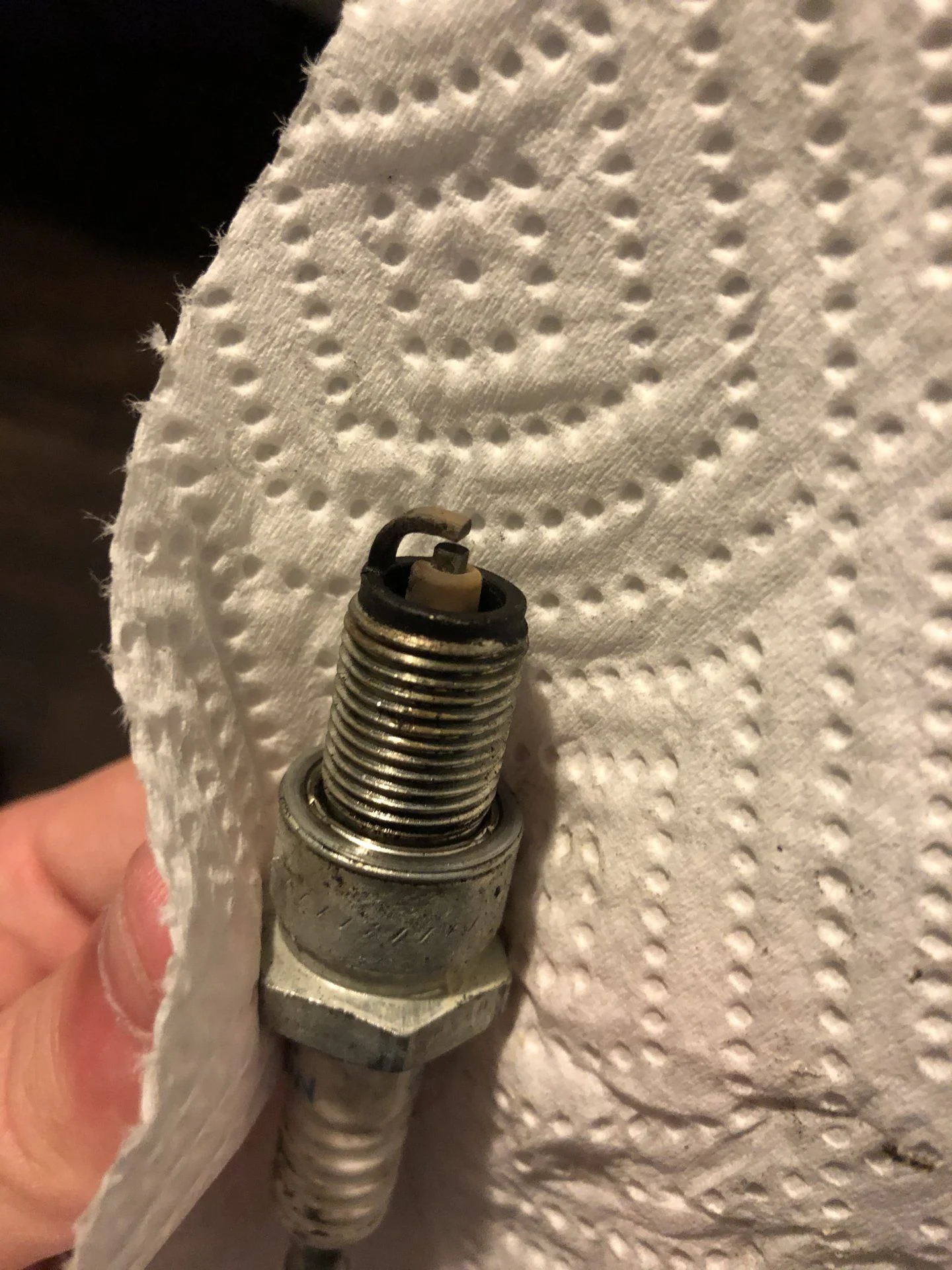

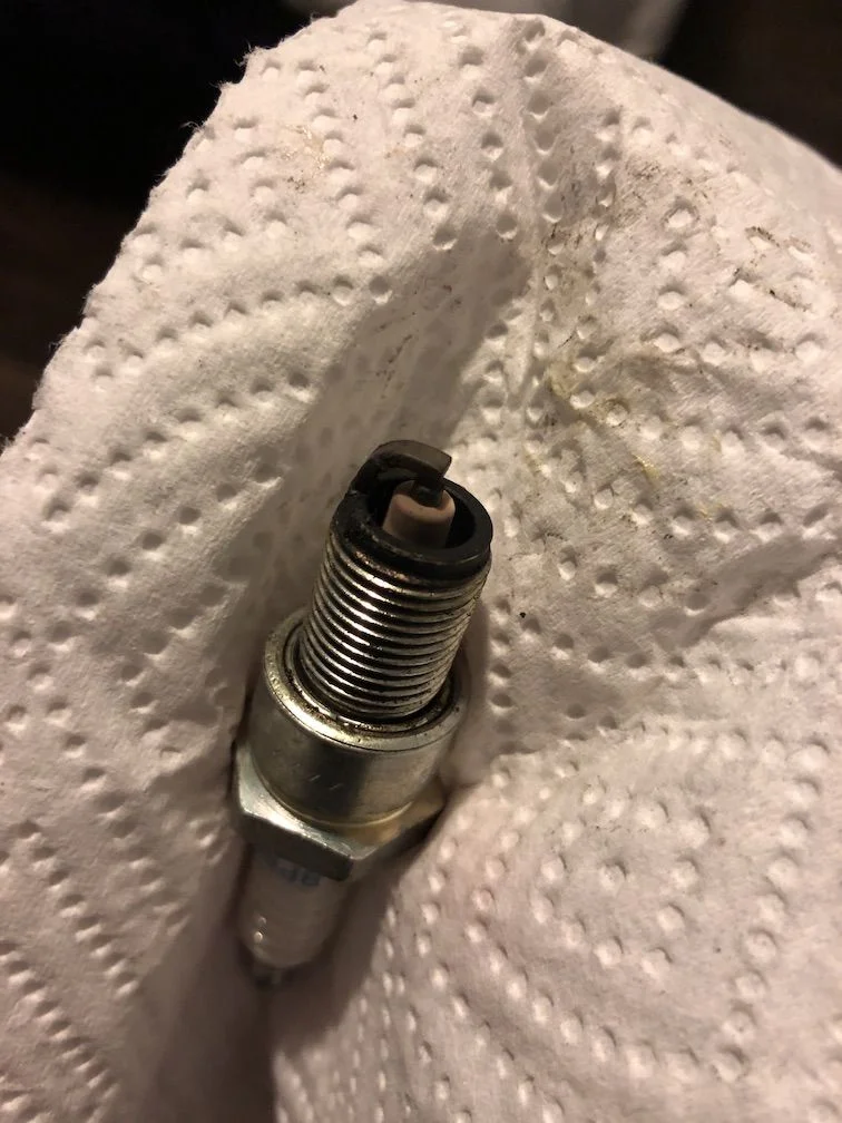

- Based on the advice from @g-man and just thinking about it, swapped in new spark plugs to look at the old ones. I have no idea how many miles are on them but they don't look pretty; looks like a lot of carbon buildup on most of them. And most of them had wet threads when I pulled them out (pics are from a few weeks since they were pulled, so they've become a little bit more dry). So I'm assuming I'm burning at least a little bit of oil. Worst offenders are below, a bit of variance among the set (pics attached at the bottom of the post)
