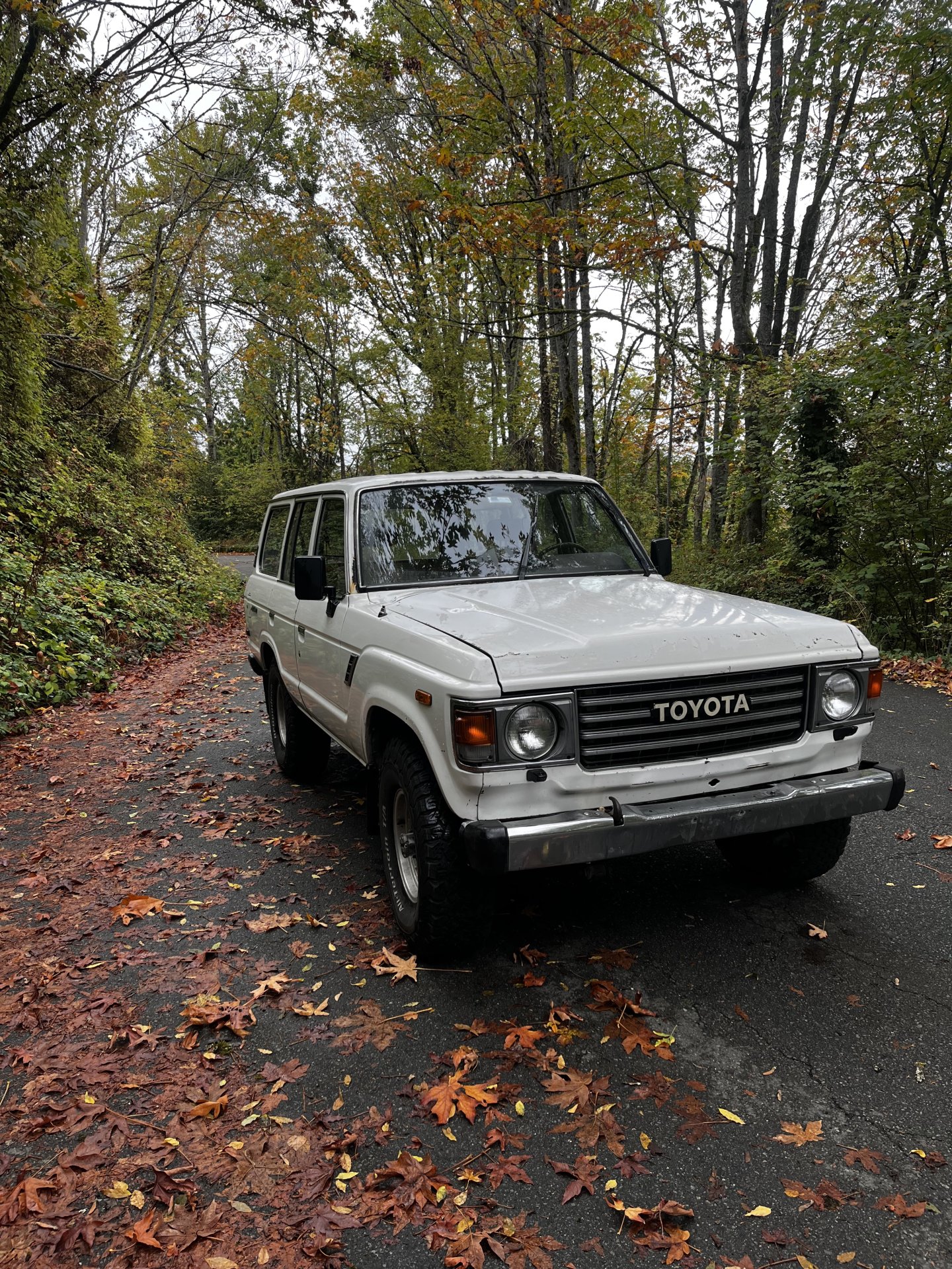

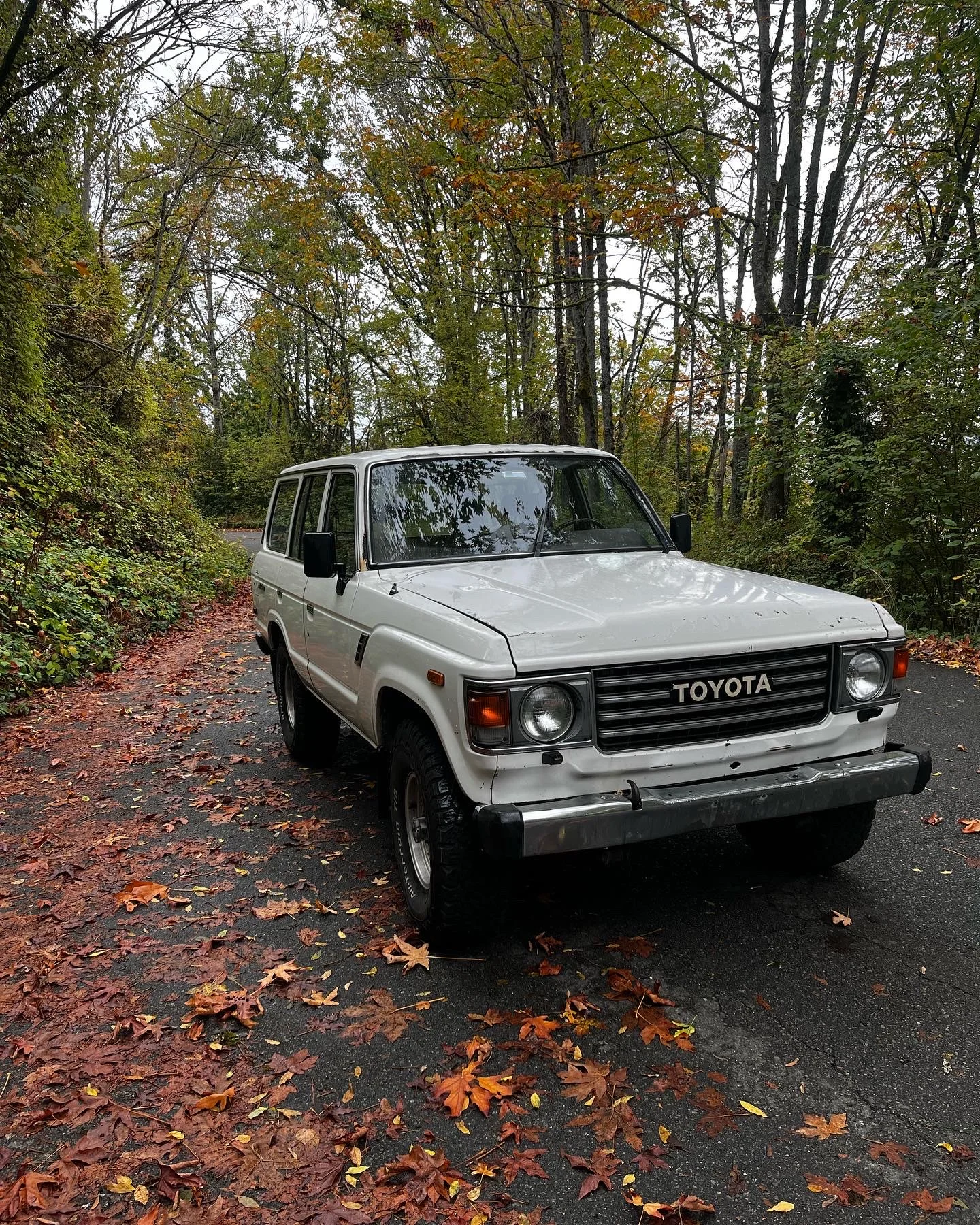

Hey folks, sadly I've listed Cara for sale. I just don't have the room or space for her anymore, and Yoshi my HDJ81 is living up to what I need right now from a Cruiser.
If you're interested in this fantastic FJ60, take a look below! Would be a great candidate for some bodywork fixing to be a gorgeous garage queen (thanks to mileage), or for a LS swap and suspension but everything else is sorted, or just driving around and enjoying it.
